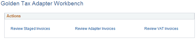

This example illustrates the fields and controls on the Golden Tax Adapter Workbench page. You can find definitions for the fields and controls later on this page.
Golden Tax Adapter Workbench Page
Click the specific workbench action to display a set of selection criteria. You can retrieve the transactions based on the inputs on the search page.
Field or Control Description
Review Staged Invoices
Click this link to display the search criteria for reviewing Staged Invoices.
Review Adapter Invoices
Click this link to display the search criteria for reviewing Staged Adapter Invoices.
Review VAT Invoices
Click this link to display the search criteria for reviewing VAT Invoices.

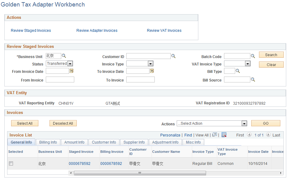

This example illustrates the fields and controls on the Review Staged Invoices. You can find definitions for the fields and controls later on this page.
Review Staged Invoices Page

Business Unit
Enter the business unit for the staged invoice to be retrieved.
Customer ID
Enter the customer ID for the staged invoice to be retrieved.
Status
Select the status for the invoices to be retrieved. The available options are: Generated, Transferred, Ready, Error, Cancelled, Rejected, Ignored, and <Blank>.
Invoice Type
Select the Invoice type for the invoices to be retrieved. The available options are: Credit Bill, Adjustment Only Bill, Rebill Bill, Regular Bill with Adjustments, Regular Bill, and <Blank>.
From Invoice Date and To Invoice Date
Enter the date range for the invoices to be retrieved. Ensure that the From Invoice Date is less or equal to the To Invoice Date.
Actions
Select the invoice action to be performed on the staged invoices. The available options are Cancel Invoices, Mass Update, Set Invoice to ‘Ready’, and Reset Invoices to ‘Transferred’.
The Actions field is displayed only when the Invoice Status is Transferred, Ready or Error.
Invoice Amount in CNY and VAT Amount in CNY
Displays the Invoice Amount/ Total VAT amount if the Transaction Currency = ‘CNY’. If Base Currency is ‘CNY’, the Invoice Amount/ Total VAT amount is set to Invoice Amount/ Total VAT amount in base currency.

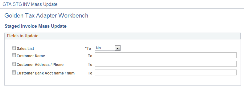

Use the Mass update page to perform a mass update for invoices on the given list of fields. The Staged Invoice Mass Update page is displayed when you select the invoice and the Mass Update option in the Actions field.
This example illustrates the fields and controls on the Staged Invoice Mass Update page.
Staged Invoice Mass Update Page

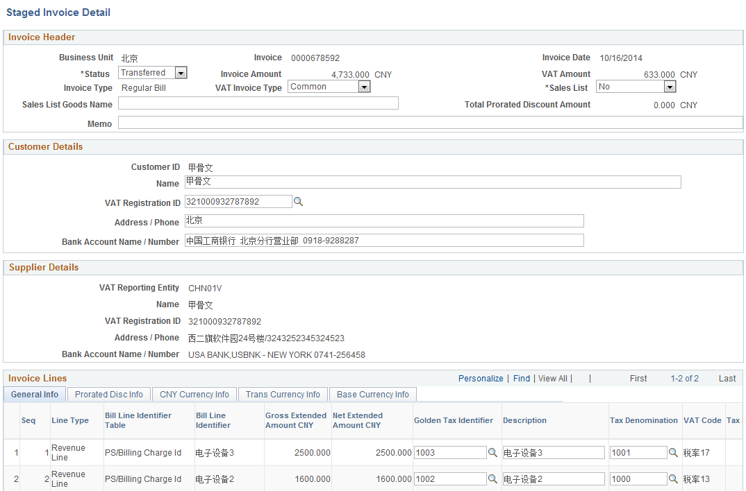

Staged Invoice ID and Billing Invoice ID appear as hyperlinks on the Review Staged Invoices page. Click the Staged Invoice ID link to display the Staged Invoice Detail page where you can review the required invoice information.
The fields can be edited based on the invoice status. Click the Billing Invoice ID to review the Billing invoice.
This example illustrates the fields and controls on the Staged Invoice Detail page. You can find definitions for the fields and controls later on this page.
Staged Invoice Details page - GT workbench
VAT Invoice Type
Select the VAT Invoice type. The available options are Common and Special.
Sales List
Select to indicate whether the invoice must be a Sales List invoice.
Golden Tax Identifier
Select the Golden Tax Identifier. The field is available for editing only if the invoice status is Transferred, Error or Cancelled.

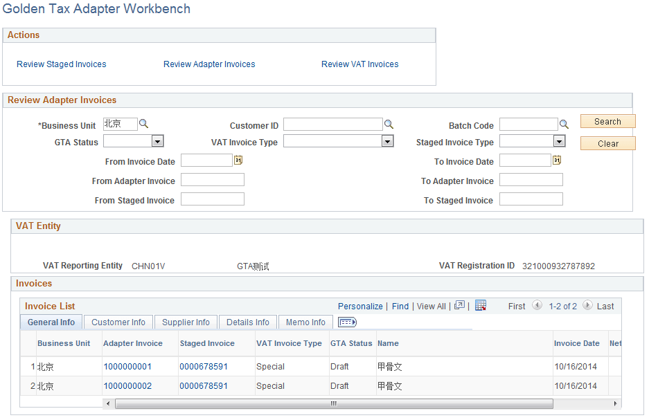

Use the Review Adapter Invoices page to review and update the required invoice information. Click the Review Adapter Invoices link on the GTA workbench.
This example illustrates the fields and controls on the Review Adapter Invoices page. You can find definitions for the fields and controls later on this page.
Review Adapter Invoices Page
Batch Code
Enter the batch code for the adapter invoices to be retrieved.
GTA Status
Select the status of the Golden Tax Adapter. The available options are Cancelled, Draft, Error, Exported, GT Cancel, Imported and Ready.
Staged Invoice Type
From Adapter Invoice and To Adapter Invoice
Enter the adapter invoice ID range for the invoices to be retrieved. Ensure that the From Adapter Invoice is less or equal to the To Adapter Invoice.
From Staged Invoice and To Staged Invoice
Enter the staged invoice ID range for the invoices to be retrieved. Ensure that the From Staged Invoice is less or equal to the To Staged Invoice.
Actions
Select the invoice action to be performed on the adapter invoices. The available options are Cancel Invoices, Mass Update, Set Invoice to ‘Ready’, and Reset Invoices to ‘Draft’.
The Actions field is displayed only when the Invoice Status is Draft, Ready or Error.

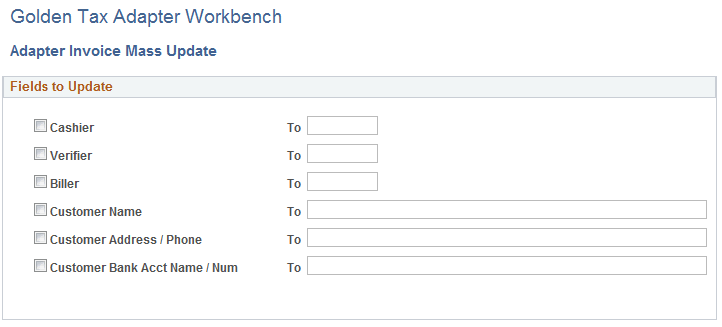

Use the Mass update page to perform a mass update for invoices on the given list of fields. The Adapter Invoice Mass Update page is displayed when you select the invoice and the Mass Update option in the Actions field.
This example illustrates the fields and controls on the Adapter Invoice Mass Update page.
Adapter Invoice Mass Update Page

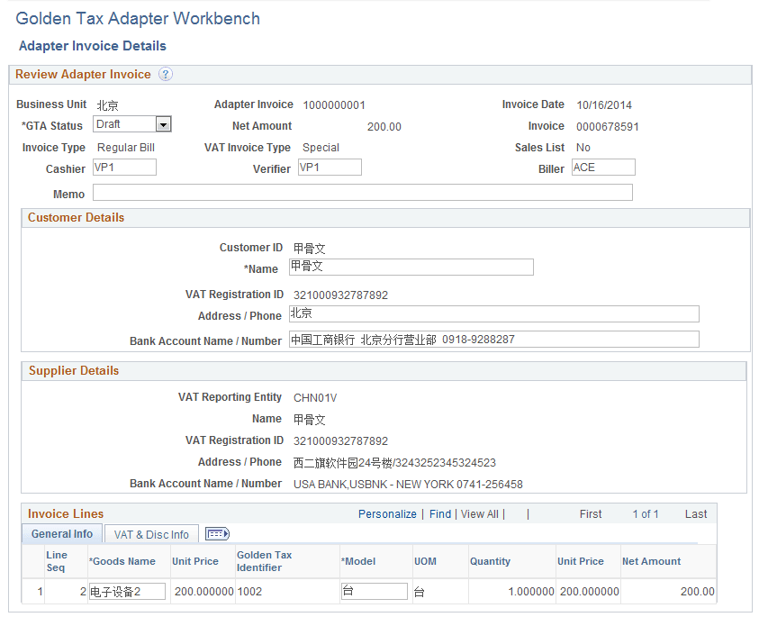

Adapter Invoice ID and Staged Invoice ID appear as hyperlinks on the Review Adapter Invoices page. Click the Adapter Invoice ID link to display the Adapter Invoice Detail page where you can review the required invoice information. The page displays information for each selected adapter invoice header and all the invoice lines for that invoice header. The fields can be edited based on the invoice status. Click the Staged Invoice ID link to review the invoice. See Review Staged Invoices Page.

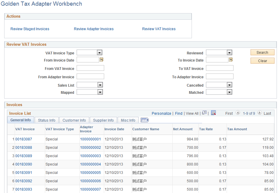

Use the Review VAT Invoices page to review and update the required VAT invoice information. Click the Review VAT Invoices link on the GTA workbench.
This example illustrates the fields and controls on the Review VAT Invoices page. You can find definitions for the fields and controls later on this page.
Review VAT Invoices Page
Reviewed
Select to indicate if the VAT invoice to be retrieved has been reviewed for discrepancies.
Cancelled
Select to indicate if the VAT invoice to be retrieved has been cancelled.
Mapped
Select to indicate if the VAT invoice to be retrieved has been mapped to an adapter invoice.
Matched
Select to indicate if the VAT invoice to be retrieved has data that matches the data on the mapped Adapter Invoice.

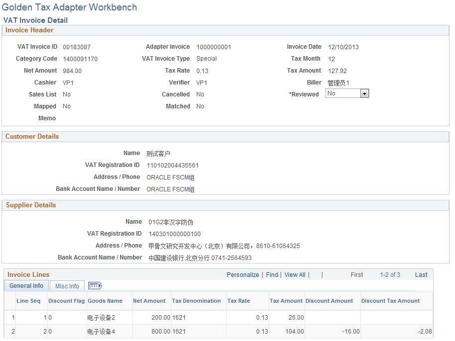

VAT Invoice ID and Adapter Invoice ID appear as hyperlinks on the Review VAT Invoices page. Click the VAT Invoice ID link to display the VAT Invoice Detail page where you can review the required VAT invoice information. All fields except the Reviewed field are display-only. Click the Adapter Invoice ID link to review the adapter invoice details. See Review Adapter Invoices.
This example illustrates the fields and controls on the VAT Invoice Detail page. You can find definitions for the fields and controls later on this page.
VAT Invoice Detail Page
Reviewed
Select to indicate if the VAT invoice has been reviewed for discrepancies.
