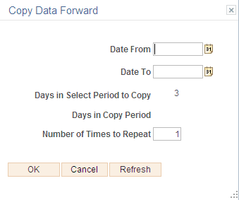

Use the Copy button to copy data forward. This example shows the Copy Data Forward fields:
This example illustrates the fields and controls on the Copy Data Forward page.

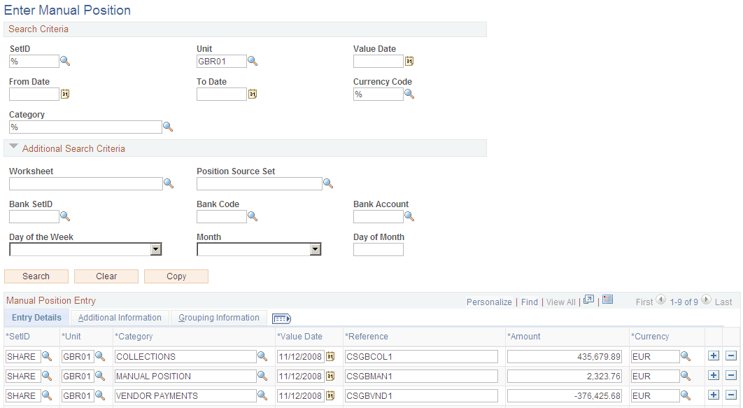

Enter Manual Position Page
Use the Enter Manual Position page (MANUAL_POSN_ENTRY) to capture data that can then be added to a cash position or associated with a specific worksheet.
Navigation:
Cash Management, and then Cash Forecast, and then Process and Review, and then Enter Manual Position, and then Enter Manual Position
This example illustrates the fields and controls on the Enter Manual Position page. You can find definitions for the fields and controls later on this page.
Field or Control Description
Search
Click this button to search existing position data.
Clear
Click this button to start a new search.
Copy
Click this button to specify parameters for copying forward rows of position entry information.
Search Criteria
Enter search criteria, as your business needs require, for retrieving data.
SetID
Enter a SetID.
Unit
Enter a business unit.
Value Date
Enter a payment value date.
From Date and To Date
Enter a date range, including a starting date and an ending date.
Currency Code
Enter a currency code.
Category
Enter a category for grouping position source data that you defined as a worksheet line item.
Additional Search Criteria
Enter additional criteria, as your business needs require, for retrieving data.
Worksheet
Enter a Worksheet associated with the SetID.
Position Source Set
Enter a Position Source Set associated with the Worksheet.
Bank SetID
Enter a SetID to identify bank information.
Bank Code
Enter a Bank Code associated with the Bank SetID.
Bank Account
Enter a Bank Account associated with the Bank Code.
Day of the Week
Enter a calendar day.
Month
Enter a calendar month.
Day of Month
Manual Position Entry Grids
Search results for the criteria you specified appear in the grids. You can manually add or delete rows or edit data that appear in the fields.
SetID
Enter a SetID.
Unit
Category
Value Date
Reference
Enter reference that will be used when reference is mapped on the Position Source Mappings grid on the Position Source page.
Amount
Enter the amount that should be used by the Cash Forecast Calculations Application Engine (TR_CSH_FCST) process to calculate cash forecast amounts.
Currency
Note: All lines that are added to the Manual Position Entry grid must be of a currency for which an exchange rate is established; otherwise, the lines will not be included in the generation of the worksheet. Exchange rates are set on the Market Rates page.

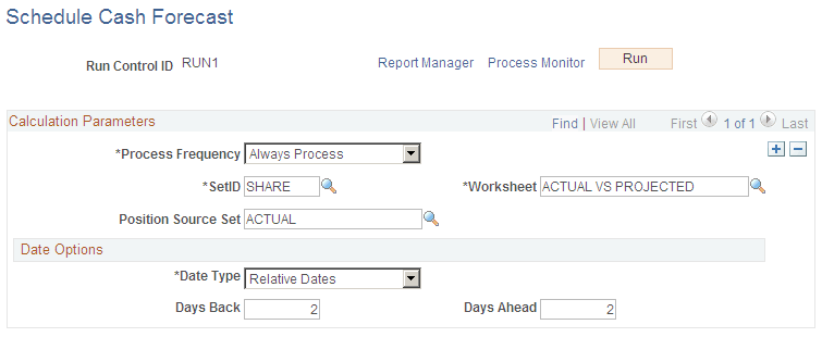

Schedule Cash Forecast Page
Use the Schedule Cash Forecast page (CSH_FCST_REQ) to run the Cash Forecast Calculations Application Engine (TR_CSH_FCST) process.
Navigation:
Cash Management, and then Cash Forecast, and then Process and Review, and then Schedule Cash Forecast, and then Schedule Cash Forecast
This example illustrates the fields and controls on the Schedule Cash Forecast page. You can find definitions for the fields and controls later on this page.
Calculation Parameters
Process Frequency
Specify the frequency with which the process or job is to be run. Choose from Always, Once, or Never.
SetID
Enter a SetID.
Worksheet
Enter the worksheet definition for which you would like to calculate the cash forecast (Worksheet Definition page).
Position Source Set
Enter a position source set that is delivered with your system or one that you defined on the Position Source Set page.
Date Options
Date Type
Choose from these options:
  • Specific Dates - When you select this option, enter values in the From Date and To Date fields.
  • Relative Dates - When you select this option, enter values in the Days Back and Days Ahead fields.
