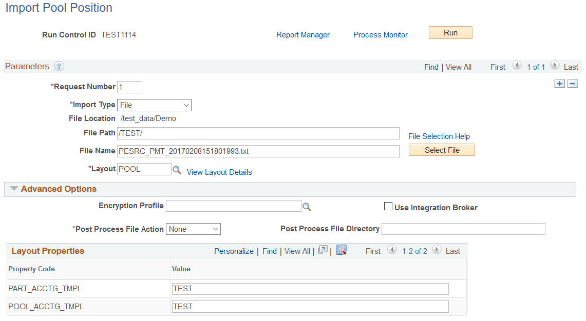

Import Pool Position Page
Use the Import Pool Position page (BSP_IMPORT) to update an investment pool's position by importing data in a flat file format from an outside investment source.
Navigation:
Cash Management, and then Investment Pools, and then Import Pool Position
This example illustrates the fields and controls on the Import Pool Position page. You can find definitions for the fields and controls later on this page.

Parameters
Field or Control Description
Import Type
Select the method for importing the data file. The options are:
  • FTP: Select if you are importing the file by using file transfer protocol, and enter a bank node through which to transfer the data.
  • File: Select if you are importing a file, and complete the File Path and File Name fields.
  • HTTP: Select if you are importing a file using a URL that is included as part of the node configuration. No file path or file name is required.
File Location
Appears when using the File import type only. Displays the file location entered on the configuration page by a bank integration administrator. Users have access only to the folders below the base path displayed in the File Location field.
For more information, see PeopleSoft Banks Setup and Processing: Managing Import File Locations.
Integration Node
Enter the node to use to transfer the data. This field appears only if FTP or HTTP is selected as the import type.
See PeopleSoft Financial Gateway: Setting Up PeopleSoft Integration Broker for Bank Statements, Payments, and Payment Acknowledgements.
See "Using Listening Connectors and Target Connectors," Working with AS2 Connectors; and "Configuring Nodes and Transactions" in PeopleTools: Integration Broker.
View Integration Node Details
Click to access the Node Details page and review property details of the selected node. This link appears only if FTP or HTTP is selected as the import type.
File Path
Enter a file path according to the import type selected:
  • File Import Type: Leave this field blank to select a file in the base path shown in the File Location field, or enter a folder name with trailing backslash below the base path, for example, /Bank02/.
    Wildcard characters are not supported when using the File import type.
  • FTP Import Type: Enter the complete file path location. To select files by using the Select File button, you must include a trailing backslash (\) in the file path.
    You can you can also load all files in a given directory by using the *.* notation or search for files of a specific type by entering an asterisk and the extension suffix. For example, to search all files with an .xxx suffix, enter \*.xxx.
  • HTTP Import Type: Does not require a file path and the field is unavailable.
Note:Be sure that the application server and the Process Scheduler have access to the directory, FTP node, or HTTP node where the files are staged for import.
File Selection Help
Click to view help information on specifying file paths and file names.
File Name
Select the specific file to import. If you want to import multiple files based on extension for the FTP import type, leave this field blank.
Advanced Options
Encryption Profile
Select an encryption profile to decrypt the data file. Encryption profiles contain both encryption and decryption information.
Use Integration Broker
Select this check box to format the files and publish the formatted document to PeopleSoft Integration Broker. Integration Broker then processes the formatted file accordingly.
You select this option if you want to use the pool position information as a trigger for Integration Broker to perform other processes, or to integrate with other systems.
Post Process File Action
Select what action, if any, to be performed on the pool position data file after the data has been processed. The options are:
  • Copy: Copy the file to the directory entered in the Post Process File Directory field.
  • Delete: Delete the file after the data in it is processed.
  • Move: Move the file to the directory entered in the Post Process File Directory field.
  • None: Take no action. The data file remains unprocessed.
Enter a file path to the directory to which the file will be moved or copied if either option is selected as the Post Process File Action.
See also PeopleTools: Integration Broker, Configuring Nodes and Transactions.

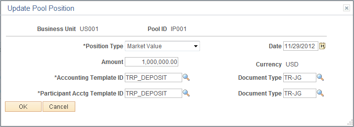

Update Pool Position Page
Use the Update Pool Position page (TRP_POOL_POS_ADD) to manually update the pool's cash position with current values obtained from outside investment sources.
This example illustrates the fields and controls on the Update Pool Position page. You can find definitions for the fields and controls later on this page.
Obtaining the updated pool data may require running the Import Pool Position process.
Position Type
Select the type of position being updated. The options are:
  • Market Value: Update the current value of the investment pool based on the last reported sale price of securities to which the pool funds are invested.
  • Interest: Updated the interests accrued on the pool's investments.
Amount
Enter the new market value of the investment pool.
Accounting Template ID
Select the accounting template for the pool that depicts the correct accounting and debit and credit configuration for this update transaction.
Document Type
Select the document type that the system uses to assign document sequence numbers.
Participant Acctg Template ID
Select the accounting template for the participants account that depicts the correct accounting and debit and credit configuration for this update transaction.
