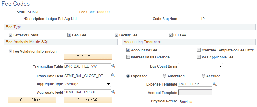

Fee Codes Page
Use the Fee Codes page (FA_FEE_CD_PNL) to set up fee codes.
Navigation:
Set Up Financials/Supply Chain, and then Product Related, and then Treasury, and then Fee Codes, and then Fee Codes
This example illustrates the fields and controls on the Fee Codes page. You can find definitions for the fields and controls later on this page.
Fee Codes page
Field or Control Description
Description
Create both a description and fee code and that matches the TMA TS 822 or that matches your financial counterparty account analysis standards.
Code Seq Num (code sequence number)
Assign a fee code to determine the order in which the fee codes appear on your account analysis screens.
Fee Type
Specify whether this fee type applies to transactions involving a Letter of Credit, Deal Fee, Facility Fee, or EFT Fee. You can select multiple options.
Fee Analysis Metric SQL
Define how the fee metrics will be tracked in your system.
Fee Validation Information
If the fee can be tracked in your system, select the check box. In certain circumstances, you may not want to validate all fees. In this case, leave the check box deselect.
Transaction Table
Reference the fee validation information to a fee transaction table (defined in the prior section). After you save this value, click the Transaction Tables button to view the specific table definition.
Transaction Date Field
Select the date type field name used to determine the fee (for example, ACCOUNTING_DT = accounting date).
Aggregate Type
Select Count, Avg (average), Min (minimum), Max (maximum), or Sum. The available aggregate fields to which the aggregate parameters can be applied are prompted for you from the selected transaction table.
After selecting the Aggregate Field, click the Where Clause button to select operators and describe the value that the Aggregate Field must match.
Accounting Treatment
Define how the accounting process handles bank fees.
Account for Fee
Select this check box if a fee may be expensed, amortized, or accrued. If a fee is amortized, accounting templates for booking the fee and amortization of the fee are required. If a fee is expensed, it may not be amortized or accrued and only the template for booking the expense is required. If a fee is accrued, accounting templates for booking the expense and recording the accrual amount for this fee entry are required.
Interest Basis Override
Fees may be amortized or accrued on various day count basis. Select this check box to enable modification of the Day Count Basis type on the Enter Fees page when creating a fee. If not selected, the Day Count Basis type on the Enter Fees page automatically defaults to the fee set up information, and cannot be modified.
Override Template on Fee Panel
Select this check box to allow editing of the Template field on the Enter Fees page.
VAT Applicable Fee
If this fee code is VAT applicable, select the check box, and specify the appropriate Expense Template. All VAT transactions recorded in Treasury Management are assumed to be transactions on services, not transactions on goods. When you create a VAT-applicable fee, the Physical Nature field displays Services.
Day Count Basis
Select from the following:
  • 30/360: Assumes that a year consists of 12 months with an equal length of 30 days. A special rule applies when dealing with the end of a month.
  • 30E/360: Assumes that a year consists of 12 months with an equal length of 30 days. Also known as Euro 30/360.
    Note: The difference between the 30/360 calculation and the 30E/360 calculation occurs when a period ends on the 31st, but did not start on the 30th or 31st. In this case, the 30/360 calculation uses the 31st day as equal to 31, while the 30E/360 calculation uses the 31st day as equal to 30. For example, using the 30/360 calculation, the period starting December 1 and ending December 31 contains 30 days. However, using the 30E/360 calculation, the same December time period contains only 29 days.
  • Actual/360: Assumes that a year consists of 360 days but the months are counted as actual calendar days.
  • Actual/365: Assumes that a year consists of 365 days but the months are counted as actual calendar days.
  • Actual/Actual: Assumes that the number of days between two dates is the actual number of calendar days.
Amortized
If you opt to amortize the fee over time, select both an Expense Template and Accrual Template.
Expensed
If you opt to only expense the fee, select an appropriate expense template value.
Accrued
If you opt to accrue the fee over time, select both an Expense Template and an Accrual Template.

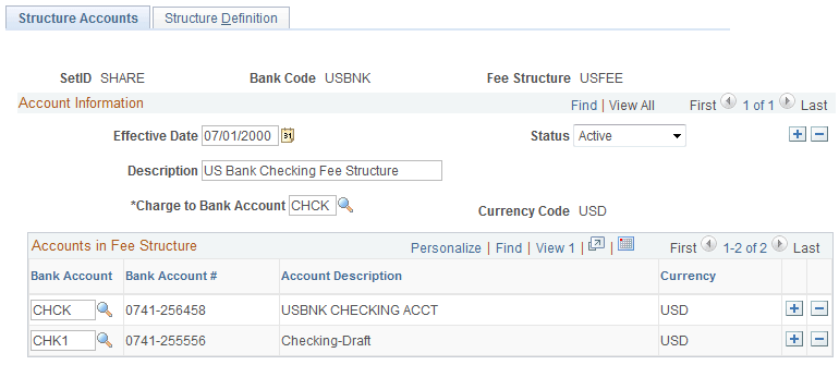

Fee Structures - Structure Accounts Page
Use the Fee Structures - Structure Accounts page (FA_FEE_ACCT) to set up fee structures.
Navigation:
Banking, and then Account Analysis, and then Fee Structures, and then Structure Accounts
This example illustrates the fields and controls on the Fee Structures - Structure Accounts page. You can find definitions for the fields and controls later on this page.
There two components to a fee structure:
  • Account information. Each structure is defined according to the bank and the account to which the fee structure will be charged.
  • Accounts in the fee structure, and their associated currency.
Fee Structure Accounts
Charge to Bank Account
Select a bank account to record any fees charged to this fee structure.
Accounts in Fee Structure
Enter the bank account or accounts that are associated with a particular fee structure.
IBAN
Displays the international bank account number (IBAN) in addition to the local, domestic bank account number, when the country has been set up to display the IBAN on the PeopleSoft Banks Setup and Processing: IBAN Formats Page.

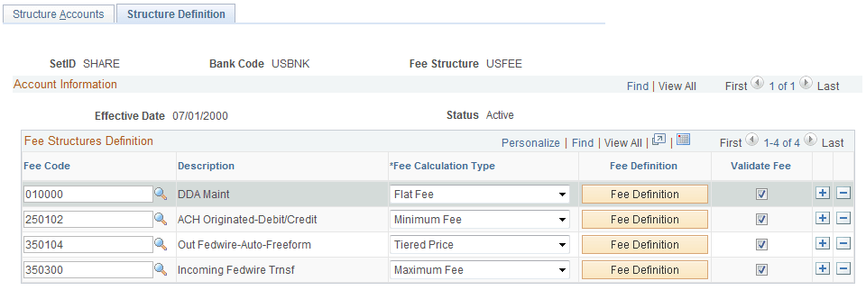

Fee Structures - Structure Definition Page
Use the Fee Structures - Structure Definition page (FA_FEE_STRUCT) to define fee structures.
Navigation:
Select the Structure Definition tab on the Structure Accounts page.
Access the Fee Structures - Structure Definition page (Banking, Account Analysis, Fee Structures, Structure Definition).
This example illustrates the fields and controls on the Fee Structures - Structure Definition page. You can find definitions for the fields and controls later on this page.
Fee Calculation Type
Select one of the following values:
  • Base Fee: Fee that is charged in addition to the unit price when one or more units of the service are provided. For example, a base fee of USD 10.00 is charged, plus USD 0.50 per unit.
  • Flat Fee: Fixed fee that is charged for service provided that is not directly tied to the volume of the service. For example, Balance Reporting is USD 50.00 per month, regardless of the number or reporting files created during the month.
  • Minimum Fee: Lowest fee that is possible for the service provided; for example, USD 1.00 per unit with a USD 5.00 minimum. The minimum fee is charged even if the unit count is less than 5.
  • Maximum Fee: Highest fee that is possible for the service provided; for example, USD 1.00 per unit, with a USD 50.00 maximum. The maximum fee is charged even if the unit count exceeds 50.
  • Rate Based Charge: This fee is calculated using a balance and an annual percentage rate. For example, an overdraft fee is calculated as the Average Negative Ledger Balance x 12% x 30/365.
  • Discounted Price: This fee is calculated using a price that is less than the standard price for the service provided. For example, Customer A is charged USD 0.90 per unit, instead of the standard USD 1.00 per unit.
  • Threshold Price: The total volume determines the unit price for the service. For example, if the volume is 1,000 or less, the price is USD 0.10 per unit; if the volume is more than 1,000, the price is USD 0.09 per unit.
  • Tiered Pricing: The price for the service is determined by the tiering structure and the total volume. The volume is broken down into as many tiers as necessary, and a different price is used to calculate the fee for each tier. For example, for the first 1,000 items, the price is USD .10 per unit; for more than 1,000 items, the price is USD .09 per unit.
Fee Definition
Click to further define the metrics of the fee on the Fee Calculation Type - Fee Structure page (FA_FEE_STRUCT_SEC), depending on the Fee Calculation Type.
Validate Fee
Select this check box to validate the particular fee code against both the cost and volume as defined in the fee structure and the volume as defined in the fee code setup and fee transaction tables.
