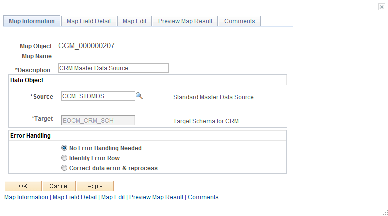

Define Catalog Map - Map Information Page
Use the Define Catalog Map - Map Information page (EOEW_MAP_DFN) to enter general mapping information.
Navigation:
Catalog Management, and then Catalog Management Home
Select an enterprise catalog.
Select a partner catalog.
Define Catalog Map, and then Map Information
This example illustrates the fields and controls on the Define Catalog Map - Map Information page. You can find definitions for the fields and controls later on this page.
Field or Control Description
Source
Select the source file for this map.
The source selected should be the name specified as the source data object when the catalog source layout was defined.
Target
Automatically populated based on the enterprise catalog selected when navigating to this page. The value cannot be overridden.
This value controls the target fields available on the Define Catalog Map - Map Field Details page.
Error Handling
Select from:
No error handling needed. Data validation is not performed and all rows are inserted into the target table.
Identify error row: Currently not available.
Correct data error & reprocess: Data validation is performed. Valid rows are inserted into the target table and invalid rows are inserted into a user-defined error table.
Note: For the Quick Item Load process, it is recommended that the Correct data error and reprocess option be selected. Error tables are created automatically if user selects the auto table creation option in the Catalog Management installation options.

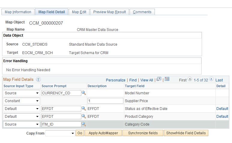

Define Catalog Map - Map Field Detail Page
Use the Define Catalog Map - Map Field Details page (EOEW_MAP_FLD) to enter field-level mapping definitions.
Navigation:
Define Catalog Map, and then Map Field Detail
This example illustrates the fields and controls on the Define Catalog Map - Map Field Detail page. You can find definitions for the fields and controls later on this page.
To define map field details, click the Apply AutoMapper button.
AutoMapper automatically attempts to match the source to target field list. It also applies any required map rules, including target field defaults, translation set values, and transformations. AutoMapper then maps remaining target fields with constant values from the PSRECFIELD.DBFIELDNAME.SQL assembler, and coordinate the transformation steps.
If modifications to the mapping defined by AutoMapper is required, make changes to these options:
Source Input Type
Select from:
Source: Select if the value is from the source file. You are prompted to select a source prompt field from the source file.
Constant: Select if the value is a constant value, then enter that value.
Default: Select to use a default value, then select a source prompt. Click the Default link to access the Set Target Field Default page.
Transformation: Select to use a transformation, then select a source prompt. Click the Transform link to view transformation definitions, or click the Add link to add a new definition using the Transformation wizard.
Translation Set: Select to use a translation set, then select a source prompt. Click the Translation link to view translation set values, or click the Add link to add a new set.
Note: If you select the Source Input Type of Source, the Source Prompt lookup will include EOCM_ACCESS_ID. Do not select as mapping is performed automatically for this field.
Source Prompt
Select a source prompt based on the source input type.
Description
Enter a description if you selected Constant as the input type.
Target Field
Lists the name of all the fields contained in the target file.
Details
Either the Transform, Default, or the Translation link appears, based on the selected input type.
Add
The Add link appears if the selected input type is either Transformation or Translation Set.

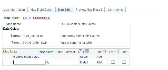

Map Edit Page
Use the Define Catalog Map - Map Edit page (EOEW_MAP_EDIT) to edit map source input values used in transformation sets.
Navigation:
This example illustrates the fields and controls on the Map Edit page.
Map Edit page
Select a new source input value to replace or add to the current source. Click the Detail link to access the Transformation Definition page and edit transformation definition information. Click the Add link to access the Transformation Definition page and add a new transformation.
