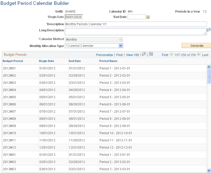

Budget Period Calendar Builder Page
Use the Budget Period Calendar Builder page (CALENDAR_BLDR_BP) to create a (detail) budget period calendar automatically.
Navigation:
Set Up Financials/Supply Chain, and then Common Definitions, and then Calendars/Schedules, and then Budget Period Calendar Builder
This example illustrates the fields and controls on the Budget Period Calendar Builder page.
To create a budget period calendar automatically:
  1. For new calendars enter a short calendar ID description.
  2. If the calendar is entirely new, not an extension of an existing calendar, enter the begin date of the first period and the end date of the final period.
    The end date is not limited to the current year or the year of the begin date.
  3. If you are creating an extension of an existing calendar, the begin date is not available for manual entry because the begin date is defaulted by the system from the end date of the existing calendar.
  4. For new calendars, select a period type for this calendar by selecting Daily, Weekly, Bi-weekly, Monthly, Bi-monthly, Quarterly, Semi-Annual, or Yearly.
    The period type (and, if the period is monthly, the monthly allocation type) determines the value that the system displays in the Periods in a Year field.
  5. For new calendars, if you selected Monthly as the calendar period type, select one of the following options as the monthly allocation type:
    Field or Control Description
    12 period Calendar
    Calendar months.
    13 period Calendar
    Four weeks each.
    445 Calendar, 454 Calendar, and 544 Calendar
    Twelve non-monthly periods, divided into four sets of three periods each, with the three periods in each set made up, respectively, of either 4, 4, and 5 weeks; 4, 5, and 4 weeks; or 5, 4, and 4 weeks.
  6. Click Generate.
    The Budget Periods grid displays a row for each period in the range that you indicated.
You cannot automatically create a multiyear budget period calendar. It must be created manually.
