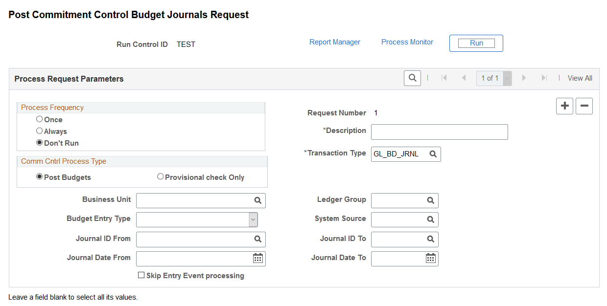

Use the Post Commitment Control Budget Journals Request page (KKBD_POST_REQ) to request a run of the Commitment Control Posting (FS_BP) application engine process for budget journals. You can also request a provisional check.
Select journals by business unit, commitment control ledger group, system source, entry type, journal ID, and journal date. The system posts only those budget journals that fit the request criteria and have no errors. A source transaction type is required to run batch posting. One value GL_BD_JRNL only is delivered and the system default to this value.

This example illustrates the fields and controls on the Post Commitment Control Budget Journals Request page. You can find definitions for the fields and controls later on this page.
Leave a field blank to select all values for processing.
Field or Control Description
Post Budgets
Select if you want to run the Commitment Control Posting (FS_BP) application engine process for budget journals.
Provisional Check Only
Select if you want to perform budget validation without committing changes to corresponding records, such as LEDGER_KK.
Transaction Type
GL_BD_JRNL is the default transaction type; do not change it. GL_BD_JRNL limits the request to the posting of budget journals for this request.
System Source
Select to limit journal selection to specific general ledger processes or specific application processes. For example, you could select only journals created by the ALO (PS/GL Allocations process).
Skip Entry Event Processing
Select to skip entry event processing when you run the commitment control posting process.
If entry events processing is enabled and required for the Commitment Control ledger group and you skip entry event processing here, run the Entry Event Processor (FS_EVENTGEN) from the Entry Event Run Request page.
