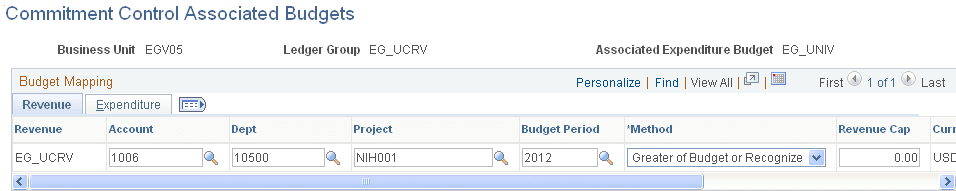

This example illustrates the fields and controls on the Commitment Control Associated Budgets page - Revenue tab. You can find definitions for the fields and controls later on this page.
Because each pair of associated revenue and expenditure budgets appears on the same line, use the expanded (as opposed to the tabbed) Budget Mapping grid to ensure that you map the proper revenue budget to the correct expenditure budget.

A column exists for each of the revenue ledger group's key ChartFields. Enter the ChartField values and budget period that designate the revenue budget that increases the available budget balance for the associated expenditure budget.
You can enter the same revenue budget more than once if you want it to increase the available budget balance for more than one expenditure budget.
Method
Select whether the revenue is to be made available for spending when it is Budgeted, Collected, or Recognized. You can also select one the following values:
  • Greater of Budget or Collected
  • Greater of Budget or Recognized
  • Lesser of Budget or Collected
  • Lesser of Budget or Recognized
Note: You can use the same revenue ChartField combination to fund multiple expenditures and the revenue method can be different for each association. The only requirement is that the sum of the revenue percentages cannot exceed 100 percent for any given revenue ChartField combination.
