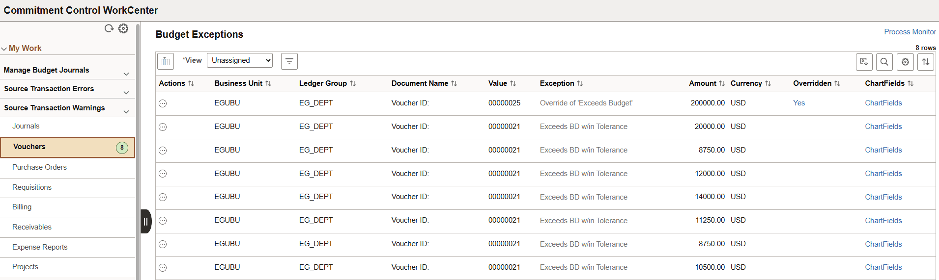

Commitment Control WorkCenter (Fluid), expand My Work and select a transaction from the Errors or Warnings section in the left-hand navigation.
This example illustrates the fields and controls on the Commitment Control WorkCenter - Source Transaction Warnings for Vouchers when using Work Management.
Commitment Control WorkCenter - Voucher Budget Exceptions (Work Management Enabled)
When Work Management is enabled for a transaction, there are two changes on the WorkCenter page:
  • The View drop-down box appears above the grid.
  • Additional action options are added to the Actions button.
    The original action options remain at the line level. The additional (Work Management) action options depend on the View option selected.
The initial actions for Budget Voucher Warnings are Go to Source Entry and Go to Transaction Exceptions. When Work Management is enabled, additional actions are available depending on the option selected in the View field: See Enterprise Components: Understanding the Work Management Framework, Actions by View section.
Work Management Example for Voucher Budget Exception Warnings
The following example explains how you might approach a long list of voucher budget exception warnings.
Upon enabling Work Management for voucher budget errors, you have a list of nine transactions.
Your first step might be to inactivate all voucher transactions that are NOT true budget errors. For example, you notice that a voucher budget error is overridden by an authorized user and is no longer an issue.
To do this:
  1. Select the Actions icon from the Unassigned view.
  2. Select Mark as Inactive.
  3. In the Exception Comments window, enter text to indicate why you are inactivating the exception, such as, Additional budget is approved by Jane Doe to allow payment of this voucher.
  4. Select Done.
    When you change the View to Inactive, you see this exception.
Now you're left with eight exceptions in the Unassigned view. There are two transactions where you want to assign the transactions to yourself for to follow up with the head of an agency. To do this:
  1. Select the Update Selected Rows icon.
  2. Select the check box for the two rows you want to assign to yourself.
  3. Select the Actions button.
  4. Select Assign to Me.
  5. In the Exception Comments window, verify the Follow Up Date, which defaults from the Work Management page.
  6. Enter a comment that describes your action, such as, Follow up with Jane Doe next week regarding multiple budget warnings.
  7. Select Done.
  8. Click OK to the verification message.
    These exceptions move to the Assigned to Me view until the follow up date is reached. When the follow up date is reached, the system moves the exception into the Unassigned view.
You now have six exceptions that appear in the Unassigned view.
