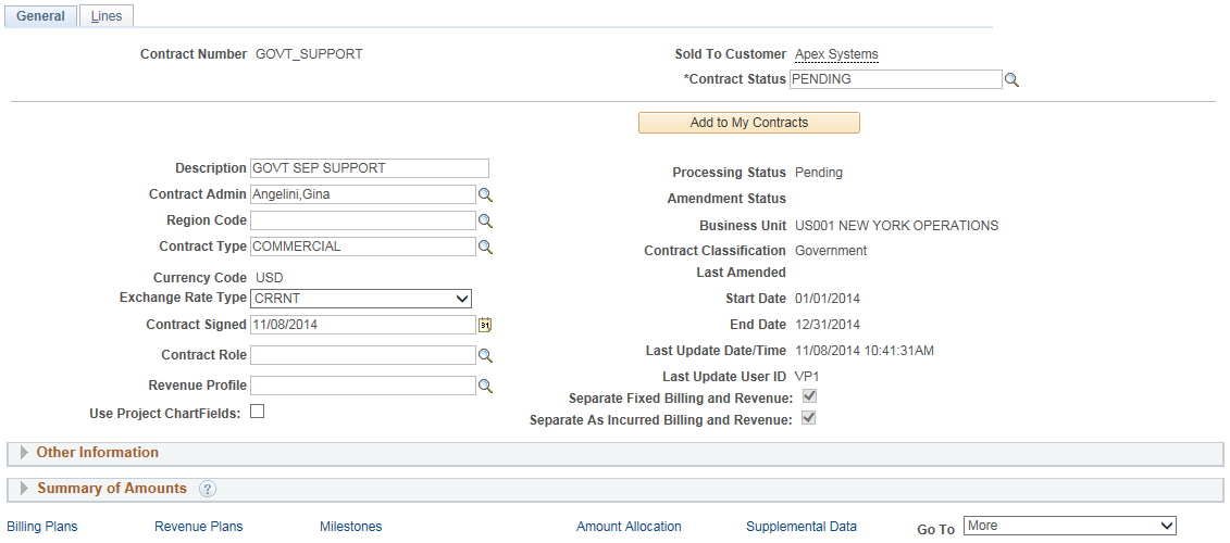

Contract Lines - General Page
Use the Contract - Lines page (CA_OBLIGATIONS) to add products to a contract.
Each product appears on the contract as a distinct contract line number. From this page, you can view or access all details defined for a contract line.
Navigation:
Customer Contracts, and then Create and Amend, and then General Information, and then Lines
This example illustrates the fields and controls on the Contract Lines page: General tab. You can find definitions for the fields and controls later on this page.
Contract Lines page - General
After selecting products into the contract, the Contract - Lines tabs enable you to view and enter all required details for the contract lines. Each contract line represents a unique contract product that can be associated with its own accounting distributions, limits, fees, progress payments, billing and revenue plans, and so on.

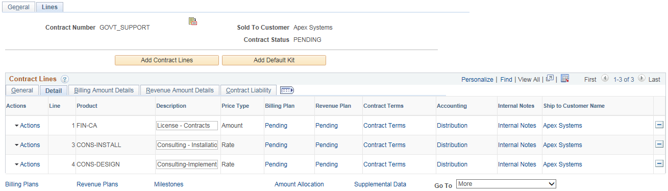

Contract Lines - Detail Page
View
Access the Contract - Lines page: Detail tab (click the Detail tab on the Contract - Lines page).
This example illustrates the fields and controls on the Contract Lines page: Detail tab. You can find definitions for the fields and controls later on this page.
Contract Lines page - Detail tab
The Contract - Line Details page provides links for each contract line to enable you to set up billing and revenue plans, contract terms, accounting distribution, and to add internal notes.
Field or Control Description
Billing Plan
Displays the status of the billing plan assigned to the contract line as a link. To access the Billing Plan General page for the billing plan created and assigned to the contract line, click the status link for the contract line.
Revenue Plan
Displays the status of the revenue plan assigned to the contract line as a link. To access the Revenue Plan page for the revenue plan created and assigned to the contract line, click the status link for the contract line.
Contract Terms
Click the Contract Terms link to access the Contract Terms component (CA_DETAIL_PROJ). The Contract Terms component enables you to define limits for contract line funded amounts and fees, associate projects and activities with the contract line, and set up withholding parameters.
Accounting
Click the Distribution link to access the Accounting Distribution page. Use this page to manage account distribution data for amount-based and rate-based contract lines. For amount-based contract lines, specify the contract asset s receivable, revenue, and contract liability accounting distributions used by the system to generate accounting entries for the contract line. For rate-based contract lines, specify the Revenue Forecasting account distribution data used by the system when generating a revenue forecast for the contract line.
If an error occurs during processing, an Action Required link appears instead of the Distribution link. Errors may occur for the following reasons:
  • The combination editing check failed.
  • You allocated the accounting by amount, and the amount does not match the value on the contract line.
See PeopleSoft Contracts: Accounting Distributions.
Internal Notes
Click to access the Internal Notes page to add or view notes related to this contract line.
Ship to Customer Name
Click to access the Ship To Address page to manage the ship-to customer information for this contract line.
Defaults are based on the sold-to customer that you selected on the Billing Options page. You can select an alternate ship-to ID.

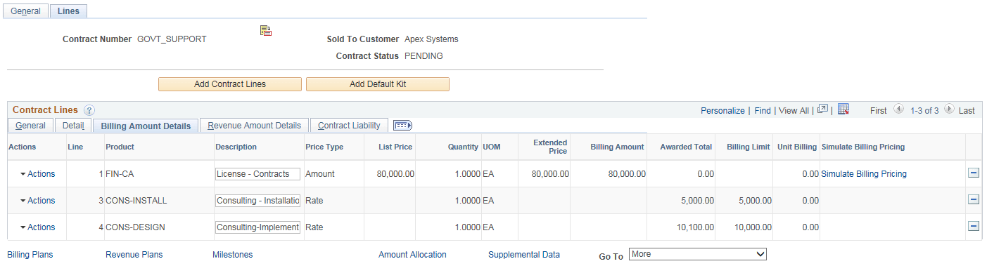

Contract Lines — Billing Amount Details Page
Access the Lines page: Billing Amount Details tab (click the Billing Amount Details tab on the Contract - Lines page).
This example illustrates the fields and controls on the Contract Lines page: Billing Amount Details tab. You can find definitions for the fields and controls later on this page.
Contract Lines page - Billing Amount Details page
View the pricing information for a contract line. The system updates these fields to reflect any changes that you make to the price detail for contract lines on the Billing Allocation page.
List Price
Displays the list price defined on the Product Price page for amount-based products. The list price appears in the contract currency.
Quantity
Displays the quantity for the product that you added to the contract line. For amount-based products, the system uses the quantity as a multiplier to determine the total fixed price amount for the contract line. This field is display-only.
If you want to change the quantity before the contract is activated, do so on the Billing Allocation page. After contract activation, you can change the quantity through an amendment on the Amendment Billing Allocation page.
UOM (unit of measure)
Displays the unit of measure defined on the Product Price page for amount-based products.
Extended Price
Displays the list price multiplied by quantity for amount-based contract lines.
Billing Amount
Displays the billing amount for amount-based contract lines, allocated for this contract line, on the Billing Allocation page, and then multiplied by the quantity. This field is updated when changes are made on the Billing Allocation page.
Awarded Total
Displays the calculated total of the awarded costs and awarded fee amounts for the contract line.
Unit Billing
Displays the unit billing price for the contract line. This value is calculated as Net Billing divided by Quantity for amount based lines, Billing Limit divided by Quantity for rate based lines, and Recurring Billing divided by Quantity for recurring contract lines.
Simulate Billing Pricing
Click to open the Pricing Simulator page where relevant contract and product details used to determine the current product price for billing are displayed. Prices are based on product pricing configuration maintained in Order Management and the Enterprise Pricer and contract specific attributes that may be used as criteria for determining price. Contract line start date is used as the effective date for calculating prices. If contract line Start Date is not available then contract Sign Date is used. For more information on the Pricing Simulator see PeopleSoft Enterprise Pricer: Understanding the Pricing Simulator.
Note: The Enterprise Pricer Transaction Code used to identify prices for billing is ‘CA’ (Contracts). See PeopleSoft Enterprise Pricer: Price Transaction Code Page

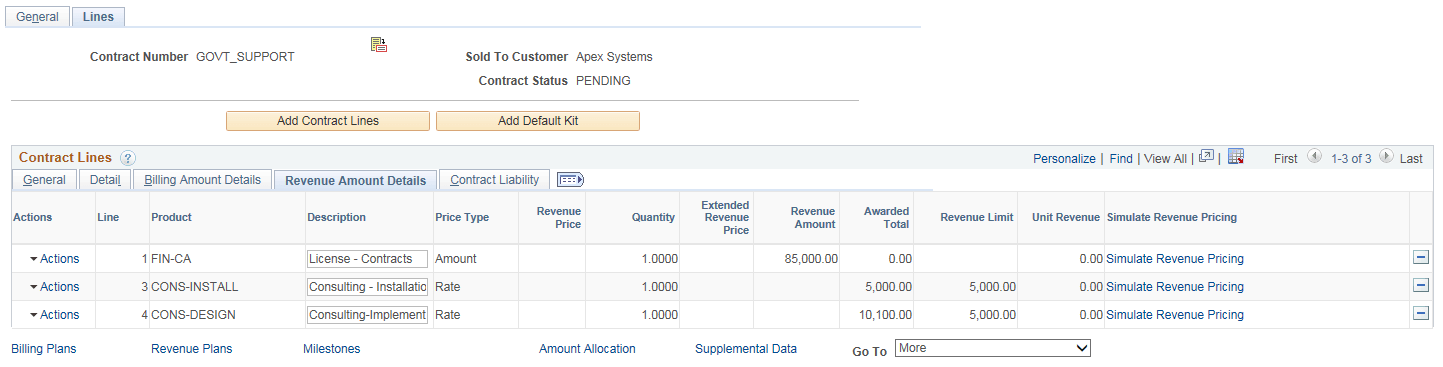

Contract Lines — Revenue Amount Details Page
Access the Lines page: Revenue Amount Details tab (click the Revenue Amount Details tab on the Contract - Lines page).
This example illustrates the fields and controls on the Contract Lines page: Revenue Amount Details tab. You can find definitions for the fields and controls later on this page.
Contract Lines page - Revenue Amount Details page
View the pricing information for a contract line. The system updates these fields to reflect any changes that you make to the price detail for contract lines on the Revenue Allocation page.
Revenue Price
Displays the product’s revenue price as calculated in Order Management and the Enterprise Pricer. Note that the Enterprise Pricer uses prices identified to transaction code RP for revenue pricing whereas prices identified to transaction code CA (contracts) are used for billing pricing. This applies to contracts identified as having separated billing and revenue. If the contract does not separate billing and revenue then the revenue price will be same as the list price. Revenue Price is not applicable for percent based lines and recurring contract lines. See PeopleSoft Enterprise Pricer: Price Transaction Code Page
Quantity
Extended Revenue Price
Displays the revenue price multiplied by quantity for amount-based contract lines.
Revenue Amount
Displays the revenue amount entered on the Revenue Allocation page. Applies to amount and percent based contract lines only.
Awarded Total
Revenue Limit
Displays the revenue limit entered on the Revenue Allocation page. Only contract lines with a price type of Rate have limits. On initial adding of the contract line, the revenue price is used as the default revenue limit multiplied by the quantity. It is then updated based on changes made on the Revenue Allocation page.
If the system generated suggested amount is greater than the revenue limit, then an error message is displayed and the revenue limit has to be manually overridden.
Unit Revenue
Displays the unit revenue price for the contract line. This value is calculated as Net Revenue divided by Quantity for amount and percent based lines, Revenue Limit divided by Quantity for rate based lines, and Recurring Revenue divided by Quantity for recurring contract lines.
Simulate Revenue Pricing
Click to open the Pricing Simulator page where relevant contract and product details used to determine the current product price for revenue are displayed. Prices are based on product pricing configuration maintained in Order Management and the Enterprise Pricer and contract specific attributes that may be used as criteria for determining price. For more information on the Pricing Simulator see PeopleSoft Enterprise Pricer: Understanding the Pricing Simulator.
The Revenue Amount Details will be same as the Billing Amount Details if both the Separate Fixed Billing and Revenue check box and the Separate As Incurred Billing and Revenue check box are not selected while creating a contract.

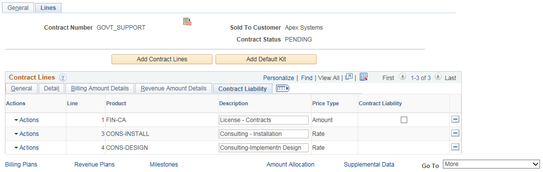

Contract Lines — Contract Liability Page
Access the Lines page: Contract Liability tab (click the Contract Liability tab on the Contract - Lines page).
This example illustrates the fields and controls on the Contract Lines page: Contract Liability tab. You can find definitions for the fields and controls later on this page.
Contract Lines page - Contract Liability
Generating accounting entries for contract liability enables you to post revenue that you expect to realize in a future accounting period for amount-based contact lines to the general ledger. If the contract is in Pending status, you can enable contract liability by selecting this check box. If the contract is in Active status, you cannot change this setting unless you are in amendment mode.
Contract Liability
Select to enable contract liability processing at the contract line level for amount-based contract lines. The contract liability option can also be set up on the Product Group Options page, so that it appears on this page when the product associated with that product group is added to the contract.
Note: If you choose to set up the contract liability option at the Contracts Product Group Options level, you will not be able to override the contract liability setting at the contract line level unless you have also selected the Contract Liability Override option at the PeopleSoft Contracts business unit level.
Contract Liability Status
Displays the status of the contract liability processing for this contract line. This field only appears when the Contract Liability check box is selected.
Contract Liability Acctg Date
Select the contract liability accounting date for the amount-based contract line. The Contract Liability process does not process any contract line until you specify the contract liability accounting date. In addition, if contract liability is enabled, any related amount-based revenue processes do not process until the contract liability process is run. This field only appears when the Contract Liability check box is selected.
