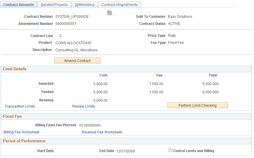

Contract Amounts Page
Use the Contract Amounts page (CA_AMT_TERMS) to define contract terms and conditions, and set up limit processing parameters for rate-based contract lines (cost-plus and non-cost-plus).
Navigation:
  • Customer Contracts, and then Determine Price and Terms, and then Contract Terms, and then Contract Amounts
  • Click the Contract Terms link on the Detail tab of the Contract - Lines page, and then select the Contract Amounts tab.
This example illustrates the fields and controls on the Contract Amounts Page. You can find definitions for the fields and controls later on this page.
The Contract Amounts page enables you to enter funded, revenue, transaction, and fee limit details for contract lines associated with a government contract. For rate-based contract lines associated with a fee type other than None (cost-plus), this page will display fields specific to the fee type selected for the contract line.
See Defining Cost-Plus Contract Lines.
See Understanding Limits.
Limit Details
Field or Control Description
Awarded
Displays the awarded amount for the contract line. This amount is used as a control amount and the funded amount cannot exceed this number. The value for this field can be edited on the Billing Allocation page.
Funded
Displays the funded billing limit for costs for the contract line. This amount is used in limit processing for transactions recorded against this contract line. The amount billed cannot exceed this amount. The value for this field can be edited on the Billing Allocation page.
Revenue
Displays the revenue limit for costs for the contract line. This amount is used in limit processing for revenue and available for all rate based contract lines irrespective of fee type. If As Incurred Billing and Revenue are Separated on the contract, then this amount is editable on the Revenue Allocation page. If not, then the amount matches the Funded amount.
Fee
Awarded Fee is used as a control amount. Funded fee cannot exceed awarded fee. If As Incurred Billing and Revenue are Separated on the contract, then use the link to the Revenue Fee worksheet to identify fees for revenue separate from billing.
Transaction Limits
Click to access the Transaction Limits page and enter transaction limit criteria and amounts for this contract line.
See Transaction Limits Page.
Review Limits
Click to access the Review Limits component. The Review Limits component enables you to review overall limit amounts, amounts remaining, and any amounts in excess for the contract line. For excess limit amounts, you can also view the details of the excess transactions.
Perform Limit Checking
Click this button to perform ad hoc limit checking for this contract line. Clicking this button will launch the Limits (CA_LIMIT) process, which will run limit checking for the contract line's billing and revenue limit amounts if changes were made using amendment processing.
Period of Performance
Start Date
Enter the start date for the contract line. PeopleSoft Contracts enables you to control billing and limit processing within a specified date range per contract line. After the contract is set to an active processing status, this date can no longer be changed if the Control Limits and Billing check box is selected. Otherwise, you can change this date using amendment processing.
End Date
Enter the end date for the contracts line. After the contract is set to an active processing status, this date can be changed using amendment processing. However, this date cannot be set to a date before the current system date if the Control Limits and Billing check box is selected.
Select to control billing and limit processing for rate-based contract lines associated with a fee type (cost-plus). When this option is selected, the Contracts/Billing Interface (CA_BI_INTFC) process and the Limits (CA_LIMIT) process will not select transactions for processing if the transaction date falls outside the period of performance date range.

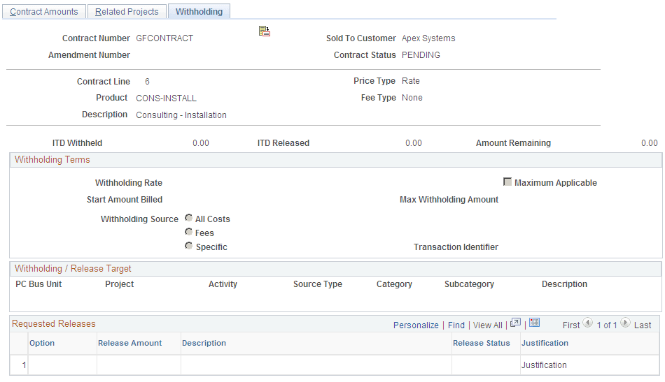

Withholding Page
Use the Withholding page (CA_WTH_TERMS) to set up withholding and release terms and conditions for rate-based contract lines.
Navigation:
Customer Contracts, and then Determine Price and Terms, and then Contract Terms, and then Withholding
This example illustrates the fields and controls on the Withholding page. You can find definitions for the fields and controls later on this page.
Withholding page
ITD Withheld (inception to date withheld)
Displays the amount withheld from billing for the contract line from the inception date of the contract to the current date. This amount is based on transaction data stored in the Project Costing Project Transaction table. This amount does not include any withholding in progress amounts, such as withholding amounts calculated by the Contracts to Billing Interface process (CA_BI_INTFC) but not yet reported to PeopleSoft Project Costing by the Retrieve Billing Items process (PC_BI_TO_PC).
ITD Released (inception to date released)
Displays the withholding amount released to billing for the contract line from the inception date of the contract to the current date. This amount is based on transaction data stored in the Project Costing Project Transaction table.
Amount Remaining
Displays the calculated difference between the amount withheld to date and the amount released to date.
Withholding Terms
Withholding Rate
Enter the withholding percentage that the system will use to calculate withholding amounts on withholding applicable billed or billable project transactions.
Start Amount Billed
Enter the actual amount that must be billed for the contract line before the system should apply the withholding terms. Leave this field blank if the system should apply the withholding terms for all applicable transactions that occur for this contract line.
Maximum Applicable
Select this check box to indicate that there is a maximum amount that can be withheld from this contract line. If you select this check box, then you should also enter a maximum withholding amount. The system issues a warning message if you do not enter a maximum withholding amount.
Max Withholding Amount (maximum withholding amount)
Enter the maximum amount that can be withheld from this contract line. Use this field in conjunction with the Maximum Applicable check box.
Withholding Source
Select the type of project transactions that are eligible for withholding calculations. Select from:
  • All Costs: Select this option to include every cost associated with the contract line in the withholding calculations.
  • Fees: Select this option to include only fee transactions associated with the contract line in the withholding calculations.
  • Specific: Select this option to specify the transaction types associated with the contract line to be included in the withholding calculations. This option works in conjunction with the Transaction Identifier field.
Select the transaction identifier that the system should use to determine which transactions to include in the withholding calculations for the contract line. Transaction identifiers must first be defined in PeopleSoft Project Costing that will enable you to predefine groupings of valid project ChartFields, which can be used to identify specific transactions.
Note: This option must be used when the Withholding Source option of Specific is selected.
Withholding/Release Target
PC Bus Unit (PeopleSoft Project Costing business unit)
Displays the PeopleSoft Project Costing business unit associated with the rate-based contract line on the Related Projects page.
Project
Enter the project identifier that the system assigns to the summary withholding and release bill lines sent from PeopleSoft Contracts to PeopleSoft Billing and back to the PeopleSoft Project Costing project transaction tables. Select from projects that are associated with the contract line on the Related Projects page. This field is required.
Activity
Enter the activity identifier that the system assigns to the summary withholding and release bill lines sent from PeopleSoft Contracts to PeopleSoft Billing and back to the PeopleSoft Project Costing project transaction tables. Select from activities that are associated with the contract line on the Related Projects page. This field is required.
Source Type
Select the Source Type project ChartField value that the system assigns to the withholding and release summary lines that are passed to PeopleSoft Billing from PeopleSoft Contracts and to PeopleSoft Project Costing from PeopleSoft Billing. Source types, which are defined in PeopleSoft Project Costing, enable you to define a value that identifies a transaction's purpose. Source types can be used to track, analyze, and report on transactions.
Note: This field is required if the Input Control for Source Type is set to Required on the PeopleSoft Project Costing Business Unit-Project Costing Options page.
Category
Select the Category project ChartField value that the system assigns to the withholding and release summary lines that are passed to PeopleSoft Billing from PeopleSoft Contracts and to PeopleSoft Project Costing from PeopleSoft Billing. Categories defined in PeopleSoft Project Costing enable you to further define source types to better track the types of costs occurring against your project and activities.
Note: This field is required if the Input Control for Category is set to Required on the Project Costing Business Unit-Project Costing Options page.
Subcategory
Select the Subcategory project ChartField value that the system assigns to the withholding and release summary lines that are passed to PeopleSoft Billing from PeopleSoft Contracts and to PeopleSoft Project Costing from PeopleSoft Billing. Subcategories defined in PeopleSoft Project Costing enable you to further define source types to better track the types of costs occurring against your project and activities.
Note: This field is required if the Input Control for Subcategory is set to Required on the Project Costing Business Unit-Project Costing Options page.
Description
Enter the description that you want to appear on the billing invoice for the withholding bill line. This field is required.
Requested Releases
If any of the fields in the Requested Release section are populated, even with a zero value, then all fields become required by the system.
Option
Select the release option for the release amount row. Select from the following options:
  • Bill: Select this option to pass the release row billing data to PeopleSoft Billing and add the release row amount to the invoice as a billable amount.
  • Write-Off: Select this option to write off the release row amount and pass the write-off data to PeopleSoft Billing and PeopleSoft Project Costing.
Release Amount
Enter the amount to be released. When entering a release amount, it cannot exceed the withholding Amount Remaining for the contract line.
Description
Enter the description that you want to appear on the billing invoice for the release bill line.
Release Status
Displays the processing phase for the release row during release processing. The release row may be set to or display one of the following statuses:
  • Pending: Set by the system as a default status. Release rows with a status of Pending are not selected and processed by the withholding process.
    Note: You can only have one release row in Pending status for a contract line. No additional rows may be added until the pending row displays a status of Complete.
  • Ready: Set by the user to indicate that the release row is available for processing. The withholding process will not select release rows for processing unless they are set to Ready status.
    Note: You can only have one release row in Ready status for a contract line. No additional rows may be added until the ready row displays a status of Complete.
  • In Process: Set by the system once the withholding process is initiated by the system. Release rows with a status of In Process are display-only and cannot be deleted.
    Note: You cannot add any additional release rows if the previous release row has a status of In Process.
  • Complete: Set by the system once the PeopleSoft Billing to Projects/Contacts interface process is run. Additional release rows can only be added once the previous release row has a status of Complete.
Justification
Click the link to open a free-form text box that enables you to enter details to justify the release amount. This data is informational only and does not prohibit any processing from occurring.
