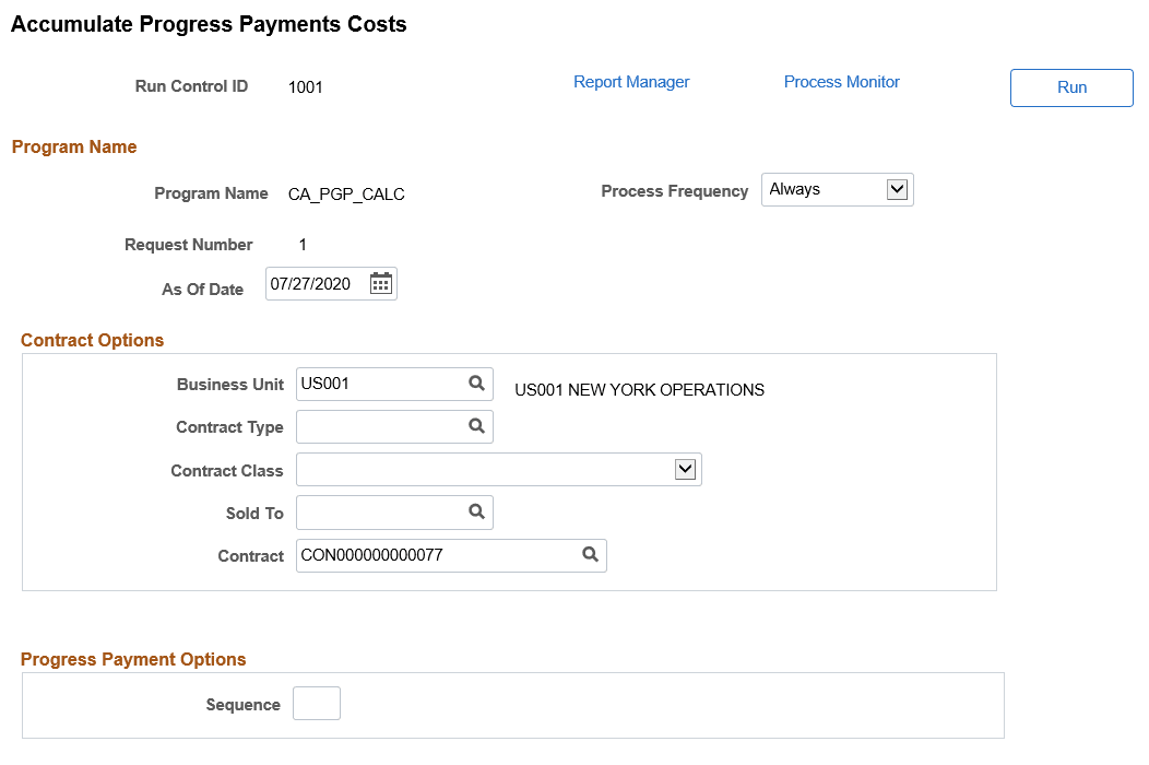

Accumulate Progress Payments Costs Page
RUN_CA_PGP_COSTS

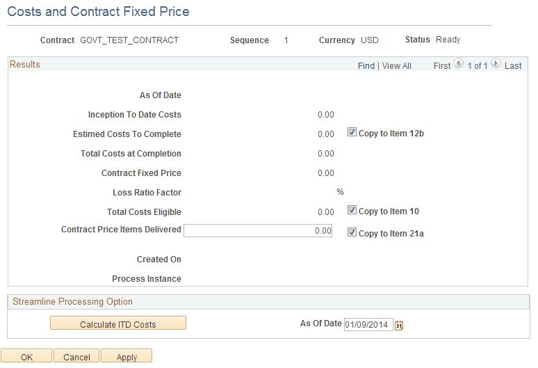

Cost and Contract Fixed Price Page
CA_PGP_COST
View incurred or estimated costs used in the progress payment worksheet calculations. When viewing the incurred or estimated costs on the Costs and Contract Fixed Price page, the system retrieves the data from the Contracts Progress Payment Costs table based on the As of Date on the worksheet. If an exact date match is not found, the system uses the closest past As of Date to populate the page. If no data is available then the page is blank.

When you are ready to populate the worksheet, run the Accumulate Progress Payment Costs process (CA_PGP_CALC) to retrieve the most current cost data from the PROJ_RESOURCE table and update various fields in the progress payment worksheet. After the fields are populated, you can update or modify certain fields to include any additional costs that are eligible for progress payment requests. After the worksheet is completed and submitted, it is no longer editable.
Running the Accumulate progress Payment Costs process can be done in batch, right before populating the worksheet, in real time, through the Review Costs page, or not at all. You are not required to run the process prior to populating the worksheet if you are completing the worksheet manually. However, running the process enables you to retrieve the most current costing data from PeopleSoft Project Costing and reduces the amount of data entry required to complete the worksheet.

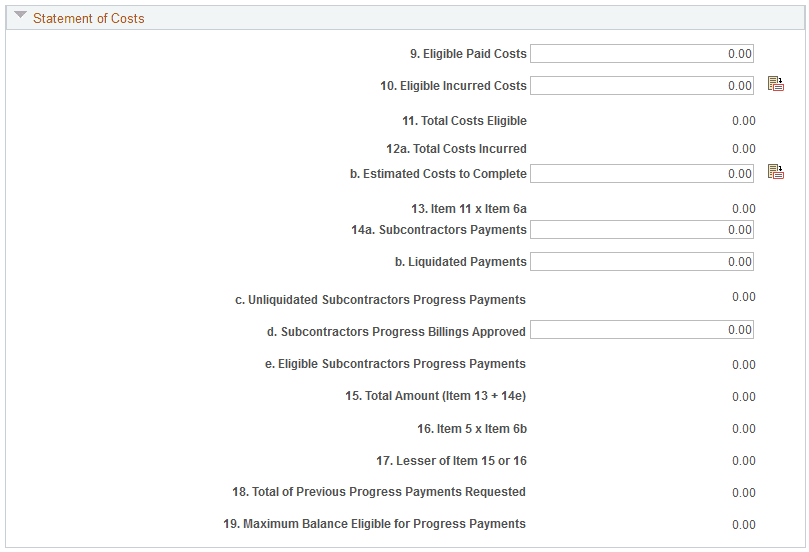

11. Total Costs Eligible
Item 9 + Item 10
Costs paid to date: 10,000 USD
Incurred costs to date: 25,000 USD
Total costs eligible: 35,000 USD
12a. Total Eligible Costs Incurred to Date
Item 11 + Item 14a
Progress payments paid to subcontractors: 500 USD
Total eligible costs incurred to date: 35,500 USD
13. Item 11 Multiplied By 6a (Total Costs Eligible Multiplied by the Progress Payment Rate)
Item 11 x Item 6a
Progress payment rate: 75%
Item 11 multiplied by 6a: 26,250 USD
14c. Unliquidated Progress Payment to Subcontractors
Item 14a - Item 14b
Liquidated progress payment to subcontractors: 0 USD
Unliquidated progress payment to subcontractors: 500 USD
14e. Eligible Subcontractors Progress Payments
Item 14 c + Item 14d
Subcontractor progress billing approved: 200 USD
Eligible subcontractors progress payments: 700 USD
15. Total Amount (Item 13 + 14e)
Item 13 + Item 14e
Item 11 multiplied by item 6a: 26,250 USD
Total amount: 26,950 USD
16. Item 5 x Item 6b (Contract Fixed Price Multiplied by the Progress Payment Liquidation Rate)
Item 5 x Item 6b
Contract fixed price: 100,000 USD
Progress payment liquidation rate: 75%
Item 5 x item 6b: 75,000 USD
17. Lesser of Item 15 or 16
Min (Item 15, Item 16)
Lesser of item 15 or 16: 26,950 USD
18. Total of previous progress payments requested
Sum (CA_PGP_AMT)
Total Amount of Progress Payments requested to date: 0 USD
Note: This field displays the summary total of all progress payment requests that have been finalized or are still in progress, so this amount may be greater than the progress payment amount stored in the Progress Payment table (CA_PGP_TERMS) in the Progress Payment Amount field (CA_PGP_AMT)
19. Maximum Balance Eligible for Progress Payment
Item 17 – Item 18
Total amount of previous progress payments requested: 5000 USD
Maximum balance eligible for progress payment: 21,950 USD

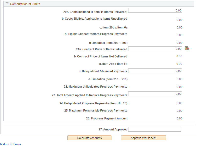

20b. Costs Eligible Applicable to Items Delivered
Item 11 – Item 20a
Costs included in item 11 (Items delivered): 7500 USD
Costs eligible applicable to items delivered: 27,500 USD
20c. Item 20b x Item 6a (Costs Eligible Applicable to Items Delivered Multiplied by the Progress Payment Rate Factor)
Item 20b x Item 6a
Progress payment rate factor: 75%
Item 20b x Item 6a: 20,625 USD
20e. Limitation (Item 20c + 20d)
Item 20c + Item 20d
Item 20b x progress payment rate factor: 20,625 USD
Eligible Subcontractor progress payments: 700 USD
Limitation (Item 20c + Item 20d): 21,325 USD
21b. Contract Price of Items Not Delivered
Item 5 – Item 21a
Contract price of items delivered: 7500 USD
Contract price of items not delivered: 92,500 USD
21c. Item 21b x 6 b (Contract Price of Items Not Delivered Multiplied by the Liquidation Rate factor)
Item 21b x Item 6b
Liquidation rate factor: 75%
Item 21b x 6b: 69,375 USD
21e. Limitation (Item 21c + 21d)
Item 21c + Item 21d
Item 21c x progress payment liquidation factor: 69,375 USD
Unliquidated advance payments: 0
Limitation (Item 21c + Item 21d): 69,375 USD
22. Maximum Unliquidated Progress Payment: Lesser of 20e or 21e
Min(Item 20e,Item 21e)
Limitation (Item 20c + 20d): 21,325 USD
Limitation (Item 21c +Item 21d): 69,375 USD
Maximum unliquidated progress payment amount: 21,325 USD
24. Unliquidated Progress Payment (Item 18–23)
Item 18 – Item 23
Total of previous progress payments requested: 5000 USD
Total amount applied to reduce progress payments: 2500 USD
Unliquidated progress payment: 2500 USD
25. Maximum permissible progress payment (Item 22–24)
Item 22 – Item 24
Unliquidated progress payment amount: 2500 USD
Maximum permissible progress payment amount: 18,825 USD
26. Progress Payment Amount
Min (Item 25, Item 19)
Maximum Balance Eligible for Progress Payment: 21,950 USD
Progress Payment Amount: 18,825 USD

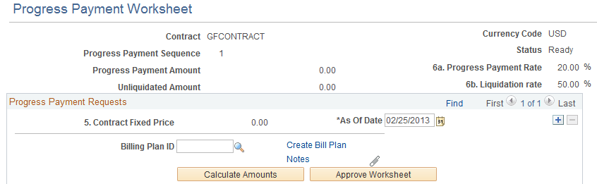

Progress Payment Worksheet Page
Use the Progress Payment Worksheet page (CA_PGP_WKS) to calculate progress payment amounts and submit them for billing.
Navigation:
  • Customer Contracts, and then Manage Progress Payments, and then Progress Pymt Worksheet
  • Click the Progress Payment Worksheet link on the Billing tab of the Progress Payments component.
This example illustrates the fields and controls on the Progress Payment Worksheet page (1 of 3). You can find definitions for the fields and controls later on this page.
This example illustrates the fields and controls on the Progress Payment Worksheet page (2 of 3). You can find definitions for the fields and controls later on this page.
This example illustrates the fields and controls on the Progress Payment Worksheet page (3 of 3). You can find definitions for the fields and controls later on this page.
Displays the total amount of the amount-based contract lines currently associated with the progress payment terms. This value is impacted by any additions or deletions of contract lines associated with the progress payment terms.
Bill Plan Id
Enter a predefined immediate billing plan to process the progress payment worksheet request. If you specified a billing plan template and billing plan detail template when setting up your progress payment terms, leave this field blank, and the system automatically creates an immediate billing plan using the template data once the request is approved. If using a predefined immediate billing plan, that billing plan cannot be shared with any other progress payment worksheets or contract lines.
Note: If you have set up the billing plan template automation to ready the billing plan upon worksheet approval, the system creates an immediate billing plan in Ready status.
Create Bill Plan
Click the Create Bill Plan link to create a billing plan directly from the progress payment request worksheet. This link opens the Billing Plan component (CA_BILLPLAN) for an Immediate billing plan.
After you complete the required fields for the billing plan, and click the OK button, the system returns you to the Progress Payment Worksheet page and displays a link for the billing plan identifier in place of the Create Bill Plan link.
Note: Billing plans assigned to progress payment worksheets cannot be set to Ready status until the worksheet has been approved.
Calculate Amounts
Click the Calculate Amounts button to automatically recalculate any formula field in the worksheet and incorporate any changes that are made to any of the cost fields or factors. This action recalculates and updates the noneditable fields on the worksheet page.
If changes are made to the worksheet and you do not recalculate or save the worksheet prior to approving the worksheet, the system processes the worksheet with the original figures.
Note: Clicking the Approve button does not automatically trigger any recalculations of changed fields, but instead saves the worksheet as is.
Approve Worksheet
Click the Approve Worksheet button to submit the progress payment request for billing. After you click the button, the system performs the following actions:
  • Verifies that the progress payment amount does not equal zero.
  • Verifies that the progress payment amount is not greater than the contract fixed price.
  • Updates the Approved status in the Progress Payment Worksheet (CA_PGP_WKS) table to Yes.
  • Automatically creates an immediate billing plan using the following information:
    • Billing plan and billing plan detail templates specified in the Progress Payment Terms component (CA_PGP_TERMS).
    • Billing plan identifier specified on the progress payment worksheet.
      Note: If you approve the worksheet and have not assigned a billing plan and billing plan detail template, the system issues an error message.
  • Sets or updates the billing plan status to Ready, for billing plans with the Approve Progress Payments check box selected at the billing plan template level.
    Note: If you manually assign a billing plan to the progress payment worksheet and do not select the Approve Progress Payments check box for the billing plan template, the billing plan is created in Pending status, and you must manually update the billing plan status to Ready after you approve the progress payment worksheet.
  • Verifies that any negative progress payment amounts are not greater than the unliquidated amount.
  • Creates a credit bill for any negative progress payment amounts.
As of Date
Displays the date used to calculate the inception to date costs.
Notes
Click the Notes link to open a free-form text field and enter any additional notes regarding a specific worksheet.
Attachments icon (Attachments)
Click the Attachments button to attach any additional documents containing detailed explanations of the computations for the progress payment amount.
Save
Click the Save button to save the worksheet. If changes are made to the worksheet, it is recommended that you recalculate your worksheet totals prior to saving the worksheet to verify the new totals.
Statement of Costs
The statement of costs section of the worksheet contains the data used to calculate ITD and estimated costs to complete (ECC) costs, which are used to determine the specific progress payment amount as of the date indicated in the Progress Payment Request group box. The numbered fields correspond to the Contractors Request for Progress Payment form 1443.
Field or Control Description
Eligible Paid Costs
Enter the total amount of any costs associated with the contract that you have already paid and are eligible for progress payment amounts as per the progress payment clause.
Eligible Incurred Costs
Displays the amount of the eligible incurred costs to date for the contract items associated with the progress payment terms. This amount is the results of the most recent ITD costs calculations performed by the system. You can copy the resulting amount from Costs and Contract Fixed Price page or manually enter values to incorporate any additional eligible costs.
If you adjust the amount for this field, you must recalculate the worksheet totals before approving the new progress payment request amount.
Displays the total overall amount of eligible costs available for progress payment requests. This amount is the total of the values entered or displayed in the Eligible Paid Costs and Eligible Incurred Costs fields. This amount is automatically calculated by the system and cannot be modified.
Total Costs Incurred (total costs incurred to date)
Displays the total eligible costs incurred to date. This amount is the total of your contract costs incurred to date plus any progress payments paid to subcontractors to date. These values are stored in the Total Costs Eligible and Subcontractors Payments fields. This total is calculated by the system and cannot be modified.
Estimated Costs to Complete
Displays the estimated additional costs to complete the contract items associated with the progress payment terms. This amount is the result of the most recent estimated additional cost to complete (ECC) calculations performed by the system. You can copy the amount from the Costs and Contract Fixed Price page or manually enter values to incorporate any additional eligible costs.
Item 11 x Item 6a
Displays the calculated results of the total costs that are eligible for progress payment requests multiplied by the progress payment rate factor defined on the Progress Payment Terms - General page. This amount is calculated by the system and cannot be modified.
Enter the total progress payment amount paid to date to subcontractors for the contract. This amount is not populated by the system and must be manually entered.
Liquidated Payments
Enter the total progress payment amount paid to subcontractors that has been liquidated. This amount is not populated by the system and must be manually entered.
Unliquidated Subcontractors Progress Payments
Displays the difference between the total progress payment amount paid to subcontractors and the amount liquidated (item 14a minus item 14b). This is a calculated amount and cannot be edited.
Subcontractors Progress Billings Approved
Enter the current amount of the progress payment paid to subcontractors that has been approved for billing, but not yet invoiced. This amount is not populated by the system and must be manually entered.
Displays the total of the Unliquidated Subcontractors Progress Payments plus the Subcontractors Progress Billings Approved (item 14c plus item 14d). This is a calculated amount and cannot be edited.
Displays the total costs eligible for progress payments multiplied by the progress payment rate factor, plus any eligible subcontractor progress payment amounts (unliquidated progress payment amounts and amounts approved for billing but not yet invoiced). This is a calculated amount and cannot be edited.
Item 5 x Item 6b
Displays the total amount of the contract lines associated with the progress payment terms multiplied by the liquidation rate factor. This is a calculated amount and cannot be edited.
Compares the total costs eligible for progress payments to the contract line amounts associated with the progress payment terms multiplied by the liquidation factor, and displays the lesser amount. The resulting field value is the total cost amount eligible for consideration for progress payments.
Total of Previous Progress Payments Requested
Displays the total amount of progress payment requests previously requested. This amount includes progress payment bills that are finalized or in progress. This field is automatically calculated when you click the Calculate Amounts button.
Displays the total of the amount of costs eligible for consideration for progress payments minus the total amount of progress payments previously requested. This is a calculated amount and cannot be edited.
Computation of Limits
The Computations of Limits section of the worksheet contains any costs for items already delivered or invoiced as of the progress payment request date. The system incorporates these costs to take into consideration the costs of items delivered compared to their contract price. These amounts are incorporated into the worksheet calculations to reduce the eligible progress payment amount. The final result of these computations is the maximum amount that you can approve for a progress payment request.
This part of the worksheet must only be populated if you have items that have been delivered or invoiced.
Costs included in Item 11 (Items Delivered)
Of your total paid costs and incurred costs to date, enter the amount that you included in that total for items that have already been delivered, invoiced or accepted to date for the contract.
Costs Eligible Applicable to Items Undelivered
Displays the difference between the total amount of your paid and incurred costs to date that are eligible for progress payments less any amounts associated with items that have already been delivered, invoiced or accepted (item 11 minus item 20a). This is a calculated amount and cannot be edited.
Item 20b x Item 6a
Displays the total costs for contract items eligible for progress payments not delivered, invoiced or accepted, multiplied by the progress payment rate factor. This is a calculated amount and cannot be edited.
Displays the total amount entered for progress payments for subcontractors not yet liquidated plus any progress payment amounts that have billing approved but not invoiced.
Displays the total of the costs eligible for progress payments associated with items not delivered, invoiced or accepted, multiplied by the progress payment rate factor plus any eligible subcontractor progress payment amounts. This is a calculated amount and cannot be edited.
Contract Price of Items Delivered
Enter the total price for items delivered, invoiced and accepted for contract lines associated with the progress payment. This amount is computed based on the billed amounts associated with the contract lines that are associated with the progress payment. You can copy the amount from the Costs and Contract Fixed Price page or manually enter values to incorporate any additional eligible amounts.
Contract Price of Items not Delivered
Displays the total for the contract price associated with the progress payment terms less the total price of items delivered, invoiced or accepted (item 21a). This is a calculated amount and cannot be edited.
Item 21b x Item 6b
Displays the total amount for items not delivered multiplied by the liquidation rate factor specified for the progress payment terms. This is a calculated amount and cannot be edited.
Unliquidated Advanced Payments
Enter the amount of progress payments received to date not yet liquidated, plus any accrued interest for the payments. This amount is not populated by the system and must be manually entered.
Displays the total of calculated costs for items not delivered multiplied by the liquidation factor plus the amount for any progress payments received but not yet liquidated. This is a calculated amount and cannot be edited.
Maximum Unliquidated Progress Payments
Compares the total costs for items not delivered that are eligible for progress payments, multiplied by the progress payment rate factor, plus any eligible subcontractor progress payments, (item 20e), with the contract costs associated with items not delivered multiplied by the liquidation factor, minus any progress payments that have not been liquidated, (item 21e), and displays the lesser amount. The resulting field value is the maximum unliquidated progress payment amount.
Total Amount Applied to Reduce Progress Payments
Enter the amount to date of progress payments received that have been liquidated. This amount is represented by the difference between the progress payment amount and the unliquidated amount displayed on the progress payment terms page. This field can be manually updated to also include payments and exclude bills where liquidation has occurred but have not yet been paid. This field is calculated when you click the Calculate Amounts button only if the field has a value of zero.
Unliquidated Progress Payments (Item 18 - 23)
Displays the total amount of progress payments requested to date less the total amount of progress payments liquidated to date. This is a calculated amount and cannot be edited.
Maximum Permissible Progress Payments
Displays the maximum permissible progress payment amount.
Displays the amount of the progress payment calculated by the worksheet that is available for billing. This amount is calculated by comparing the maximum balance available for progress payment requests (item 19) to the maximum amount permissible for progress payment requests (item 25), and displays the lesser amount. This is a calculated amount and cannot be edited.
Any manual adjustments or retainages that are required must be manually entered in the Amount Approved field.
Amount Approved
The value from the Progress Payment Amount field (item 26) appears by default in this field when it is first calculated and if the value in the Amount Approved field equals zero. You can manually override the amount or enter a negative amount if a refund or credit note is required. The amount entered in this field is sent to PeopleSoft Billing after the progress payment worksheet is approved and the Contracts/Billing interface process is run.
Note: Limited edit checks are performed on this field, so it is recommended that you verify that the progress payment request amount is valid prior to clicking the Approve Worksheet button.
Use the Accumulate Progress Payment Costs page (RUN_CA_PGP_COSTS) to retrieve incurred and estimated costs from the Project Transactions (PROJ_RESOURCE) table to determine eligible costs for progress payment requests, update or inserts the resulting rows into the Contracts Progress Payments Costs (CA_PGP_COSTS) table, or calculate contracts fixed price as a batch process.
Navigation:
  • Customer Contracts, and then Manage Progress Payments, and then Accumulate Progress Pymts Cost
  • Click the Calculate ITD Costs button on the Costs and Contract Fixed Price page in the Progress Payment Worksheet page.
This example illustrates the fields and controls on the Accumulate Progress Payments Costs page. You can find definitions for the fields and controls later on this page.
As of Date
Enter the date that the system uses to retrieve cost information from the PeopleSoft Project Costing Project Transaction (PROJ_RESOURCE) table. The system retrieves applicable costs data where the accounting date is equal to or less than the as of date and budget data where the accounting date is greater than the as of date. This is a required field.
Sequence
Enter the progress payment sequence identifier associated with a particular set of progress payment terms to retrieve costs for projects and activities associated with that progress payment terms row.
Use the Costs and Contract Fixed Price page (CA_PGP_COST) to view incurred or estimated costs used in the progress payment worksheet calculations.
Navigation:
Click the Costs and Contract Fixed Price button on the Progress Payment Worksheet page.
This example illustrates the fields and controls on the Costs and Contract Fixed Price page. You can find definitions for the fields and controls later on this page.
Results
As of Date
Displays the effective date of the inception to date cost rows and estimated costs to complete rows calculated and retrieved by the system from the Project Transaction table. The latest as of date displays first.
Inception to Date Costs
Run the Accumulate Costs process (CA_PGP_CALC) to populate this field with the inception to date costs for the contract whose accounting date is less than or equal to the as of date.
Note: Cost amounts are displayed in the contract currency.
Run the Accumulate Costs process (CA_PGP_CALC) to populate this field with the estimated (budgeted) costs to complete for the contract whose budget accounting date is greater than or equal to the as of date. The value can be copied onto the worksheet for inclusion in the progress payment computations.
Copy to Item 12b
Select this check box to copy the amount in the Estimated Costs to Complete field to the corresponding field in the progress payment worksheet (item 12b). If a value already exists on the worksheet, the system enables you to select which value to use.
Note: This check box can only be selected for one effective dated row on the Cost and Contract Fixed Price page.
Total Costs at Completion
Displays the total of the inception to date costs plus the estimated costs to complete. This is a calculated amount and cannot be edited.
Displays the total amount of the amount-based contract lines associated with the progress payment terms.
Loss Ratio Factor
Displays the results of the contract fixed price amount divided by the total costs at completion for the contract (inception to date costs plus estimated costs to complete costs). This ratio cannot be greater than 1.0 in order to cap the eligible costs at the total contract price. If the calculated amount exceeds 1.0, the system automatically changes the loss ratio factor to 1.0.
Displays the calculated total of the total costs at completion multiplied by the loss ratio factor.
Copy to Item 10
Select this check box to copy the calculated results of the total costs eligible to the corresponding Eligible Incurred Costs field. If a value already exists on the worksheet, the system enables you to select which value to use.
Note: This check box can only be selected for one effective dated row on the Cost and Contract Price page.
Contract Price Items Delivered
Displays the total amount billed for the contract lines associated to the progress payment terms. This amount is calculated based on billing plans associated to those contract lines that have billing plan lines with statuses of FIN (Finalized).
Copy to Item 21a
Select this check box to copy the calculated amount for items delivered to the corresponding Contract Price of Items Delivered field. If a value already exists on the worksheet, the system enables you to select which value to use.
Streamline Processing Option
Calculate ITD Costs (calculate inception to date costs)
Click the Calculate ITD Costs button to launch the Accumulate Costs process. The process is run synchronously and the page is refreshed as soon as the process is ended.
As of Date
When using the streamline processing options to run the Accumulate Costs process, enter the date that the system uses when retrieving cost information from the Project Costing Project Transaction (PROJ_RESOURCE).
