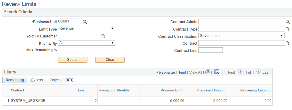

Review Limits page - Remaining tab

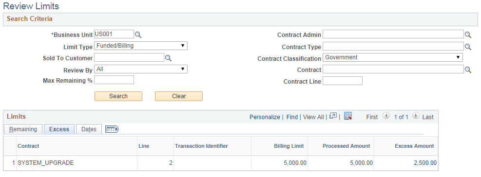

This example illustrates the fields and controls on the Review Limits page - Excess tab. You can find definitions for the fields and controls later on this page.

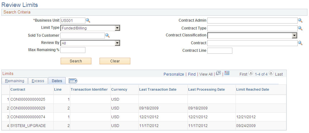

This example illustrates the fields and controls on the Review Limits page: Dates tab. You can find definitions for the fields and controls later on this page.
Search Criteria
Use the fields in the Search Criteria group box to filter results. If you leave fields blank, the search returns all limits for all Active contract lines within your system. At a minimum, you must enter the Business Unit, Limit Type, and Review By fields to perform a search request. Click the Search button to carry out a search based on the search criteria that you entered. Search results appear in the Limits scroll area. Amounts appear in the contract currency.
Fee limits do not appear on this page. Fee limits for rate-based contract lines associated with a fee type (cost-plus) can be viewed on the Billing and Revenue Worksheet pages and Contract Amounts pages for the contract line.
Field or Control Description
Limit Type
Select a limit type. If you leave this field blank, Funded/Billing is the default value for this field. Limit type values include:
  • Funded/Billing: Select this option to view all funded or billing limits for your contract lines.
  • Revenue: Select this option to view all revenue limits associated with the contract line.
Review By
Select the Review By criteria. Review By values include:
  • All: Select to view all limit amounts including any remaining amounts and amounts that have exceeded the limits for contract lines meeting your selection criteria.
  • Excess: Select to view only those amounts that have exceeded the limit amount for contract lines meeting your selection criteria. If you select this value, only the Excess and Date pages appear.
  • Remaining: Select to see the remaining available limit amounts for contract lines meeting your selection criteria. If you select this value, only the Remaining and Dates pages appear.
Max Remaining % (maximum remaining percentage)
Enter a maximum remaining amount percentage to restrict the results to only those contract lines with that limit amount percentage or less remaining. If you set the Review By field to Remaining, you must enter a field value greater than zero and less than 100. If you set the Review By field to Excess or All, the Max Remaining % field must be set to zero to retrieve the desired results.
Excess Tab
Select the Excess tab.
The Excess tab displays the funded or revenue limits depending on the value that you selected in the Limit Type field. Transaction limits display the transaction identifier, while billing/funded or revenue limits display a blank field for the transaction identifier.
Excess Amount
Displays the excess amount for this limit. This amount indicates all over-the-limit transactions. Click the value in this field to access the Limit Details page, where you can view details for the OLT or ROL transactions.
For government contracts, if the Summ. Limit for Govt Contracts is selected at contracts installation, this field displays the net amount of all excess rows and reclaimed rows that are created against the contract line. Click the value in this field to access the Limit Details page, where you can view the details of all the excess and reclaimed transactions.
Dates Tab
Select the Dates tab.
Currency
Displays the contract currency. If a Project Costing transaction is processed in a different currency from the contract currency, the transaction is converted to the contract currency by the Pricing Engine and then applied to the limit in the contract currency.
Last Transaction Date
Displays the transaction date for the most recent transaction applied against the limit for the contract line.
Last Processing Date
Displays the date that the Limits process was last run for this contract line.
Limit Reached Date
Displays the date that the limit amount is reached. If limits are increased by means of amendment processing such that all over-the-limit transactions can pass limit checking, or all excess amounts can be reclaimed (when summary limits are used for government contracts), then this field is deselected during the next run of the Limits process with the Recalculate Total Only check box deselected.

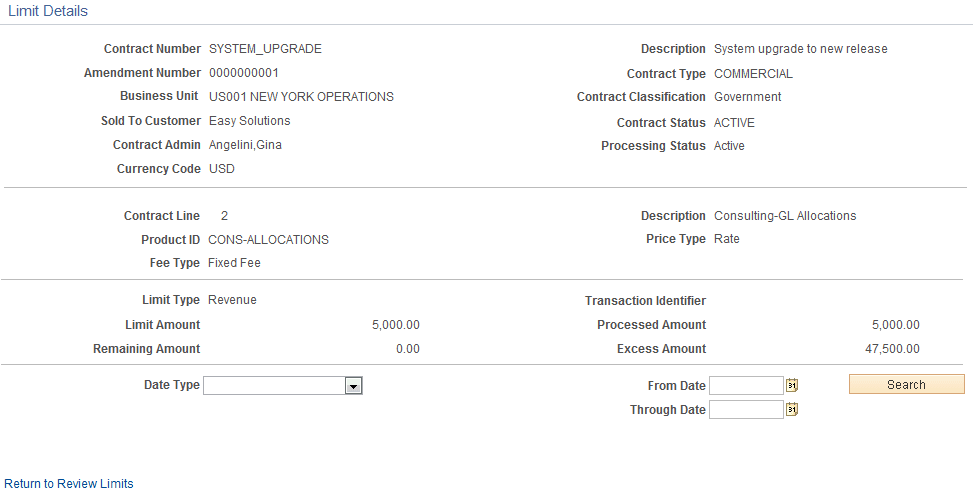

Limit Details Page
Use the Limit Details page (CA_LMT_DETAILS) to review the details of over-the-limit transactions.
Navigation:
Click the value in the Excess Amount column of the Review Limits page.
This example illustrates the fields and controls on the Limit Details Page. You can find definitions for the fields and controls later on this page.
Limit Details Page
Date Type
Select a date type to have the system retrieve all over-the-limit billing and revenue transactions within the specified date range. Date type values include:
  • Acctg Date: Select to display all over-the-limit transactions by transaction accounting date using the date range specified.
  • Trans Date: Select to display all over-the-limit transactions by transaction date using the date range specified.
From Date and Through Date
Select specific from and through dates to have the system retrieve all over-the-limit transactions within the specified date range.
Search
Click to retrieve the over-the-limit transactions that meet your date search criteria.
Transaction Date
Displays the transaction date of the original cost transaction from the feeder subsystem.
Accounting Date
Displays the accounting date of the original cost transaction from the feeder subsystem.
Foreign Amount
Displays the over the limit (OTL) , excess (negative), or reclaimed (when summary limits are used for government contracts) amount for the transaction in the original cost transaction currency.
Projects Business Unit Amount
Displays the transaction OTL, excess (negative), or reclaimed (when summary limits are used for government contracts) amount in the PeopleSoft Project Costing business unit base currency.
