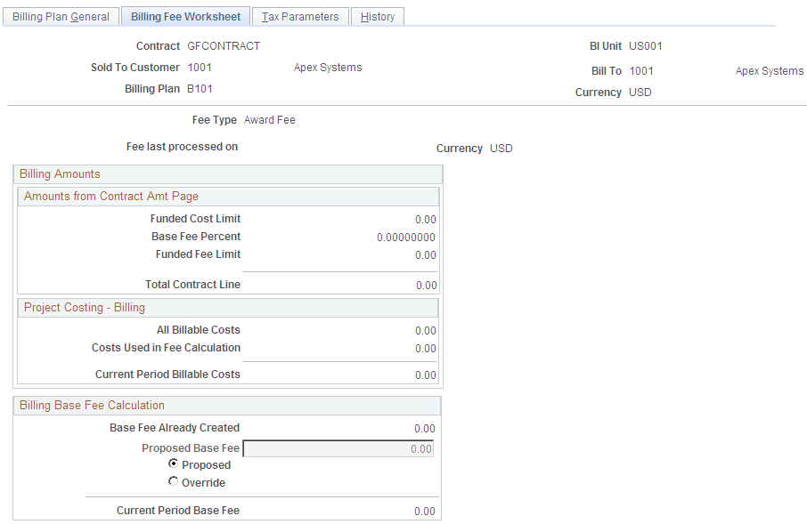

Billing Plan – Billing Fee Worksheet for Award Fee Page
Access the Billing Plan – Billing Fee Worksheet for award fees.
This example illustrates the fields and controls on the Billing Plan – Billing Fee Worksheet page (1 of 2) (award fee type). You can find definitions for the fields and controls later on this page.
Billing Plan - Billing Fee Worksheet page (1 of 2) (award fee type)
Billing Plan - Billing Fee Worksheet page (2 of 2) (award fee type)
When you define a billing plan for a cost-plus contract line associated with a fee type of Award, the system automatically creates a billing plan with a billing fee worksheet containing fields that are specific to award fee processing.
Billing Amounts - Amounts from Contract Amt Page
Field or Control Description
Base Fee Percent
Displays the base fee percentage defined on the Contract Amounts page for the contract line. The billing base fee percent is multiplied by the total funded costs to determine the total funded fee amount.
Billing Base Fee Calculation
Base Fee Already Created
Displays the total to date for all billable base fee rows already created for the contract line.
For this value, the system retrieves the award fee billing rows that are assigned the analysis type specified in the Billing Target Fee Attributes group box on the Fee Definition page for this fee type. The fee definition is defined on the Contracts Business Unit component (BUS_UNIT_TBL_CA).
Proposed Base Fee
Displays the calculated total of all billable cost rows to date for the contract line for which fees have not been created, multiplied by the base fee percentage. You can override this value if needed.
Current Period Base Fee
Displays the billing base fee total for the current period after the fee limits process has run.

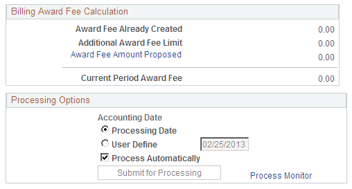

Billing Award Fee Calculation
Award Fee Already Created
Displays the total to date for all billable award fee rows already created for the contract line.
Additional Award Fee Limit
Displays the additional award fee limit percentage entered on the Contract Amounts page for the contract line.
Award Fee Amount Proposed
Displays the calculated total of all billable cost rows to date for the contract line for which fees have not been created, multiplied by the award fee percentage. You can override this value if needed.
Current Period Award Fee
Displays the billing award fee total for the current period after the fee limits process has run.

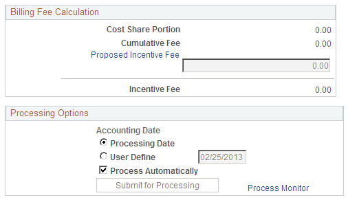

Billing Fee Calculation
Cost Share Portion
Displays the calculated total of the difference amount between the funded cost limit and all available billing cost rows for the contract line multiplied by the cost share percentage to be used. The cost share percentage used is either the underrun or overrun cost share percentage depending on whether the total inception to date billable costs are less than or greater than the funded cost limit amount respectively.
Cumulative Fee
Displays the calculated total of the cost share portion amount plus the target fee amount.
Proposed Incentive Fee
Displays the proposed incentive fee for the contract line. If the actual billable costs to date are less then or equal to the funded cost limit, the system uses the lessor of the cumulative fee amount or the maximum fee amount for the proposed incentive fee. If the actual billable costs to date are greater then the funded costs limit, then the system uses the greater of the cumulative fee amount or the minimum fee amount for the proposed incentive fee.
This amount can be overwritten if needed, but must be within the minimum and maximum fee ranges defined for the contract line.
Incentive Fee
Displays the billing incentive fee total for the current period after the fee limits process has run.

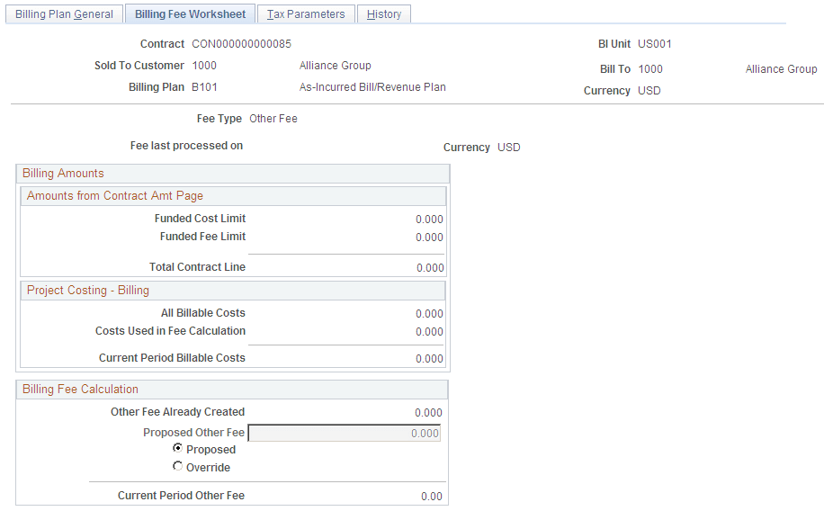

Billing Plan – Billing Fee Worksheet for Other Fee Page
Access the Billing Plan – Billing Fee Worksheet for other fees.
This example illustrates the fields and controls on the Billing Plan - Billing Fee Worksheet page (1 of 2) (other fee type). You can find definitions for the fields and controls later on this page.
This example illustrates the fields and controls on the Billing Plan - Billing Fee Worksheet page (2 of 2) (other fee type). You can find definitions for the fields and controls later on this page.
When you define a billing plan for a cost-plus contract line associated with a fee type of Other, the system automatically creates a billing plan with a billing fee worksheet containing fields that are specific to other fee processing.
Other Fee Already Created
Displays the total to date for all billable other fee rows already created for the contract line.
For this value, the system retrieves the other fee billing rows that are assigned the analysis type specified in the Billing Target Fee Attributes group box on the Fee Definition page for this fee type. The fee definition is defined on the Contracts Business Unit component (BUS_UNIT_TBL_CA).
Proposed Other Fee
Displays the other fee amount entered on the Contract Amounts page for the contract line. This amount can be overwritten if needed.
Current Period Other Fee
Displays the billing other fee total for the current period after the fee limits process has run.

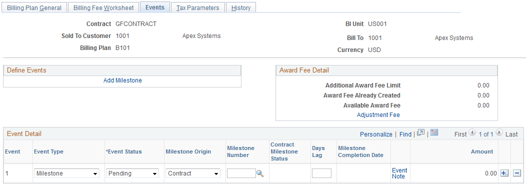

Billing Plan - Events Page for Award Fee Schedule
Use the Billing Plan - Events page (CA_BP_EVENTS) to define billing fee events for award and incentive fee types.
Navigation:
Customer Contracts, and then Schedule and Process Billing, and then Define Billing Plan, and then Billing Plan General, and then Billing Fee Worksheet
Click the Award Fee Amount Proposed or Proposed Incentive Fee link on the Billing Fee Worksheet page.
This example illustrates the fields and controls on the Billing Plan - Events page (award fee schedule). You can find definitions for the fields and controls later on this page.
The award schedule page is used to define events for award fees. The events fields appear when you navigate to the Billing Plan page from the Billing Fee Worksheet for Award fees. You can define milestone or date event types to control the timing of when bills are generated for award fees. You can enter multiple event rows, but only one event can be set to a Ready status at a time.
Award Fee Detail
Displays the additional award fee limit amount defined on the Contract Amounts page for the contract line assigned to this billing plan.
Displays the total for the award fee billing rows created to date for the contract line assigned to this billing plan. This data is retrieved for the Project Costing Project Transaction table.
Available Award Fee
Displays the calculated total of the additional award fee limit less the award fee amount already created.
Adjustment Fee
Click to access the Fee Adjustment page where you can enter a fee adjustment event. Fee adjustments cannot be set to Ready status if a fee event on the Billing Plan - Events page is set to Ready status.

Cumulative/Proposed Fee
Displays the cumulative or proposed fee amount from the incentive fee worksheet.
Minimum Fee Amount
Displays the calculated minimum fee amount from the incentive fee worksheet.
Maximum Fee Amount
Displays the calculated maximum fee amount from the incentive fee worksheet.
Fee Used
Displays the minimum, maximum or cumulative fee amount used by the system for incentive fee billing.
Adjustment Fee
Click to access the Fee Adjustment page where you can enter a fee adjustment event. Fee adjustments cannot be set to Ready status if a fee event on the Billing Plan page is set to Ready status.
Billing Plan – Fee Adjustments Page for Award Fee
Use the Billing Plan – Fee Adjustments page (CA_BP_FEE_ADJ) to enter fee adjustment amounts when fee amounts, percentages, or limits have changed over the life of the contract.
Navigation:
Customer Contracts, and then Schedule and Process Billing, and then Define Billing Plan, and then Billing Plan General, and then Billing Fee Worksheet.
Click the Award Fee Amount Proposed or Proposed Incentive Fee link on the Billing Fee Worksheet page. Click the Adjustment Fee link on the Events page.
This example illustrates the fields and controls on the Billing Plan – Fee Adjustments page (award fee type). You can find definitions for the fields and controls later on this page.
Billing Plan - Fee Adjustments page (award fee type)
The Fee Adjustments page enables you to adjust fee amounts that have been processed. You can enter either a negative or positive amount, up to the fee amount that has been billed to date. Billing fees that have not yet been processed are adjusted using the billing fee worksheet, Proposed Amount field. Adjustments to award fees are not controlled by amendment processing.
Award Fee Details
Displays the total for the additional award fee billing rows created to date for the contract line assigned to this billing plan. This data is retrieved for the Project Costing Project Transaction table.
Available Award Fee
Adjustment Detail
Adjustment
Displays the sequence number automatically assigned to the adjustment row.
Event Status
Select the status of the event. The event status controls the timing of when the event can be processed. Select from the following statuses:
  • Pending: Appears by default when you open the Fee Adjustment page.
    You can enter a fee adjustment row in pending status and edit the fee adjustment amount.
  • Ready: Set the fee adjustment row to Ready status when you are ready to process the adjustment.
    When you run the Contracts/Billing Interface (CA_BI_INTFC) process to generate the adjustment row, the system checks the adjustment amount against the award fee limit. Only one award fee adjustment row can be set to Ready status at any one time. You cannot set an award fee adjustment row to Ready status if an award revenue fee event row is in Ready status.
    Award adjustment rows in Ready status cannot be edited. You must first reset the status to pending to make any changes to the row.
  • Completed: Set by the system when you run the Contracts/Billing Interface process.
    The system processes the billing fee adjustment, creates an adjustment entry on the Award schedule page with a status of Adjustment, and sets the adjustment row to a status of Completed. Award adjustment rows in Completed status can no longer be edited.
Amount
Enter a positive or negative fee adjustment amount. The amount that you enter cannot be greater or less than the fee amount that has been billed to date and cannot exceed the fee limit amount.
