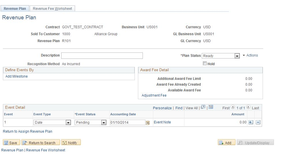

Revenue Plan — Award Fee Schedule Page
CA_ACCTPLAN
Define revenue fee events for award and incentive fee types.

This example illustrates the fields and controls on the Revenue Fee Worksheet page (award fee type). You can find definitions for the fields and controls later on this page.
When you define a revenue plan for a cost-plus contract line associated with a fee type of Award, the system automatically creates a revenue plan with a revenue fee worksheet containing fields that are specific to award fee processing. Award fees are managed using milestone or date events. You define your events using the award schedule.
Billing Base Fee Calculation
Field or Control Description
Base Fee Already Created
Displays the total for the award base fee revenue rows created to date for the contract line. This data is retrieved for the Project Costing Project Transaction table.
Note: For this value, the system retrieves the award base fee revenue rows that are assigned the analysis type specified in the Revenue Target Fee Attributes group box on the Fee Definition page for this fee type. The Fee definition is defined on the Contracts Business Unit component (BUS_UNIT_TBL_CA).
Base Fee Percent
Displays the calculated total of the revenue fee limit divided by the sum of all recognizable costs plus the estimated cost to complete. This amount can be overridden if needed.
Proposed Base Fee
Displays the calculated total of the current period's recognizable costs (all revenue cost rows for the contract line with a blank fee status) multiplied by the revenue base fee percent. You can accept the proposed fee or override it by entering a different fee amount and selecting the Override option.
Note: If you select the processing option of Process Automatically, the system uses the fee amount proposed by the system.
Current Period Base Fee
Displays the award base fee total for the current period after the fee limits process has run.
Revenue Award Fee Calculation
Award Fee Already Created
Displays the total for the additional award fee revenue rows created to date for the contract line. This data is retrieved for the Project Costing Project Transaction table.
Note: For this value, the system retrieves the additional award fee revenue rows that are assigned the analysis type specified in the Revenue Target Fee Attributes group box on the Fee Definition page for this fee type. The fee definition is defined on the Contracts Business Unit component (BUS_UNIT_TBL_CA).
Additional Award Fee Limit
Displays the additional award fee limit based on the amounts defined on the Contract Amounts page for the contract line. You can override this value if needed.
Award Fee Amount Proposed
Displays the calculated total of the current period's recognizable costs (all revenue cost rows for the contract line with a blank fee status) multiplied by the revenue award fee percent.
Current Period Award Fee
Displays the additional revenue award fee total for the current period after the fee limits process has run.

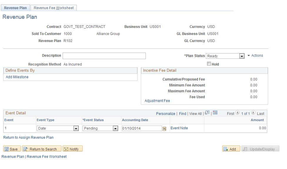

This example illustrates the fields and controls on the Revenue Fee Worksheet page (incentive fee type). You can find definitions for the fields and controls later on this page.
When you define a revenue plan for a cost-plus contract line associated with a fee type of Incentive, the system automatically creates a revenue plan with a revenue fee worksheet containing fields that are specific to incentive fee processing. Incentive fees are managed using milestone or date events. Define your events using the Award Schedule page. When entering in your fee percentages, zero is the lowest value that can be entered.
Revenue Amounts - Amounts from Contract Amt Page
Cost Share Overrun
Displays the cost share overrrun percentage entered on the Contract Amounts page. The overrun percentage is used to adjust the target fee percentage that can be recognized as revenue.
Cost Share Underrun
Displays the cost share underrun percentage entered on the Contract Amounts page. The overrun percentage is used to adjust the target fee percentage that can be recognized as revenue.
Target Fee Percent
Displays the target fee percentage entered on the Contract Amounts page. The target fee percentage is used to calculate the target fee amount.
Target Fee Amount
Displays the calculated total of the revenue cost limit amount multiplied by the target fee percent.
Minimum Fee Percent
Displays the minimum fee percentage entered on the Contract Amounts page. This value represents the minimum fee percentage that can be recognized as revenue for the contract line.
Minimum Fee Amount
Displays the calculated total of the revenue cost limit amount multiplied by the minimum fee percent.
Maximum Fee Percent
Displays the maximum fee percentage entered on the Contract Amounts page. This value represents the maximum fee percentage that can be recognized as revenue for the contract line.
Maximum Fee Amount
Displays the calculated total of the revenue cost limit amount multiplied by the maximum fee percent.
Total Maximum Cont Line Value (total maximum contract line value)
Displays the calculated total of the revenue cost limit amount plus the maximum fee amount.
Project Costing - Revenue
Difference
Displays the calculated total of the revenue cost limit amount less the total actual revenue costs to date for the contract line.
Revenue Fee Calculation
Cost Share To Be Used
Displays the cost share overrun or underrun percentage entered on the Contract Amounts page. If the actual revenue costs from the contract line's inception to date are greater than the revenue cost limit amount, then the cost share overrun percentage is used. If the actual revenue costs from the contract line's inception to date are less than the revenue cost limit amount, then the cost share underrun percentage is used.
Cost Share Portion
Displays the calculated total of the value displayed in the Project Costing-Revenue Difference field multiplied by the percentage in the Cost Share To Be Used field.
Cumulative Fee
Displays the calculated total of the cost share portion plus the target fee amount.
Proposed Incentive Fee
Displays the proposed incentive fee amount calculated by the system for the contract line. If the actual revenue costs to date are less then or equal to the revenue cost limit, the system uses the lesser of the cumulative fee amount or the maximum fee amount for the proposed incentive fee. If the actual revenue costs to date are greater then the revenue costs limit, then the system uses the greater of the cumulative fee amount or the minimum fee amount for the proposed incentive fee.
Incentive Fee
Displays the revenue incentive fee total for the current period after the fee limits process has run.
Access the Revenue Plan page for the award fee schedule.
This example illustrates the fields and controls on the Revenue Plan page (award fee schedule). You can find definitions for the fields and controls later on this page.
The Revenue Plan – Award Schedule page is used to define events for award fees. The events fields appear when you navigate to the Revenue Plan page from the Revenue Fee Worksheet for Award fees. You can define milestone or date event types to control the timing of when revenue is recognized for award fees. You can enter multiple event rows, but only one event can be set to a Ready status at a time, including adjustment fee events.
Before creating an adjustment fee event using this page, all other events defined on this page must have a status of completed or pending.
Award Fee Detail
Displays the additional award fee limit amount defined on the Contract Amounts page for the contract line assigned to this revenue plan.
Displays the total for the award fee revenue rows created to date for the contract line assigned to this revenue plan. This data is retrieved for the Project Costing Project Transaction table.
Available Award Fee
Displays the calculated total of the additional award fee limit less the award fee amount already created.
Adjustment Fee
Click to access the Fee Adjustment page where you can enter a fee adjustment event. Fee adjustments cannot be set to Ready status if a fee event on the Revenue Plan page is set to Ready status.
Revenue Plan — Incentive Fee Schedule Page
Access the Revenue Plan page for the incentive fee schedule.
This example illustrates the fields and controls on the Revenue Plan page (incentive fee schedule). You can find definitions for the fields and controls later on this page.
The Incentive schedule page is used to define an event for incentive fees. The events fields appear when you navigate to the Revenue Plan page from the Revenue Fee Worksheet for incentive fees. You can define a milestone or date event type to control the timing of when revenue is recognized for incentive fees. You can only enter one event row in this schedule, including adjustment fee events.
Incentive Fee Detail
Cumulative/Proposed Fee
Displays the cumulative or proposed fee amount from the incentive fee worksheet.
Minimum Fee Amount
Displays the calculated minimum fee amount from the incentive fee worksheet.
Maximum Fee Amount
Displays the calculated maximum fee amount from the incentive fee worksheet.
Fee Used
Displays the minimum, maximum or cumulative fee amount used by the system for incentive fee revenue.
Adjustment Fee
