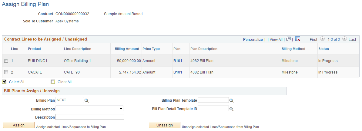

Assign Billing Plan Page
Use the Assign Billing Plan page (CA_BP_LINK) to assign contract products to billing plans.
You can assign products to billing plans that you have previously defined, or you can assign products to a new billing plan and then set up that billing plan in the Billing Plan component.
Navigation:
Customer Contracts, and then Schedule and Process Billing, and then Assign Billing Plan
This example illustrates the fields and controls on the Assign Billing Plan Page. You can find definitions for the fields and controls later on this page.
Contract Lines to be Assigned / Unassigned
Field or Control Description
(select)
Select the check box next to the contract lines that you want to assign to a contract. You can only select those products with a pricing structure compatible with the billing method that you selected. When you click the Assign button, this contract line is assigned to the contract. Also use this field to select products that you want to unassign from a contract. Select the check boxes next to the individual lines that you want to unassign, and then click the Unassign button.

Billing Plan to Assign / Unassign
Billing Plan
You can either assign contract lines to an existing billing plan with a status of Pending or select NEXT to assign the selected lines to a new billing plan. This field is for assigning purposes only.
Billing Method
Select a method for the billing plan that you are assigning (or that you are creating). Billing method values are: As-incurred, Value-based, Milestone, Percent Complete, Immediate, and Recurring.
Note: If you are assigning prepaids to a billing plan, the prepaid can only be assigned to Milestone, Percent Complete, and Immediate billing methods.
Billing Plan Template
To use a billing plan template, select a contract line from the Contract Lines to be Assigned/Unassigned group box, and then select a bill plan template. When you click Assign, the system builds the billing plan and billing plan lines as specified by the template.
Note: If you want to assign a billing plan template with a basis date source option of Contract Line Start Date to the selected contract lines, you must have already defined the start date for the contract lines on the Contract - Lines page. If you select multiple contract lines with the same start date and select a billing plan template with the basis date source option of Contract Line Start Date, the system assigns the contract lines to the same billing plan. If you have multiple contract lines with different start dates and you want to use a billing plan template with the basis date source option of Contract Line Start Date, you must assign separate billing plan templates to the individual contract lines.
Bill Plan Detail Template ID
To use a billing plan detail template, select a contract line from the Contract Lines to be Assigned/Unassigned group box, select a billing plan template, and select a billing plan detail template. When you click Assign, the system builds the billing plan and billing plan lines as specified by the billing templates.
Assign
Click this button to assign the contract lines that you selected to the billing plan that you selected.
If the contract lines selected had previously been associated with billing plan lines from another billing plan, the system deletes the billing plan lines. If additional contract lines (aside from the ones selected) had been previously assigned to the billing plan line in question, these too are unassigned and the system generates a message notifying you that this has occurred.
Note: You cannot assign Value-based billing plans to rate-based contract lines for which prepaid utilization criteria applies. This prepaid utilization criteria is defined on the Utilization Criteria page.
Note: You cannot assign a Value-based billing plan to a rate-based line for which a retainage or discount ID was defined on the Related Projects page.
Note: You can only assign Recurring billing plans to contract lines with a recurring price type.
Unassign
Click this button to unassign the contract lines that you selected from the billing plan ID to which they are assigned. When you click Unassign, the system deletes any billing plan lines that it had created for the detail lines that you selected.
