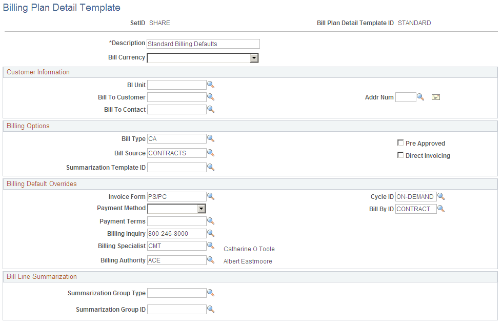

This example illustrates the fields and controls on the Billing Plan Detail Template page. You can find definitions for the fields and controls later on this page.

When you start to create a new billing plan detail template, all fields are blank. Use this page to override the billing defaults that you defined for this contract's business unit on the Contracts Definition - Defaults and the Contract General - Billing Options pages. If you specify values on this page, they will override the billing defaults. If you do not want to override your billing defaults, do not enter any information on this page.
If a value from the billing plan detail template is not valid on the billing plan, then the system will use the default value from the contract.
Field or Control Description
Bill Plan Detail Template ID
Displays a unique identifier for the billing plan template.
Bill Currency
Currency code of the invoices that are generated for this billing plan.
Customer Information
BI Unit (PeopleSoft Billing business unit)
Select a billing business unit from the list of valid values. The list of valid values contains only those billing business units that share the same PeopleSoft General Ledger business unit as the billing plan's PeopleSoft Contracts business unit.
Bill To Customer
Select the customer to whom the invoice will be sent.
Address Num (address sequence number)
Select the customer address to which the invoice will be sent.
Bill To Contact
Select the person to whose attention the invoice will be addressed.
Billing Options
Bill Type
Select the bill type used by PeopleSoft Billing to categorize the activity being billed.
Bill Source
Select where the billing activity came from. The system associates default billing information with that billing activity.
Summarization Template ID
Select the summarization template ID that will appear by default on the billing plan. When the billing plan is processed, PeopleSoft Contracts passes the template ID to PeopleSoft Billing using the Contracts/Billing Interface process. The summarization template defines the summarized format in which the bill lines will print on the invoice.
Pre Approved
Select to bypass the billing worksheet review/approval process. Selecting this check box sends the invoices directly to billing without first creating a temporary bill. Selecting this check box does not run the invoice generation process within PeopleSoft Billing.
Note: If you select the Pre Approved check box and do not select the Direct Invoicing check box, the system bypasses the temporary invoice and creates a bill in NEW status based on the Bill By Identifier setup.
Note: If you do not select the Pre Approved check box, the system creates a temporary invoice. You must manually approve the bill in the billing worksheet before the system creates the invoice in RDY status.
Direct Invoicing
Select to have the Contracts to Billing interface run various PeopleSoft Billing processes to complete the invoice processing.
This check box is available if you selected the Pre Approval check box for this bill plan ID.
See Direct Invoicing and Preapproved Activity.
Billing Default Overrides
Invoice Form
Specify the invoice format for the bills that you generate from this billing plan.
Payment Method
Select the type of payment method, such as Check, Credit Card, Direct Debit, Draft, or Electronic Fund Transfer.
Payment Terms
Enter the payment terms. These values are user-defined.
Billing Inquiry (billing inquiry phone)
Select a bill inquiry phone number. This number is established on the Bill Inquiry Phone page.
Billing Specialist
Select a billing specialist from those that were established on the Billing Specialist page. An example of a billing specialist is a functional user whose daily job includes filling out billing plans.
Billing Authority
Select a billing authority, which is a billing specialist who is responsible for approving invoices. This person might be a manager who is not necessarily the person responsible for entering bills daily. To indicate that a billing specialist is a billing authority, select the Billing Authority Flag option for the corresponding bill specialist on the Billing Specialist page.
The field appears for As Incurred billing plans only, such as those used in PeopleSoft Grants.
Cycle ID (billing cycle identifier)
Select a value to associate a billing plan with a bill cycle that you defined on the Bill Cycle page. When you run the Contracts Billing Interface process, you can specify that only billing plans of a specific billing cycle type be processed.
Bill By ID
Select a value to group bill lines on invoices.
Bill Line Summarization
Summarization Group Type
Select a summarization group type to appear by default on the billing plan lines page for immediate, milestone, and percent complete billing plans. Summarization group types filter the summarization group identifiers that are available for selection.
Note: Summarization group types must be included as an attribute in the summarization template setup before PeopleSoft Billing can create summarized billing plan lines.
Summarization Group ID
Select an identifier that is associated with the summarization group type selected to appear by default on the billing plan lines page for immediate, milestone, and percent complete billing plans. Billing plan lines assigned to the same summarization group ID attribute will be summarized by PeopleSoft Billing on the invoice.
Note: Summarization group IDs must be included as an attribute in the summarization template setup before PeopleSoft Billing can create summarized billing plan lines.
