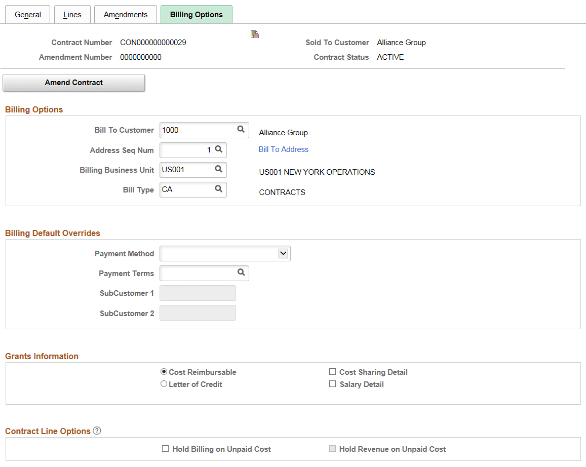

Use the Billing Options page (CA_HDR_BILLOPT) to enter billing option defaults for the contract.
These billing options appear by default on the billing plans created for contract lines within this contract. You can override these options at the billing plan level.
Navigation:
Select Billing Options in the Go To drop-down list box on any page in the contract component.
This example illustrates the fields and controls on the Billing Options Page. You can find definitions for the fields and controls later on this page.
PeopleSoft Billing uses a hierarchical system of defaults to determine billing options. The billing plan is the most specific level of this hierarchy and where you specify billing options that are not overridden by defaults at a higher level. If the billing options do not change from one contract to the next for the business, then you can take full advantage of the hierarchical system of defaults that you set up in PeopleSoft Billing without having to further define these values on the contract's billing plans.
The Contracts Billing Options page is a place to enter defaults that are copied to all new billing plans created for the contract. This enables you to avoid having to repeat the same entry of billing option default overrides on multiple billing plans for the same contract.
Many of the values that you define here are defaults that you can override on the Billing Plan - Billing Plan General page. Fields that are left blank at the billing plan level are completed by default from a higher level within the PeopleSoft Billing system of defaults on bills.
Billing Options
Field or Control Description
Bill To Customer
The default ID for the bill to customer appears by default in the customer field. You can select a different bill to customer ID.
Note: For contracts with a contract classification of Internal, you must select an interunit bill to customer for this field.
Bill To Address
Click to view the address and contact associated with the address sequence number.
Billing Business Unit
Appears by default from the value that you specified for the contract business unit. You can select a different PeopleSoft Billing business unit. Only PeopleSoft Billing business units pointing to the same PeopleSoft General Ledger business unit as the PeopleSoft Contracts business unit appear in the list of valid values.
Bill Type
The ID appears by default from the value that you specified for the PeopleSoft Contracts business unit, and is used by PeopleSoft Billing to categorize the activity being billed. You can override the bill type on the billing plan.
Billing Default Overrides
Payment Method
Indicates the type of payment, including Check, Credit Card, Direct Debit, Draft, and Electronic Fund Transfer.
Payment Terms
Indicates the terms to which the customer should adhere when making a payment of invoices from PeopleSoft Billing.
SubCustomer 1 and SubCustomer 2
Values for these fields appear by default according to the subcustomer information defined for the bill to customer. Subcustomers enable you to record history and aging information for a subset of the business with a customer or for a cross-section of the business across different customers. The values that you select for SubCustomer 1 and SubCustomer 2 cannot be overridden at the billing plan level.
