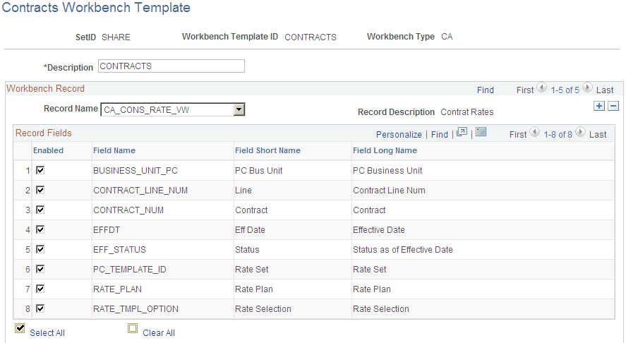

This example illustrates the fields and controls on the Contracts Workbench Template page. You can find definitions for the fields and controls later on this page.
Use this page to define templates for the Contracts Workbench. PeopleSoft delivers three pre-defined templates: CONTRACTS, GRANTS, and PROJECTS.

Workbench Record
Field or Control Description
Record Name
Select a PeopleSoft record name for PeopleSoft Contracts, Grants, or Project Costing. The record names that are available to choose from are predefined by PeopleSoft. When you select a record, the system displays all fields for that record in the Record fields section of the page. The records that are available from PeopleSoft Contracts are:

Enabled
Select to indicate that this field should be displayed in the Contracts Workbench. This occurs when this template is selected in the Workbench Template ID field on the Contracts Definition – Defaults page for the business unit.
