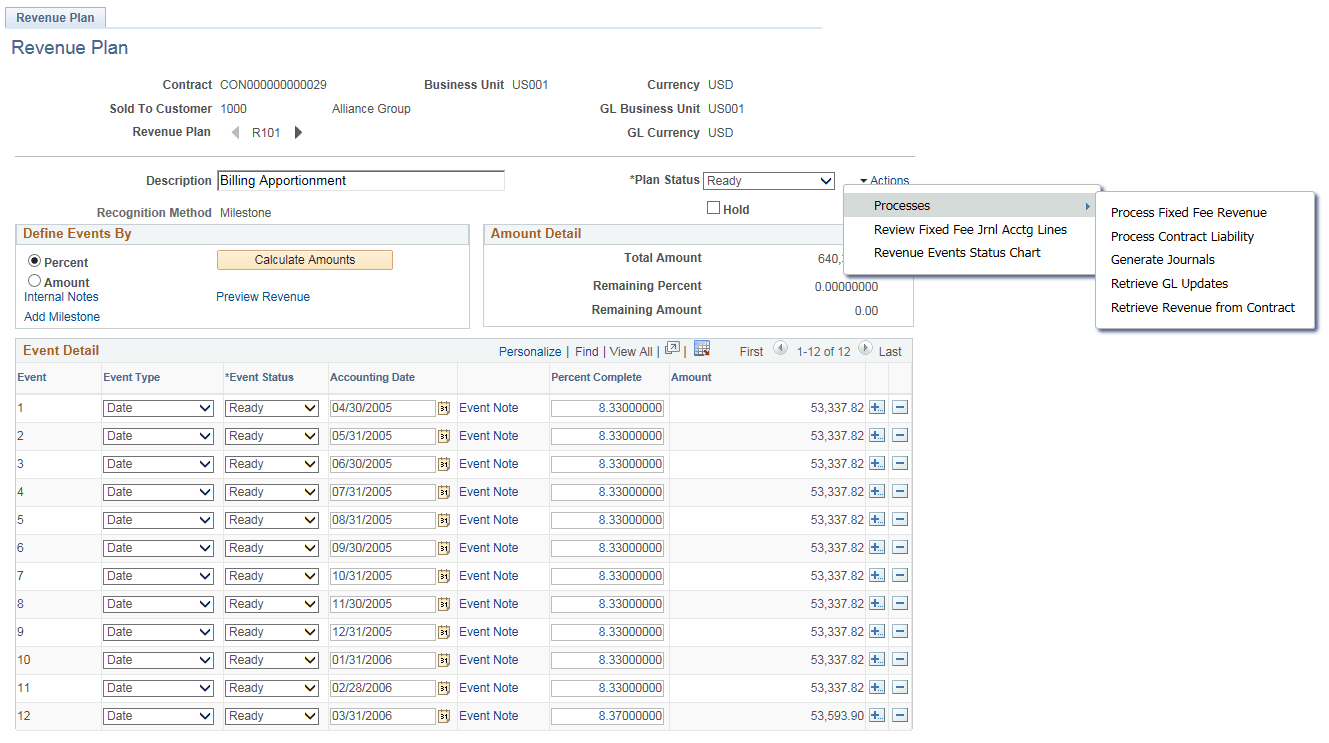

Revenue Plan Page
Use the Revenue Plan page (CA_ACCTPLAN) to define a revenue plan for contract lines in which revenue is managed by PeopleSoft Contracts.
Navigation:
Customer Contracts, and then Schedule and Process Revenue, and then Define Revenue Plan, and then Revenue Plan
This example illustrates the fields and controls on the Revenue Plan page. You can find definitions for the fields and controls later on this page.
Revenue Plan page
Defining a revenue recognition event is optional for revenue plans with a revenue recognition method of As-incurred. If you choose to define an event, the as-incurred revenue recognition method limits you to one Ready event at a time.

Build Event Example 1 – If you want 12 monthly events to be created with From Dates on the first of the month, To Dates on the last of the month, and Accounting Dates on the last of the month:
  1. Set the Future Period Accounting Date option on the Contracts Definition – Processing Options page to Last Day in Accounting Period.
  2. Use a schedule with the Day of the Month set to 1 and the Last Day of the Month option cleared.
  3. Enter a Start Date of the first day of the month and year desired.
  4. Enter an End Date of the last day of the month and year desired.
  5. Enter 12 as the number of periods.
  6. Click Build Event.
Build Event Example 2 – If you want 11 monthly events to be created with From Dates on the first of the month, To Dates on the last of the month, 2 partial events to be created to complete the year, and all Accounting Dates on the first day of the month:
  1. Set the Future Period Accounting Date option on the Contracts Definition – Processing Options page to First Day in Accounting Period.
  3. Enter the desired Start Date, which will be something other than the first day of the month.
  4. Enter the desired End Date, which will be something other than the last day of the month.
  5. Enter 13 as the number of periods.

If you chose to define events by amount, enter the specific amount for this event. If you defined events by percent, this value equals the total amount multiplied by the value entered in the Percentage field. This field is not available for As-incurred revenue plans.
  • For milestone revenue plans, if you chose to define events by amount, enter the specific amount for this event.
    If you defined events by percent, this value equals the gross amount multiplied by the value entered in the Percentage field.
  • For apportionment revenue plans, this field displays the revenue amount to be booked by this event.
    If this event was generated with an apportionment parameters method of Amount, you can edit this value. When you update this field, the system recalculates the values for this account plan in the Remaining Percent and Remaining Amount fields. If this event was generated with an apportionment parameters method of Percent, you cannot edit this value.
  • For percent complete revenue plans, this field displays the revenue amount to be booked by this event.
Amendment Amt
Displays the sum total of any amendments that impact the revenue plan. The system prorates the amount over the events that have occurred.
Incremental % Complete
This field is only updated once revenue for an existing row has been booked. For example: If event 1 is 50% and event 2 is 75%, then 50% and 25% (75–50 is the increment for event 2) appear in this column. This field is for Percent Complete revenue plans only.
From Date
Displays the start date of the proration period for this event. This field is for Apportionment revenue plans only.
To Date
Displays the end date of the proration period for this event. This field is for Apportionment revenue plans only.
