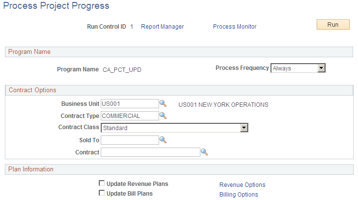

Process Project Progress Page
Use the Process Project Progress page (RUN_CA_PCT_UPD) to run the Project Progress (percent complete update) process for one or more billing or revenue plans at the same time.
This process updates the project progress of your percent-complete revenue and billing plans for amount-based contract lines.
Navigation:
Customer Contracts, and then Update Contract Progress, and then Process Project Progress
This example illustrates the fields and controls on the Process Project Progress page. You can find definitions for the fields and controls later on this page.
Program Name
Field or Control Description
Program Name
CA_PCT_UPD displays.
Contract Options
Use the fields in this group box to limit the data that is included in the run of this process. Filter by PeopleSoft Contracts business unit, contract type, contract classification, sold to customer, or contract number. If you leave all fields blank, the process picks up all available percent complete activity in PeopleSoft Contracts.
Plan Information
Update Revenue Plans
Select this check box to updated revenue plans only.
Revenue Options
Click to specify revenue filters for the Project Progress process.
Update Bill Plans
Select this check box to update billing plans only.
Billing Options
Click to specify billing filters for the Project Progress process.
