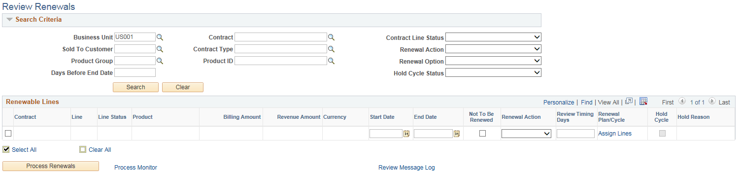

This example illustrates the fields and controls on the Review Renewals Page. You can find definitions for the fields and controls later on this page.

Search Criteria
Use the fields in the Search Criteria group box to filter your search results by entering specific values in these fields. If you leave all fields blank, the search returns all renewable contract lines from active contracts within your system. Results appear in the Renewable Lines scroll area.

Renewable Lines
Field or Control Description
(select)
Select the check box next to a renewable contract line to signify that you want to include this contract line in renewal processing. Processing occurs when you click the Process Renewals button.
