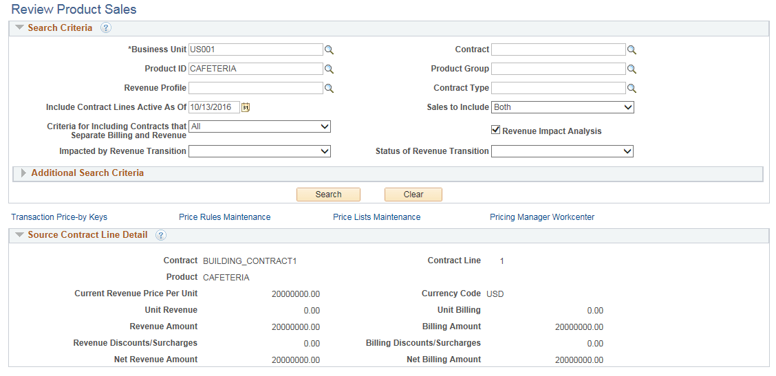

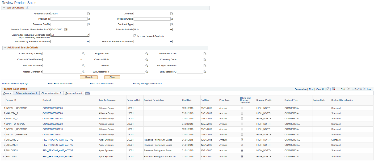

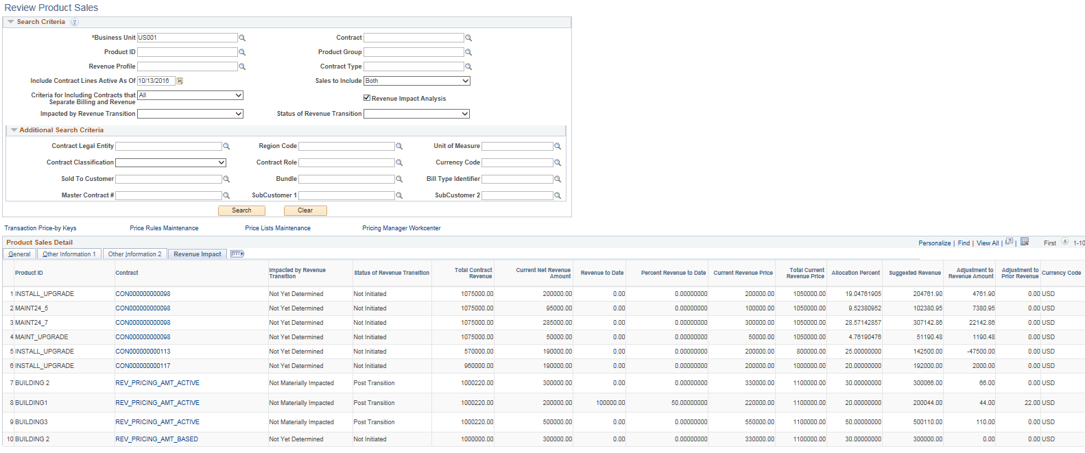

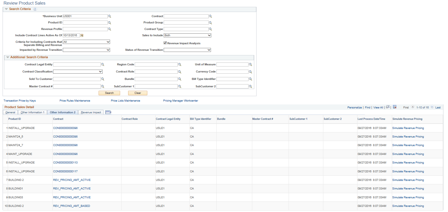

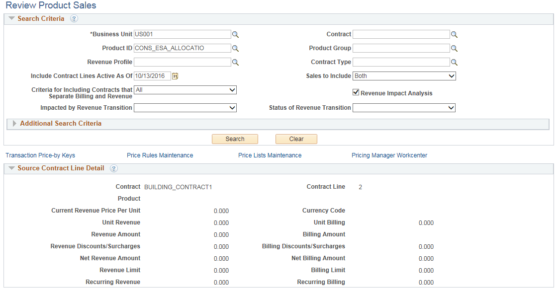

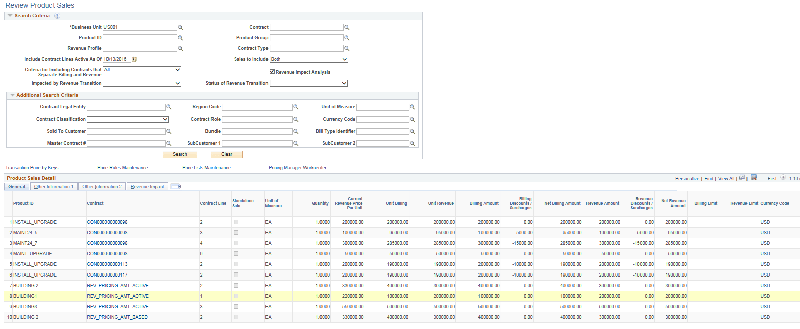

Review Product Sales Page
CA_RVW_PRD_SLS_PNL
Review billing and revenue pricing details for products sold across the organization. Used to help identify a product’s standalone sales price.

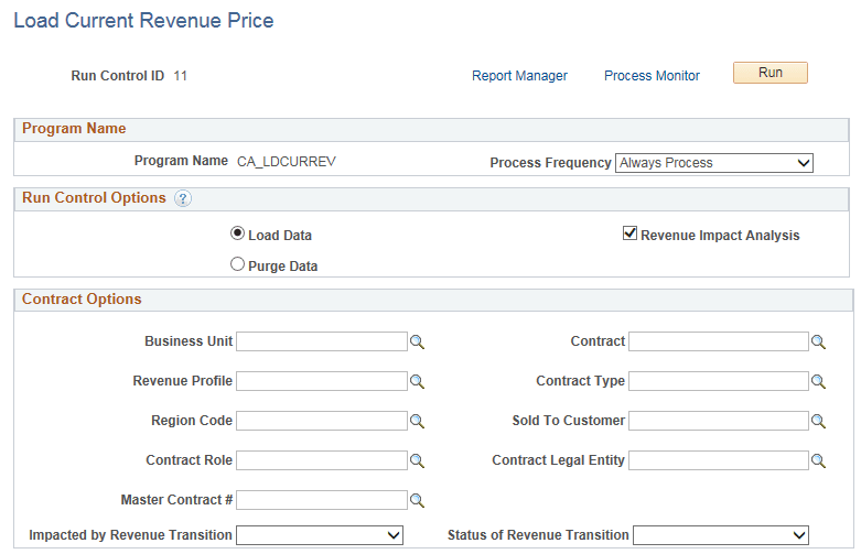

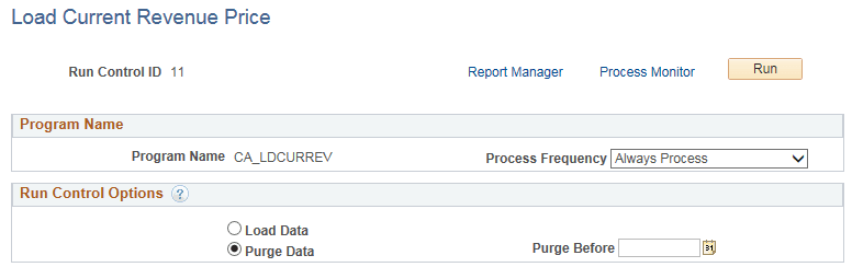

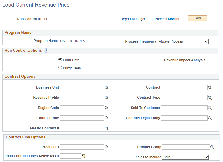

Load Current Revenue Price Page
RUN_CA_LD_CUR_REV
Use this process to populate the Review Product Sales page.

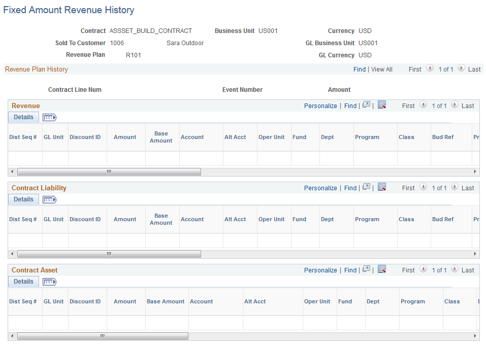

Fixed Amount Revenue History Page
CA_AP_EVENT_DTL
Review details for revenue, contract liability, and contract asset for PeopleSoft Contracts fixed-amount accounting activities recorded in GL.

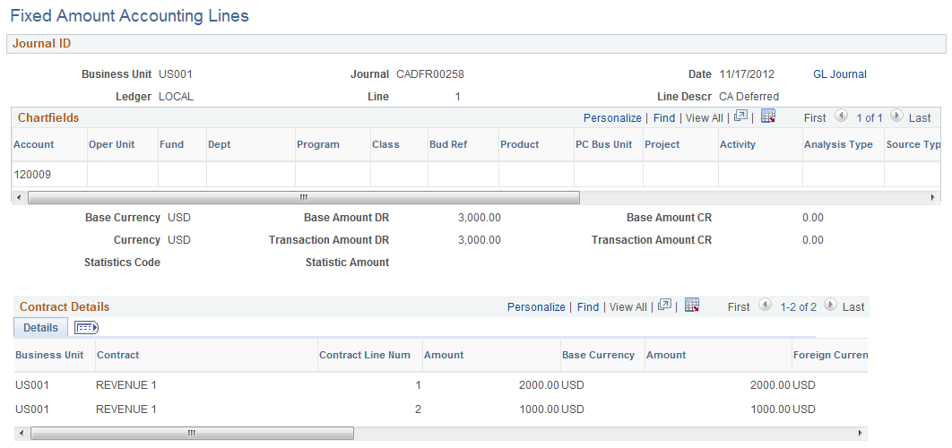

Fixed Amount Accounting Lines Page
CA_ACCT_LINE_JRNL
Inquire about the details of each journal entry after you have run the Contracts Fixed Amounts Revenue process and your accounting entries have gone through the Journal Generator process and have posted to the GL.

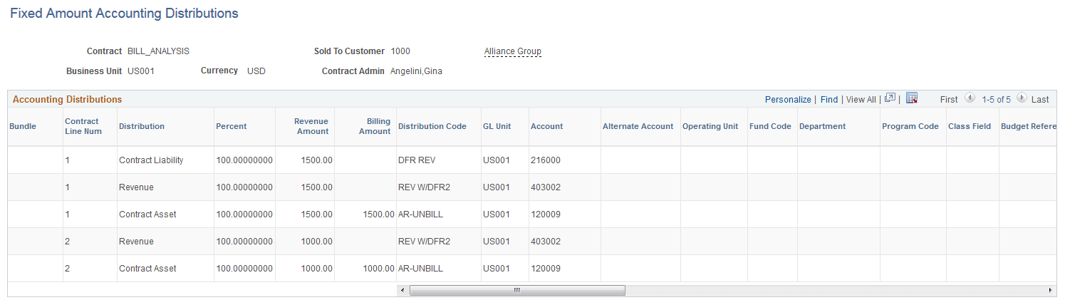

Fixed Amount Accounting Distributions Page
CA_RECON_FF_DIST
Review the accounting distribution on amount based contract lines.

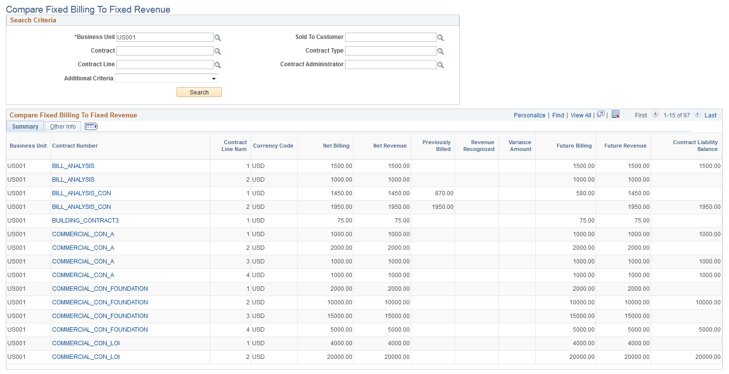

Compare Fixed Billing To Fixed Revenue Page
CA_RECON_FF_SUM
Compare fixed billing and fixed revenue values for contracts.

Revenue History
The Fixed Amount Revenue History page enables you to view the accounting distributions of the amounts that have been booked for all fixed amount revenue plans for which PeopleSoft Contracts is managing revenue. The amount-based revenue process loads this page with accounting information for the fixed-amount contract lines associated with apportionment, milestone, and percent complete revenue plans.
The data source for the Fixed Amount Revenue History page is the CA_AP_DST, CA_AP_DFR, and CA_AP_UAR tables.
The accounting distributions for fixed-amount revenue plans is real-time information, because all revenue information for these contract lines is stored within PeopleSoft Contracts.
WARNING:
You should not make any revenue adjustments to the contract lines for fixed-amount revenue plans outside the PeopleSoft Contracts system (for example, in PeopleSoft Billing, Receivables, or General Ledger), as these changes will not flow back into PeopleSoft Contracts.

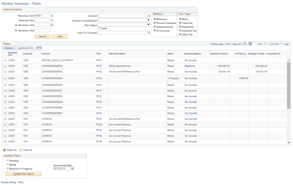

Review Revenue - Plans Page
Use the Review Revenue - Plans page (CA_AP_MANAGE1) to view revenue plan activity, both pending and recognized amounts, for any cross-section of the PeopleSoft Contracts system.
Update revenue plan status to Pending, Ready, or Reversal in Progress.
Navigation:
Customer Contracts, and then Review Revenue, and then Plans
This example illustrates the fields and controls on the Review Revenue - Plans Page. You can find definitions for the fields and controls later on this page.
Search Criteria
Use the fields in the Search Criteria group box to filter your search results by entering specific values in these fields. If you leave all fields blank, the search returns all revenue plans for all Pending and Ready contracts within your system. Results appear in the Revenue Detail scroll area. The system summarizes the results by revenue plan ID, and it displays amounts in the contract or transaction currency. In the case of any as-incurred revenue plans, a row appears for every transaction currency found within a revenue plan.
You must enter a value in the Business Unit field.
Method
Selecting the check box of a revenue recognition method limits your search to include only those revenue plans with a recognition method equal to the recognition methods that you selected. If you leave all check boxes deselected, the system returns all revenue plans matching the rest of your search criteria. Values include: Milestone, Percent Complete, Apportionment, and As Incurred.
Fee Type
To view revenue plans, you must select a value of None in the Fee Type group box. For contracts with a classification of Government, you can select other values in this field.
Plans: General Tab
Field or Control Description
(check box)
Select if you want to update the status for this revenue plan to Pending, Ready, or Reversal in Progress. Depending on your selection in the Update Plans group box, when you click the Update Plan Status button, the system updates the status of the revenue plan.
Plan
Click this link to review and update revenue plan events or place the entire revenue plan on hold.
Status
Displays the status of the revenue plan. The status controls the processing that can occur against a revenue plan.
Revenue Method
For revenue plans with a revenue recognition method of Apportionment, Milestone, and % Complete, click to access the Review Revenue - Events page, where you can view and update the status of events or projects associated with the revenue plan.
For revenue plans with a revenue recognition method of As Incurred, click to access the Review Revenue - As Incurred page, where you can review booked revenue and redistribute revenue.
Revenue Amount (total amount)
Displays the total revenue amount for the revenue plan associated with the contract.
Amt Recog (amount recognized)
Amount of revenue that has been recognized to date for this revenue plan. Click the link to view the accounting entries made for this amount.
This link does not appear for revenue plans with a revenue recognition method of As Incurred.
Pending Amount
Displays the pending revenue amount, which is the total amount minus the amount recognized.
Processed On
Displays the last time the revenue was processed for the plan.
Update Plans
The status for each row in the Search Results half of the page can be changed from Ready to Pending or from Pending to Ready. You can update the status of multiple revenue plans at the same time by selecting the new status (either Pending or Ready), selecting the check box next to the appropriate revenue plans, clicking the Update Plan Status button, and saving. You also use this group box to reverse revenue plans.
Pending
Select to update the status of the selected Ready event to Pending.
Ready
Select to update the status of the selected Pending event to Ready.
Select to reverse a revenue plan. You can reverse plans in a status of In Progress or Completed only.
Accounting Date
Enter a date for the system to use as the accounting date for the reversing entries.
Update Plan Status
Click to update the revenue plan status of the selected contract lines in the Revenue Detail: General tab with the Pending, Ready, or Reversal in Progress status that you selected. If you selected the Reversal in Progress option, clicking this button initiates the reversal for the revenue plan.
Plans: Additional Info Tab
Select the Additional Info tab.
Redistrib (redistribute revenue)
Click this link to redistribute revenue for this revenue plan to a different set of PeopleSoft General Ledger ChartFields.
Review Billing - Plans
Click the Review Billing - Plans link to access the Review Billing - Plans page.

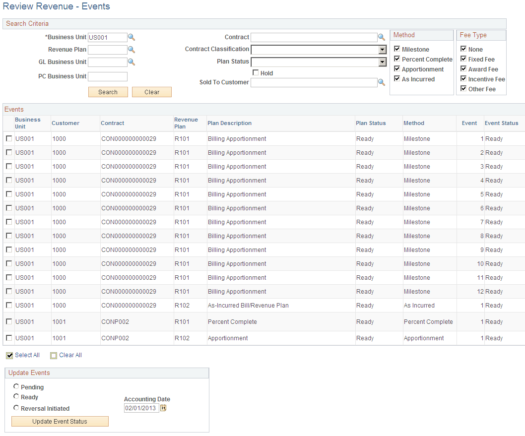

Review Revenue - Events Page
Use the Review Revenue - Events page (CA_AP_MGMT_EVENTS) to by event, view amounts that have been recognized to date and are pending.
You can update the status for an event, reverse the revenue that was booked for an event, and navigate to the Revenue Plan page.
Navigation:
Customer Contracts, and then Review Revenue, and then Review Revenue Events
This example illustrates the fields and controls on the Review Revenue - Events page. You can find definitions for the fields and controls later on this page.
Search Criteria
Use the fields in the Search Criteria group box to filter search results by entering specific values in these fields. If you leave all fields blank, the search returns all revenue plan events for all Ready and Pending contracts within your system. Search results appear in the Revenue Detail scroll area. Amounts appear in the contract or transaction currency. In the case of any as-incurred revenue plan events, a row appears for every transaction currency found within a revenue plan event.
Method
Fee Type
To view revenue plan events, you must select a value of None in the Fee Type group box. For contracts with a classification of Government, you can select other values in this field.
Events
(check box)
Select if you want to update the status for this revenue event to Pending, Ready, or Reversal Initiated. Depending on your selection in the Update Events group box, when you click the Update Event Status button, the system updates the status of the revenue event.
Revenue Plan
Displays the revenue plan associated with the revenue event.
Plan Status
Method
Displays the revenue recognition method associated with the revenue event.
Event
Displays the event number for this revenue recognition event. Each revenue plan contains one or more revenue plan events. Revenue plan events depict how much revenue to recognize based on the revenue plan event status.
Event Status
Displays the event status for the revenue event. Controls your ability to enter information for, and the processing that occurs against, an event. Available revenue plan event statuses are: Pending, Ready, In Progress, Completed, and Reversed. Pending and Ready are the only statuses that you can set manually. Other statuses are set as a result of a system process.
Hold
Indicates whether this revenue event is tied to a revenue plan that has been placed on hold.
Hold Date
Displays the date on which the revenue plan was put on hold, if this revenue event is tied to a revenue plan that has been placed on hold.
Amount
Displays the total amount for the revenue recognition event associated with this row.
Update Events
The status for each row in the Search Results half of the page can be changed from Ready to Pending or from Pending to Ready. You can update the status of multiple revenue plan events at the same time by selecting the new status (either Pending or Ready), selecting the check box next to the appropriate revenue plans, clicking the Update Plan Status button, and saving. You also use this group box to reverse revenue plan events.
Pending
Ready
Reversal Initiated
Select to reverse events. You can reverse events in a status of In Progress or Completed only.
Note: You cannot events on Percent Complete revenue plans.
Accounting Date
Update Event Status
Click to update the event status of the selected contract lines Events group box with the pending, ready, or reversal initiated status that you selected. If you selected the Reversal Initiated option, clicking this button initiates the reversal for the revenue event.

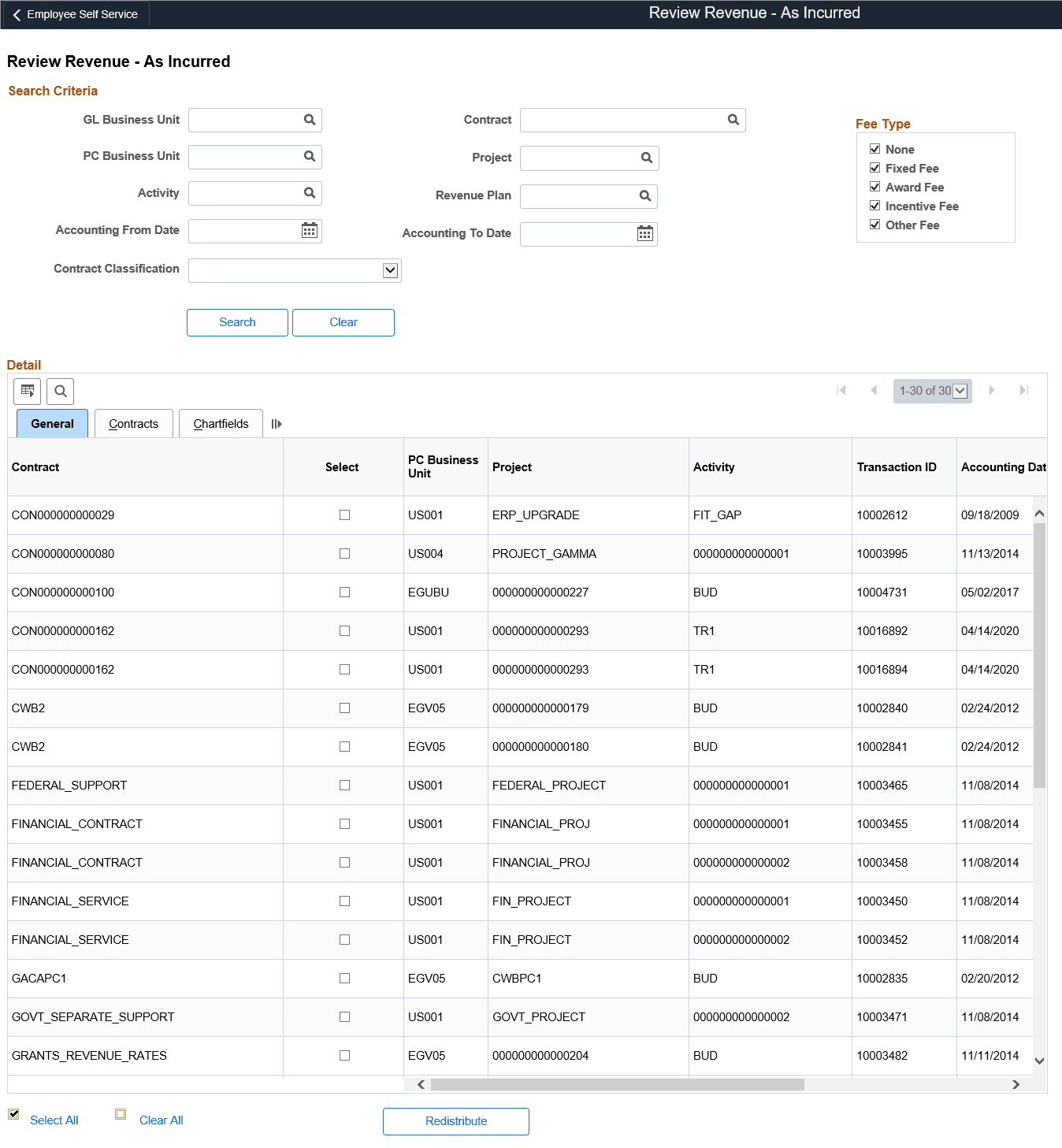

Review Revenue - As Incurred Page
Use the Review Revenue - As Incurred page (CA_AP_DTL_ASIN) to inquire about the details for revenue plans with an as-incurred revenue recognition method.
From this page, you can review the details of the revenue that has been booked and redistribute that revenue.
Navigation:
  • Customer Contracts, and then Review Revenue, and then Review As Incurred Revenue
  • Click the Method link for a specific revenue plan on the Review Revenue - Plans page.
This example illustrates the fields and controls on the Review Revenue - As Incurred page. You can find definitions for the fields and controls later on this page.
Review Revenue As Incurred
Search Criteria
Use the fields in the Search Criteria group box to filter search results by entering specific values in these fields. If you leave all fields blank, the search returns all revenue plans for all Active contracts within your system. Click the Search button to carry out a search based on the search criteria that you entered. Search results appear in the Details scroll area. Amounts appear in the contract or transaction currency. For as-incurred revenue plan events, a row appears for every transaction currency found within a revenue plan event.
Fee Type
To view as incurred revenue, you must select a value of None in the Fee Type group box. For contracts with a classification of Government, you can select other values in this field.
Detail: General Tab
(check box)
Select this check box if you want to redistribute the revenue that has been booked for a row.
Select All
Select this check box to select all the rows for redistribution.
Clear All
Select this check box to clear all the selected rows for redistribution.
Redistribute
Click this button to redistribute the revenue for the rows that you selected on the General tab of the Detail scroll area.
For each matching row, the system creates a reversal row with a new sequence number and the existing key values. The system also creates another row with a new sequence number, and new set of redistribution ChartField values specified by the user.
Use the Review Product Sales page (CA_RVW_PRD_SLS_PNL) to review billing and revenue pricing details from contracts across the organization including comparison with the Current Revenue Price for the product as defined in Order Management and the Enterprise Pricer.
This comparison of product prices on historical contract sales to the current revenue price provides users with a basis to change (or retain) the current revenue price for a product. The decision to change or retain a product’s revenue price impacts pricing and revenue allocation on future contracts. This page can be accessed via Related Actions on several pages.
This page can be used to review products sold on a standalone basis, as defined by the Standalone Sale check box on the contract line, and/or it can be used to review sales of products on other contract lines, NOT identified as a standalone sale. See Defining Contract Lines
To assist with the transition of contracts to the new revenue accounting standard, use this page to review the potential impact of new revenue pricing on your existing contract base.
Navigation:
  • Customer Contracts, and then Review Revenue, and then Review Product Sales
  • Customer Contracts, and then Create and Amend, and then General Information, and then Contract - Lines. Select Review Product Sales from the Related Actions menu for the contract line.
  • Customer Contracts, and then Determine Price and Terms, and then Amount Allocation, and then Revenue Allocation. Select Review Product Sales from the Related Actions menu for the contract line.
  • Customer Contracts, and then Determine Price and Terms, and then Amendment Amount Allocation, and then Amendment Revenue Allocation. Select Review Product Sales from the Related Actions menu for the contract line.
This example illustrates the fields and controls on the Review Product Sales page. You can find definitions for the fields and controls later on this page.
This example illustrates the fields and controls on the Review Product Sales page — From Actions Menu on an Amount Based line. You can find definitions for the fields and controls later on this page.
Review Product Sales page From Actions Menu on an Amount Based line
This example illustrates the fields and controls on the Review Product Sales page — From Actions Menu on a Rate Based Line. You can find definitions for the fields and controls later on this page.
Review Product Sales page From Actions Menu on an Rate Based line
Business Unit
Enter required Business Unit. If this page is accessed via the Related Actions then the Business Unit of the source contract is defaulted to this field.
Product ID
Enter Product ID. If this page is accessed via the Related Actions then the Product ID of the source contract line is defaulted to this field. To review multiple products across the business unit, leave product blank.
Include Contract Lines Active As Of
Enter suitable date. This field is populated with the current date initially.
Sales to Include
Select from the given options:
  • Both — Includes all contract lines irrespective of Standalone Sale check box on the contract line. This is the default value.
  • Other Sales — Includes other contract lines where the Standalone Sale check box is not selected.
  • Standalone Sales — Includes all contract lines where the Standalone Sale check box is selected.
Criteria for Including Contracts that Separate Billing and Revenue
  • All — Include all contract lines irrespective of whether the Separate Billing and Revenue option is selected or not.
  • Not Separated — Includes contract lines where neither Separate Fixed Billing and Revenue nor Separate As Incurred Billing and Revenue check boxes are selected.
  • Separated on As Incurred Lines — Includes contract lines for where Separate As Incurred Billing and Revenue check box is selected and Separate Fixed Billing and Revenue is not selected.
  • Separated on Both — Includes contract lines where both Separate Fixed Billing and Revenue and Separate As Incurred Billing and Revenue check boxes are selected.
  • Separated on Fixed Lines — Includes contract lines where Separate Fixed Billing and Revenue check box is selected and Separate As Incurred Billing and Revenue check box is not selected.
Impacted by Revenue Transition
Use this criteria to filter contracts with a particular impact. Values are:
  • Materially Impacted
  • Not Materially Impacted
  • Not Yet Determined
  • Post Transition
Revenue Impact Analysis
Select the check box to display the Revenue Impact tab in the Product Sales Detail grid.
Status of Revenue Transition
Use this criteria to filter contracts with a particular revenue transition status. Values are:
  • Contract Updated
  • In Preliminary Review
  • Not Initiated
  • Post Transition
  • Review Complete
Transaction Price-by Keys
Click link to open the Price-by Key Field page in the Enterprise Pricer. This page lists the product and contract attributes available to use as criteria in determining product pricing for revenue in the Enterprise Pricer.
Price Rules Maintenance
Click link to open the Price Rule page in the Enterprise Pricer.
Price Lists Maintenance
Click link to open the Price List page.
Pricing Manager WorkCenter
Click link to open the Pricing Manager WorkCenter page.
Product Sales Detail — General
The fields displayed in this grid include billing and revenue amounts from the contract line and the Current Revenue Price Per Unit for the product as defined in Order Management and the Enterprise Pricer. Data in this grid is pre-populated via the Load Current Revenue Price process. Data can be viewed online, downloaded to excel or queried from the table using PeopleSoft Query.
Displays the product’s revenue price as defined in Order Management and the Enterprise Pricer based on contract and product attributes.
The Enterprise Pricer uses pricing configuration identified to the RP (revenue pricing) transaction code. Also, note that the Current Revenue Price Per Unit will equal the Unit Revenue price on the contract line since percent based products are not included in the Enterprise Pricer.
Product Sales Detail — Other Information 1
This example illustrates the fields and controls on the Review Product Sales page — Other Information 1. You can find definitions for the fields and controls later on this page.
Product Sales Detail Other Information 1
Start Date
Displays the contract line start date.
End Date
Displays the contract line end date.
Product Sales Detail — Other Information 2
This example illustrates the fields and controls on the Review Product Sales page — Other Information 2. You can find definitions for the fields and controls later on this page.
Product Sales Detail Other Information 2
Last Process Date/Time
Displays the last date and time the load process was run.
Simulate Revenue Pricing
Click link to open the Pricing Simulator page. The information displayed on this page is pre-populated based on the source contract/contract line.
Product Sales Detail — Revenue Impact
The Revenue Impact tab details the potential impact of new revenue pricing (standalone sales pricing) on a existing contract. To begin using the analysis, standalone sales prices for your products should be entered in Order Management and the Enterprise Pricer. The analysis produces a suggested revenue allocation across contract lines using the current standalone sale price as the basis for the allocation much like it would if the contract were created today. In addition, the page compares a new suggested revenue amount to the existing revenue amount on the contract line and displays a suggested adjustment. A portion of this adjustment is identified to prior periods based on the amount of revenue already recognized.
This tab appears only if the Revenue Impact Analysis check box is selected.
This example illustrates the fields and controls on the Product Sales Detail — Revenue Impact. You can find definitions for the fields and controls later on this page.
Review Product Sales - Revenue Impact page
Total Contract Revenue
Displays the sum of Total Revenue Amount of the contract and the Revenue Adjustment amount from Revenue Transition Status section of the Contract General page.
Current Net Revenue Amount
Displays the Net Revenue Amount for amount/percent based lines, Revenue Limit for rate based lines, and Recurring Revenue for recurring lines.
Revenue to Date
Displays the revenue recognized to date. This is used in calculating the Percentage of Revenue to Date.
Percent Revenue to Date
Displays the percentage of total revenue recognized to date as Revenue to Date divided by the Net Revenue Amount.
Allocation Percent
For each contract line on the contract, the system calculates the relative percentage of the individual contract line to the total of all contract lines on the contract using the current standalone sales price as a basis.
Suggested Revenue
System calculates suggested revenue by multiplying Total Revenue by the Relative Percentage for the line. In doing so, the system suggests an allocation of revenue to the contract line much as would if the contract were being created today.
Adjustment to Revenue Amount
System calculates difference between the existing current revenue amount on the line and the new suggested revenue amount for the line.
Adjustment to Prior Revenue
The adjustment to prior revenue is calculated by multiplying the Adjustment to Revenue Amount by the Percentage of Revenue to Date. In doing so, the analysis identifies a portion of adjustment to revenue to prior periods. The analysis assumes no change in the timing of revenue recognition.
Use the Load Current Revenue Price page (RUN_CA_LD_CUR_REV) to launch the Load Current Revenue Price process. This process populates the CA_PRDSAL_TBL table with this information and then displayed on the Review Product Sales page. The level of processing (and reporting data) is the contract line. When the load process runs, based on the contract criteria selected, data for a contract/contract line is deleted and replaced with current data. Previous analyses are not stored in the system. The process provides an option to purge data as well. With this option, you can purge entire sets of data from a previous analysis without replacement. You might use this option to purge older contracts that ended long ago. This helps reduce table size improving online processing in the Review Product Sales page. Care should be taken when running the load or purge process with access limited to users with proper knowledge and authority.
Navigation:
Customer Contracts, and then Review Revenue, and then Load Current Revenue Price
This example illustrates the fields and controls on the Load Current Revenue Price - Load Data page. You can find definitions for the fields and controls later on this page.
Load Current Revenue Price - Load Data Lines page
This example illustrates the fields and controls on the Load Current Revenue Price - Purge Data page. You can find definitions for the fields and controls later on this page.
Process Frequency
  • Always Process
  • Don’t Run
  • Process Once
Load Data
Select this option to load contract line billing and revenue pricing data into a reporting table CA_PRDSAL_TBL which is then used for analysis on the Review Product Sales page. On selecting this option the Contract Options grid will be visible and enterable. For all contract /contract lines included in the load, any previous analysis of the line will be deleted and replaced with current data.
Purge Data
Select this option to purge the data from the Review Product Sales page.
Purge Before
All information dated prior to the purge date will be deleted.
Select this check box to calculate the values for the fields on the Review Product Sales — Revenue Impact tab. On selecting this check box the Impacted by Revenue Transition and Status of Revenue Transition fields are displayed. The Contract Line Options group box is hidden.
Contract Options
For a complete analysis of contract pricing, you should run this process at as high of a level as is manageable such as at the Business Unit. To the extent lower level contract fields are used as criteria, only contracts meeting such specific criteria will be refreshed. Other contracts that are similar that do not meet the specific criteria on the run control page will not be deleted and are not refreshed.
Select one of the given values to include only contracts with a particular impact:
  • Post Transition
Select one of the given values to include only contracts with a particular transition status:
  • Contract Updated
  • Not Initiated
  • Post Transition
  • Review Complete
Load Contract Lines Active As Of
Enter a date to include contract lines active as of a specific date. The process will include contract lines where the date entered here is between the contract line start date and end date. If no date is mentioned then all the contract lines will be selected for processing.
Sales to Include
  • Both — Includes all contract lines irrespective of whether the Standalone Sale check box is selected or not. This is the default value.
  • Other Sales — Includes contract lines where the Standalone Sale check box is not selected.
  • Standalone Sales — Includes contract lines where the Standalone Sale check box is selected.
Use the Fixed Amount Revenue History page (CA_AP_EVENT_DTL) to review the revenue details for contract liability, revenue, and contract asset for PeopleSoft Contracts fixed amount accounting activities that have been recorded in GL.
Navigation:
Customer Contracts, and then Review Revenue, and then Review Revenue History
This example illustrates the fields and controls on the Fixed Amount Revenue History page. You can find definitions for the fields and controls later on this page.
The Fixed Amount Revenue History page displays accounting entries for amount-based contract lines only.
Currency
Displays the currency code for the contract.
GL Business Unit
Displays the PeopleSoft General Ledger business unit established for the PeopleSoft Contracts business unit.
Revenue Plan
Displays the revenue plan ID number. Each contract can contain multiple revenue plans.
GL Currency
Displays the currency code for the PeopleSoft General Ledger business unit associated with the PeopleSoft Contracts business unit.
Revenue Plan History
Dist Seq # (distribution sequence number)
Each accounting distribution entry is identified by a unique distribution sequence number.
GL Unit
Displays the PeopleSoft General Ledger business unit where accounting was booked.
Discount ID
Displays the discount ID, if this row is associated with a discount ID.
Amount
Displays in the contract currency the amount of revenue that was recognized for this row.
Base Amount
Displays the amount of the line in the base currency of the PeopleSoft General Ledger business unit.
Stat (statistics)
Displays the statistics code, if you created statistical entries for the line.
Use the Fixed Amount Accounting Lines page (CA_ACCT_LINE_JRNL) to inquire about the details of each journal entry after you have run the Contracts Fixed Amounts Revenue process and your accounting entries have gone through the Journal Generator process and have posted to the GL.
Navigation:
Customer Contracts, and then Review Revenue, and then Fixed Amount Acctg Lines
This example illustrates the fields and controls on the Fixed Amount Accounting Lines Page. You can find definitions for the fields and controls later on this page.
Your contracts accounting entries must have posted successfully to the GL by the Journal Generator process in order to view them on this page.
Unit
Displays the PeopleSoft General Ledger business unit.
Journal
Displays the PeopleSoft General Ledger journal ID.
Line Descr (line description)
Displays the journal line description, if you entered a line description when you created the line.
GL Journal
Click to access the journal for this accounting line.
Project
Displays the PeopleSoft Project Costing project ID.
Affiliate
Displays the other PeopleSoft General Ledger business unit for interunit accounting entries.
Statistic Amount and Stat
Displays the statistical amount and statistical code if you created statistical entries for the line.
Base Amount
Displays the amount of the line in the base currency of the PeopleSoft General Ledger business unit unless you display debits and credits separately.
Base Amount DR (base amount debit) or Base Amount CR (base amount credit)
If you display debits and credits separately, these fields display the amounts in the base currency of the business unit.
Item Amount
Displays the item amount for each accounting line, unless you enabled the Display Separate Debit/Credit in Subsystem option on the Operator Preferences - Overall page.
Amount
Displays the monetary amount of the line in the base currency (Currency Code), if you are not displaying the debits and credits separately.
Transaction Amount DR (transaction debit amount) or Transaction Amount CR (transaction credit amount)
Displays the amounts in the base currency of the business unit, if you are displaying the debits and credits separately.
Amount
Displays the foreign amount in the amount of the transaction in the entry currency (Foreign Currency Code) unless you enabled the Display Separate Debit/Credit in Subsystem option on the User Preferences - Overall Preferences page. If you enabled the Display Separate Debit/Credit in Subsystem option, the Debit Amount or the Credit Amount and currency appear for each accounting line.
If you are not displaying separate debits and credits, negative amounts indicate a credit to the account and positive amounts indicate a debit.
Use the Fixed Amount Accounting Distributions page (CA_RECON_FF_DIST) to view accounting distribution detail for contract lines. Contract lines are grouped based on the Bundle attribute.
Navigation:
Customer Contracts, and then Review Revenue, and then Accounting Distributions
This example illustrates the fields and controls on the Fixed Amount Accounting Distributions Page. You can find definitions for the fields and controls later on this page.
Click any Contract hyperlink to navigate to the Fixed Amount Accounting Distributions page.
Bundle
Displays the bundle name for the contract line.
Revenue Amount
Displays the revenue amount of the line distribution.
Billing Amount
Displays the billing amount of the line distribution.
Use the Compare Fixed Billing To Fixed Revenue page (CA_RECON_FF_SUM) to compare fixed billing and fixed revenue values across contracts and contract lines. Use search criteria to review a more specific population of contracts.
Navigation:
Customer Contracts, and then Review Revenue, and then Compare Fixed Bill/Revenue
This example illustrates the fields and controls on the Compare Fixed Billing To Fixed Revenue Page. You can find definitions for the fields and controls later on this page.
Additional Criteria
Select from the given options further define the criteria for review :
  • Balance Contract Liability <> 0: Select to display only the contracts and lines for which the net billing amount is not equal to the net revenue amount.
  • Billed <> Revenue Recognized: Select to display contract lines for which the total billed amount is not equal to the total revenue amount recognized.
  • Future Bills <> Future Rev: Select to display contract lines for which the contract liability is enabled and is not equal to zero.
  • Net Billing <> Net Revenue: Select to display contract lines for which the future billing amount is not equal to the future revenue amount.
Net Billing
Displays the net billing amount allocated to the contract line.
Net Revenue
Displays the net revenue amount allocated to the contract line.
Previously Billed
Displays the total billed amount.
Revenue Recognized
Displays the total revenue amount recorded in GL.
Variance Amount
Displays difference between the billed amount and the revenue recognized.
Future Billing
Displays the future billing amount calculated as net billing amount for the line minus the previously billed amount for the line.
Future Revenue
Displays the future revenue amount calculated as net revenue amount for the line minus the revenue previously recognized for the line.
Contract Liability Balance
Displays the contract liability balance calculated by reducing the Net Revenue by the revenue previously recognized.
