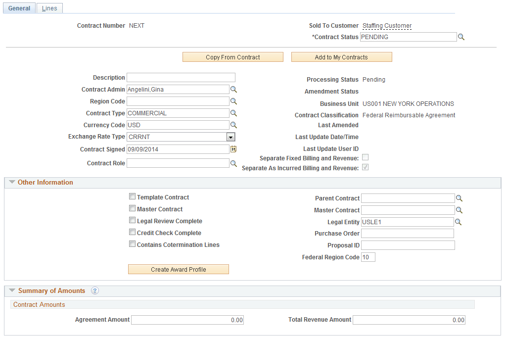

Contracts – General Page
Use the Contract - General page (CA_HDR_PNL) to set up and manage contract header information.
Navigation:
Customer Contracts, and then Create and Amend, and then General Information, and then Contract - General
This example illustrates the fields and controls on the Contracts - General Page. You can find definitions for the fields and controls later on this page.
Contracts - General - Federal Page
Field or Control Description
Separate Fixed Billing and Revenue
Since fixed amount contract lines are not applicable for Federal Reimbursable Agreements, this field is always unchecked.
Separate As Incurred Billing and Revenue
Displays the value that is selected while creating the contract.
This field is ready only. In certain circumstances, this field can edited on the Update Separate Billing and Revenue Options Page
Contract Role
Select suitable value from the prompt list. The value for this field is defaulted from the Contracts Definition Defaults Page and can be overridden.
For more field descriptions see Contract - General Page
Summary of Amounts
Agreement Amount
Displays the total value for billing on the contract. The value can be edited if the Agreement Amount Restricted check box is not selected on the Installation Options - Contracts page.
Total Revenue Amount
Displays the total value for revenue on the contract. The value can be edited if as incurred billing and revenue is separate on the contract. If as incurred billing and revenue is not separate, then the amount matches the agreement amount. The total revenue amount should not be less than the sum of the revenue limit of the contract lines.

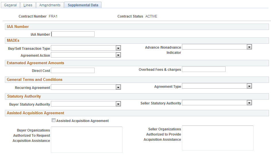

Supplemental Data Page
Supplemental Data component provides a way to define additional data at contract header and line level. You can add any number of fields for capturing customer-specific information. The supplemental data framework uses the PeopleSoft Common Components Active Analytic Framework (AAF) to define the business rules for the additional data. Based on the classification of contract type, fields on the Supplemental Data page will vary.
Use the Supplemental Data page (CA_HDR_SD) to define supplemental data and header level information for a contract.
Navigation:
Customer Contracts, and then Create and Amend, and then General Information, and then Supplemental Data
This example illustrates the fields and controls on the Contract — Supplemental Data Page. You can find definitions for the fields and controls later on this page.
Contract Header Supplemental Data Page
This tab appears when you click the Supplemental Data hyperlink on the Contract Entry Links subpage if Supplemental Data is implemented for Contracts.
Treasury issued a revised Intragovernmental Transaction (IGT) policy as part of the Treasury Financial Manual (TFM) with new requirements to support IGT standardization and adequate controls using business rules and processes to properly record, report, and reconcile IGTs. This memo declared the Interagency Agreement (IAA) as one means to satisfy the new requirements but also defined a new set of Minimum Accounting Data Element (MADEs) that agencies are asked to record, report, and reconcile quarterly. Sample data, shown on the page above, is available for Federal Reimbursable Agreement Supplemental Data to capture the data needed for Treasury’s IAA and MADE reporting.
IAA Number
Enter the unique agreement number established between the requesting and servicing agency to track from beginning to completion.
Buy/Sell Transaction Type
Select a type of buy/sell transaction from the drop down list. Options are:
  • S — Services
  • G — Goods
  • M — Mixed order with goods and services
Agreement Action
Selection the appropriate action taken on agreement to signify a newly created, modified, or canceled agreement. Options are:
  • N — New
  • M — Modification
  • C — Cancellation
Advance /Nonadvance Indicator
Select an indicator to indicate the use of advances in the execution of an order.
Direct Cost
Enter the total agreed upon direct cost value for providing the products and/or services.
Overhead Fees & charges
Enter the total agreed-upon overhead fees and charges for providing the products and/or services.
Recurring Agreement
Select appropriate option from the drop down list to indicate if the recurring agreement will be renewed on a regular basis unless notice to discontinue is received. Options are:
  • YA — Yes-Annual
  • YO — Yes-Other
  • N — No
Agreement Type
Select suitable option from the drop down list to indicate if single order or multiple orders is supported. Options are:
  • S — Single
  • M — Multiple
Buyer Statutory Authority
Select the authority that allows the requesting agency to purchase products and/or services from another Federal agency. Options are:
  • F — Franchise Fund
  • R — Revolving Fund
  • W — Working Capital Fund
  • O — Other Authority
Seller Statutory Authority
Select the authority that allows the servicing agency to provide products and/or services to another Federal agency. Options are:
  • R — Revolving Fund,
Assisted Acquisition Agreement
Select to denote whether the Servicing Agency provides acquisition support awarding and managing contracts for the Requesting Agency.
Buyer Organizations Authorized To Request Acquisition Assistance
Enter list of buyer organizations such as offices and bureaus authorized to request acquisition assistance.
Seller Organizations Authorized to Provide Acquisition Assistance
Enter list of seller organizations such as offices and bureaus authorized to provide acquisition assistance.
For additional information on Supplemental Data see PeopleSoft Maintenance Management: Understanding Supplemental Data and PeopleSoft Maintenance Management: Establishing Supplemental Data

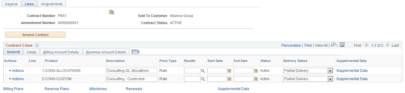

Contract - Lines Page
Use the Contract - Lines page (CA_OBLIGATIONS) to add products to a contract.
Navigation:
Customer Contracts, and then Create and Amend, and then General Information, and then Contract - Lines
This example illustrates the fields and controls on the Contract Lines — General Page. You can find definitions for the fields and controls later on this page.
Contract Lines General Page
Delivery Status
This field indicates the delivery status of goods/services. The system sets the default value for this field as Undelivered. However this value can be overridden. Based on the Bill Plan Status value that is associated to the line, the Delivery Status value will automatically change to Partial Delivery or Final Delivery.
Note: This field is visible only if the contract classification is Federal Reimbursable Agreement.
Supplemental Data
Click the hyperlink to open the Supplemental Data page for the contract line.

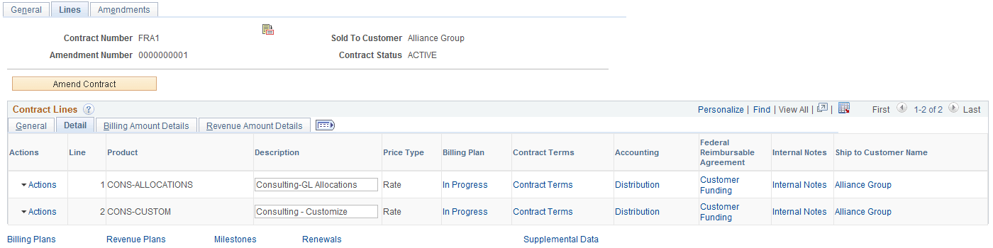

Contract Lines - Detail Page
This example illustrates the fields and controls on the Contract Lines — Detail Page. You can find definitions for the fields and controls later on this page.
Contract Lines Detail Federal Page
Click on the Customer Funding hyperlink to access the Customer Funds page that opens in a modal window.
Related Topics

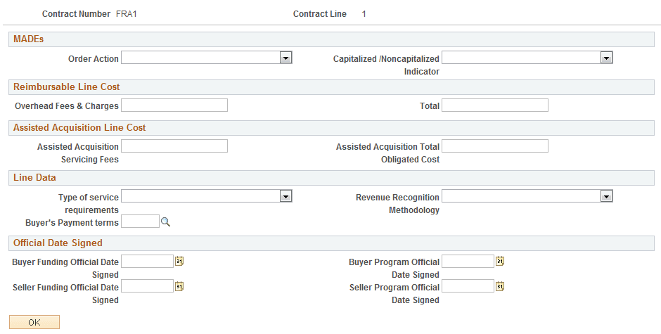

Use the Supplemental Data page (CA_DETAIL_SD) to define supplemental data and line level information for a contract line. This is applicable if Supplemental Data is implemented for Contracts.
Navigation:
Customer Contracts, and then Create and Amend, and then General Information, and then Contract - Lines Click the Supplemental Data hyperlink corresponding to the contract line
This example illustrates the fields and controls on the Contract Lines — Supplemental Data Page. You can find definitions for the fields and controls later on this page.
Contract Lines Supplemental Data Page
As with Supplemental Data at the contract header level, sample data is available for Federal Reimbursable Agreement Supplemental Data at the line level to support Treasury field requirements for the IAA and MADE fields.
Order Action
Select suitable option from the drop down list to indicate the action taken on an order. Options are:
  • N — New
  • M — Modification
  • C — Cancellation
Capitalized /Noncapitalized Indicator
Select option from the drop down list. The selected option indicates the Buyer's intent to capitalize or expense goods. Options are:
  • C — Capitalized
  • E — Expensed
Overhead Fees & Charges
Enter overhead fees and charges for each order line.
Total
Enter total direct cost for the order line.
Assisted Acquisition Servicing Fees
Enter the related service fees for the order line.
Assisted Acquisition Total Obligated Cost
Enter the sum of the Contract Cost plus Servicing Fees.
Revenue Recognition Methodology
Select suitable revenue recognition methodology. Given options are:
  • Straight-line – Select if the same amount will be recognized each month.
  • Accrual Per Work Completed – Select if accruing revenue/expense is other than straight-line.
  • Monthly - Select if the accrual is based on work completed and invoiced on a monthly basis.
  • Other - Select if another regular period will be used.
Type of service requirements
Select the type of service required for the order line. Options are:
  • S — Severable Service
  • N — Non-Severable Service
  • N — Not Applicable
Buyer’s Payment terms
Click the prompt to select agreed upon payment terms for the buyer.
Buyer Funding Official Date Signed
Enter the date when the Requesting Agency Funding Official signs to obligate funds.
Seller Funding Official Date Signed
Enter the date when the Servicing Agency Funding Official signs to start work.
Buyer Program Official Date Signed
Enter the date when the Requesting Agency Program Official confirms bona fide need and funds availability.
Seller Program Official Date Signed
Enter the date when the Servicing Agency Funding Official signs to start work and bill, collect, and account for funds from the Requesting Agency.
OK
Click the OK button to close the Supplemental Data page modal window and return to the Contract — Lines page.

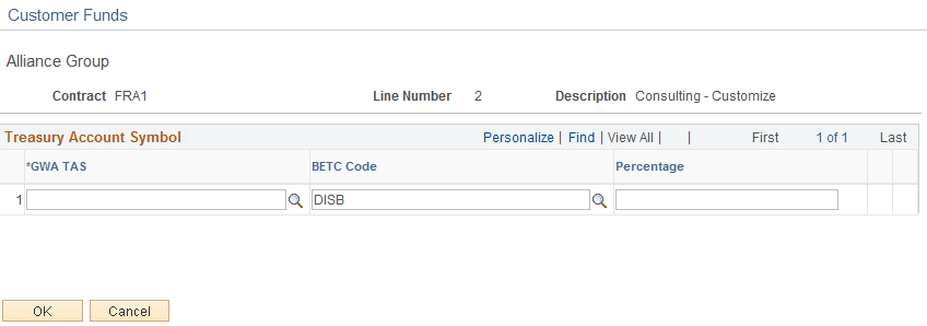

Customer Funds Page
Use the Customer Funds page (CA_DETAIL_TAS_SEC) to enter the TAS and BETC customer funding details for each contract line. This is applicable for contracts with a classification of federal reimbursable agreements only and will be used to create the IPAC billing transaction for the receiver.
Navigation:
Customer Contracts, and then Create and Amend, and then General Information, and then Contract - Lines, and then Click the Detail tab Click the Customer Funding hyperlink corresponding to the contract line
This example illustrates the fields and controls on the Customer Funds Page. You can find definitions for the fields and controls later on this page.
Customer Funds page
GWA TAS
Select from the prompt appropriate Government wide Accounting and Reporting Program (GWA) Treasury Account Symbol (TAS). On clicking the prompt only external TAS are displayed.
BETC Code(Business Event Type Code)
The default value for this field is DISB (Disbursement) for receiver BETC and COLL (Collection) for sender BETC. You can modify the value by clicking the prompt button.
Percentage
Enter appropriate percent to be distributed to the TAS-BETC combinations such that the sum of all the percentages for all the TAS-BETC combinations defined for the contract line equals 100%.
