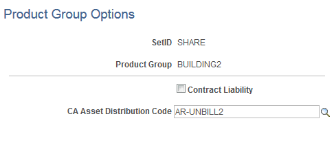

Product Group Options Page
CA_PROD_GROUP
Assign contract attributes such as contract liability and contract asset options for product groups.

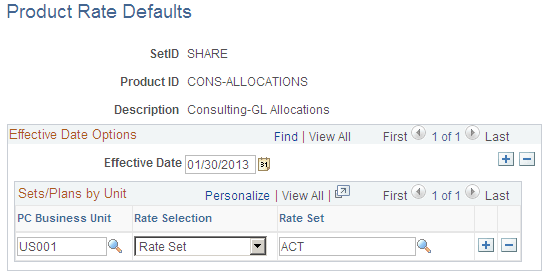

Product Rate Defaults Page
CA_PROD_RATES
Define default rate plans or rate sets to the product.

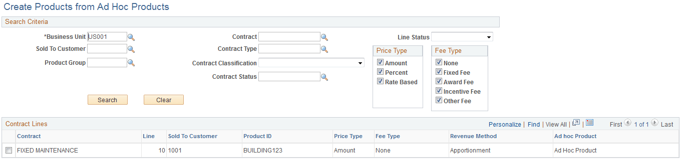

Create Products from Ad Hoc Products Page
CA_PROD_ADH_CREATE
Convert ad hoc products into regular products for use on your contract lines.
Use the Product Group Options page (CA_PROD_GROUP) to assign contract attributes such as contract liability and contract asset options for product groups.
Navigation:
Set Up Financials/Supply Chain, and then Product Related, and then Contracts, and then Contracts Product Options, and then Setup CA Product Group Options
This example illustrates the fields and controls on the Product Group Options page. You can find definitions for the fields and controls later on this page.
Select default attributes for the product group. The system populates the contract lines for any products assigned to this product group with the default values that you enter here.
Field or Control Description
Contract Liability
Indicate your contract liability option for the product group. The option that you select here, along with the option you select for the Contract Liability Override check box on the Contracts Definition - Processing Options page, determine whether a contract line enables contract liability.
Here are the possible scenarios:
  • If you select this check box, you enable contract liability for all products within this product group.
  • If you do not select this check box, you can use contract liability on the contract line if you select the contract liability override option on the Contracts Definition - Processing Options page.
  • If you do not select this check box and you do not select the contract liability override check box on the Contracts Definition - Processing Options page, then no products in this product group can have contract liability.
Contract Asset Distribution Code
Select a default contract asset account definition. You establish the list of Contract Asset distribution codes on the Distribution Code page. If the product group has an Contract Asset account definition, then it will be used to book Contract Asset for any products associated with this product group. If you do not select an Contract Asset account for the product group, then for any products associated with this group, the Contract Asset account that is defined for the PeopleSoft Contracts business unit is used to book Contract Asset.
Use the Product Rate Defaults page (CA_PROD_RATES) to define default rate plans or rate sets to the product.
Navigation:
Set Up Financials/Supply Chain, and then Product Related, and then Contracts, and then Contracts Product Options, and then Setup CA Product Rate Defaults
This example illustrates the fields and controls on the Product Rate Defaults page. You can find definitions for the fields and controls later on this page.
Effective Date
Displays the current date.
Sets/Plans by Unit
PC Business Unit (PeopleSoft Project Costing business unit)
Select a default PeopleSoft Project Costing business unit.
Rate Selection
Select whether you want to associate a Rate Set or Rate Plan with the product. The value that you select here determines the additional field (either Rate Set or Rate Plan) that appears on the page.
Rate Set
Select a default value for the rate set for the product. This field appears only if you selected Rate Set in the Rate Selection field.
Rate Plan
Select a default value for the rate plan identifier for the product. This field appears only if you selected Rate Plan in the Rate Selection field.
Use the Create Products from Ad Hoc Products page (CA_PROD_ADH_CREATE) to convert ad hoc products into regular products for use on your contract lines.
Navigation:
Set Up Financials/Supply Chain, and then Product Related, and then Contracts, and then Contracts Product Options, and then Setup Products from Ad Hoc
This example illustrates the fields and controls on the Create Products from Ad Hoc Products page. You can find definitions for the fields and controls later on this page.
View all ad hoc products that you have defined, or view all ad hoc products that you defined for specific parameters such as contract number or sold-to customer. In the search criteria group box, specify your search parameters: Contract, Sold To Customer, Product Group, Contract Type, Contract Classification, Contract Status, or Line Status. The search returns all current ad hoc products for the specified search criteria. If you leave all fields blank, the search returns all ad hoc products that you have defined. In addition, select the check box next to a specific price type in the Price Type group box if you want to limit your search by price type.
The search does not return any ad hoc products that you defined and subsequently turned into regular products.
For contracts with a classification of Government, you can additionally select the check box next to a specific fee type in the Fee Type group box if you want to limit your search by fee type. This field appears only if you leave the Contract Classification field blank or you select a contract classification of Government. When the Contract Classification is blank and you are looking for matching criteria for a contract with a contract classification of something other than Government, select the None Fee Type option.
See PeopleSoft Contracts for Government Contracting: Government Contracts Overview
Check box(select)
Select the check box next to ad hoc products that you want to convert to regular products for use on your contract lines.
Create Product
Click this button to create a product for the selected ad hoc lines.
When you convert an ad hoc product, the system creates the product definition data for the new product based on the existing data for the ad hoc product on the contract line.
