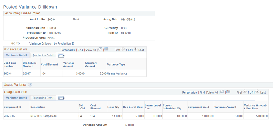

Posted Variance Drilldown Page
Use the Posted Variance Drilldown page (CE_PRD_VAR_INQ) to review accounting lines posted for production variances produced for a production ID or schedule in PeopleSoft Manufacturing.
Navigation:
Cost Accounting, and then Inventory and Mfg Accounting, and then Analyze Production Costs, and then Posted Variance Drilldown
This example illustrates the fields and controls on the Posted Variance Drilldown page. You can find definitions for the fields and controls later on this page.
The Posted Variance Drilldown page displays only one accounting line number at a time.
In order to view accounting line data using the Posted Variance Drilldown page, the production ID or schedule must be in the status of Closed for Accounting and you must first run the Close Production process to populate the Production Variance Detail record (SF_VARS_DETAIL) and the Configuration Variance Detail record (SF_CFGVAR_DET ) and then run the Cost Accounting Creation process to generate accounting entries.
The Account Line Number group box displays information about the accounting line reviewed on this page.
Click the Variance Drilldown by Production ID link to access the Production Variance Drilldown page where you can review the calculation details of the production variances produced for a production ID or schedule. The Production Variance Drilldown page displays only one production ID or schedule at a time.
Variance Details
The Variance Details group box displays the accounting entry details, amounts, and different variance types. The Production Detail tab displays information about the accounting entry.
