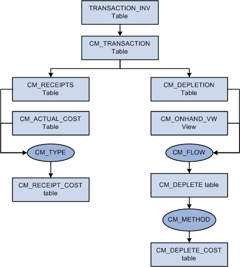

This diagram illustrates the cost flow for a lot controlled item.
The TRANSACTION_INV Table
Transactions for PeopleSoft Inventory and PeopleSoft Manufacturing are inserted into the PeopleSoft Transaction History (TRANSACTION_INV) table. In this example, there are three transactions stocking item A into the US008 inventory business unit (020 Putaway transactions), and two transactions shipping item A out of the US008 business unit (030– Usage and Shipment transactions).

The CM_TRANSACTION Table
The Transaction Costing process expands the transactions in TRANSACTION_INV into the PeopleSoft Cost Management CM_TRANSACTION table, adding a separate row for each business unit and cost book combination.
The CM_RECEIPTS Table
The Transaction Costing process places 020– Putaway transactions into CM_RECEIPTS.

The CM_DEPLETION Table
The Transaction Costing process places 030– Usage & Shipment transactions into CM_DEPLETION.

The CM_ACTUAL_COST Table
Item putaway costs are computed and placed in CM_ACTUAL_COST table.

The CM_RECEIPT_COST Table
Data from the CM_RECEIPTS table and the CM_ACTUAL_COST table are used to calculate the receipt costs for the CM_RECEIPT_COST table. This is based on the cost type entered for the cost book on the Inventory Definition - Business Unit Books page.

The CM_ONHAND_VW Table
The CM_ONHAND_VW table matches receipts (putaways) with depletions (usage and shipments) based on the Cost Flow field on the Cost Profiles page.

The CM_DEPLETE Table
The process matches up each depletion transaction in CM_DEPLETION with a qualifying putaway from CM_ONHAND_VW. These depleted depletions are inserted into the CM_DEPLETE table. The Cost Flow field on the Cost Profiles page determines how receipts are matched with depletions. For lot-controlled items, the cost of the specific lot is used. This offers you a specific method of tracking quantities and costs by lot.

The CM_DEPLETE_COST Table
The process calculates the cost of depletions in the CM_DEPLETE table and placed them in the CM_DEPLETE_COST table. This is based on the Deplete Cost Method defined on the Cost Profiles page.
