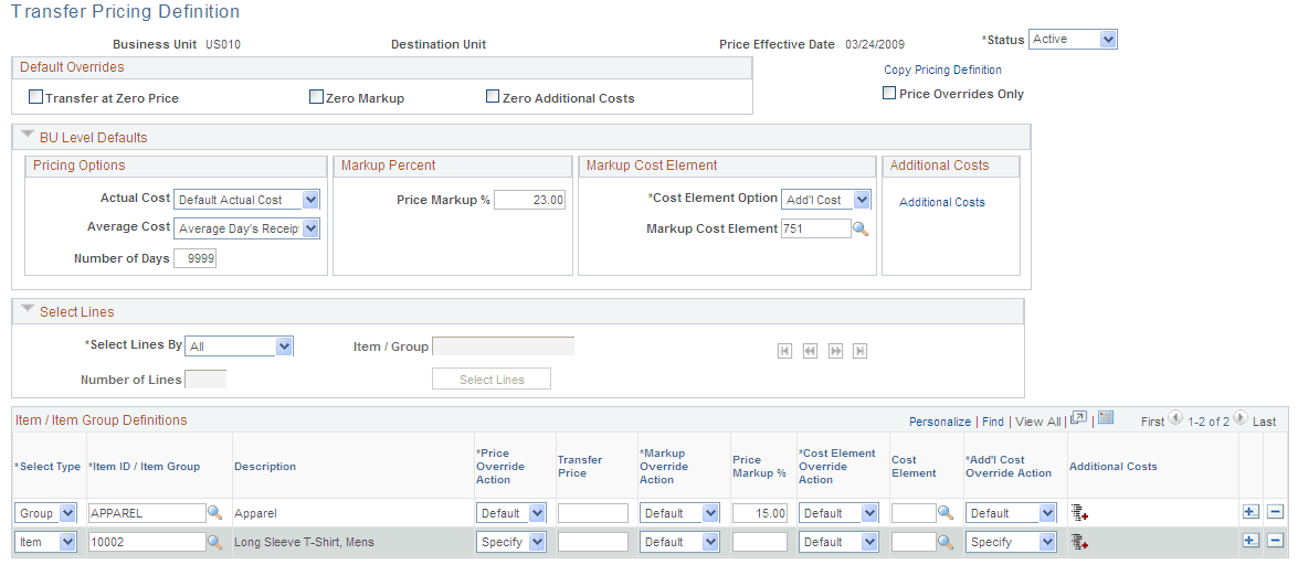

This example illustrates the fields and controls on the Transfer Pricing Definition page. You can find definitions for the fields and controls later on this page.

Header Levels and Detail Levels
On the Transfer Pricing Definition page, overrides and default values can be entered at both the header level or the detail level.
Overrides and default values defined at the header level apply to the entire transfer pricing definition. The header level includes the Default Overrides group box and the BU Level Defaults group box. These values are used with transfers from this source inventory business unit (or source unit and destination unit combination) and for this price effective date. Information added at the header level is used to determine the transfer price for all items that are not overridden at the detail level as long as the Price Overrides Only check box has not been selected.
Overrides and default values defined at the detail level apply to an item group or item ID within the transfer pricing definition. The detail level includes the Item / Item Group Definitions group box. These values can be added to override the values defined at the header level.

BU Level Defaults Group Box
The default values defined in this group box apply to the entire transfer pricing definition (that is, the header level). These default values are used with transfers from this source inventory business unit (or source unit and destination unit combination) and for this price effective date. When setting up a Transfer Pricing Definition component, keep in mind that your entry in the Price Overrides Only check box changes the use of this group box.
Field or Control Description
Actual Cost
Select the method for calculating the transfer price for items using the actual cost method on the Cost Profiles page. If this field is left blank, then the system uses the Default Actual Cost value. The options are:
  • Average Day's Receipts: The transfer price is base on a weighted average of receipt costs over the past number of days. Enter the number of days in the Number of Days field in this group box. The Number of Days field is required when this option is selected. The system retrieves the receipts for a date range from the current date back the specified number of days and then the system calculates a weighted average as follows: sum of quantity received times receipt cost divided by total quantity received. This option can only be used by the Calculate Transfer Price process to populate the Transfer Price table.
  • Default Actual Cost: The transfer price is based on the value in the Default Actual Cost field (DFLT_ACTUAL_COST) on the Define Business Unit Item - General: Common page (BU_ITEMS_INV table). This option is the default value when creating a new transfer pricing definition. If the Deplete On Hand Qty process is calculating a transfer price for an MSR line by directly using the data in the Transfer Pricing Definition component, then this option is the only available choice.
  • Last Actual Cost: The transfer price is based on the last receipt cost in CM_ACTUAL_COST table. This option can only be used by the Calculate Transfer Price process to populate the Transfer Price table.

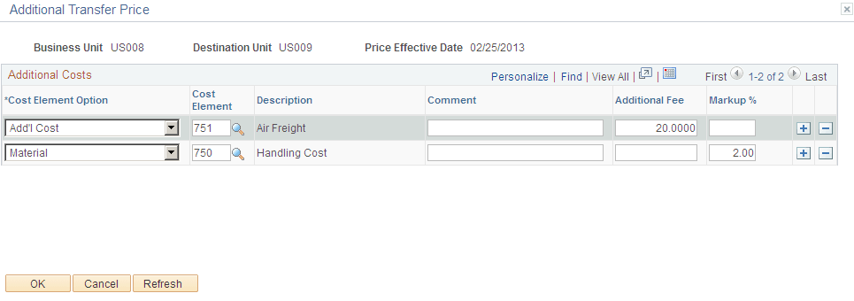

Additional Costs
Click the Additional Costs link (in the BU Level Defaults group box) to access the Additional Transfer Price (Header Level) page, where you can define or change additional transfer costs at the header level of this transfer pricing definition. These costs use a cost element with the cost category of Addl Trans (Additional Transfer Costs). This link and the underlying Additional Transfer Price (Header Level) page can only be used by the Calculate Transfer Price process to populate the Transfer Price table.
Select Lines Group Box
Use the Select Lines group box to enter search criteria for displaying existing items and item group definition in the Item / Item Group Definitions group box.
Select Lines By
Select to search for rows by Item Group, Item ID, or All.
Item / Group
Enter the item ID or item group ID to be used when selecting data for the Item / Item Group Definitions group box. The search returns rows with a value equal to or greater than the item ID or item group defined. If this field is left blank, the search returns both item IDs and item groups.
Number of Lines
Enter the number of rows to be displayed in the Item / Item Group Definitions group box. If this field is blank, then the search uses a default of 100 rows. This field is populated by a default value from the Transfer Price Lines Displayed field on the Installation Options - Inventory page.
Select Lines
Click this button to search for rows previously created for items and item groups in the Item / Item Group Definition group box. The rows that appear are limited by your search criteria (Select Lines By field, Item / Group field, and Number of Lines field). To display other rows, change your search criteria and then click this button to initiate a new search; a warning message is displayed asking if you want to save changes to the existing date.
Item / Item Group Definitions Group Box
The detail level overrides and default values defined in this group box apply to the specific item ID or item group in the row. The values entered here override the same values entered at the header level. To create a new row to override header level attributes for a specific item ID or item group, add a new row to the grid.
Select Type
When adding a new row, select to add an Item or Group to specify what type of value will be entered in the Item ID / Item Group field.
Enter either an item ID or an item group depending on your entry in the Select Type field. An row in this grid overrides the header level parameters used to calculate the transfer price. If a destination business unit has been specified, the item ID must be valid in both business units.
Description
Displays the description of the item ID or item group.
Price Override Action
Enter a value to determine the origin of the transfer price. The options are:
  • Default: Use the pricing method specified at the header level of the transfer pricing definition.
  • Specify: Use the transfer price entered in the Transfer Price field on this row.
Transfer Price
Enter a transfer price to override the calculation at the header level of this transfer pricing definition. To use this field, you must select the value of Specify for the Price Override Action field in this row. If the field is blank, then the system uses a zero price for the transfer.
This field is used by both the Calculate Transfer Price process (to populate the Transfer Price table) and the Deplete On Hand Qty process (to calculate a transfer price directly from this component).
Markup Override Action
Enter a value to determine the origin of the markup percentage applied to the transfer price. The options are:
  • Default: Use the markup percentage specified at the header level of the transfer pricing definition.
  • Specify: Use the percentage entered in the Price Markup % field on this row.
Price Markup %
Enter a markup percentage to be applied to the transfer price. This field overrides the markup percentage at the header level of this transfer pricing definition. To use this field, you must select the value of Specify for the Markup Override Action field in this row. If the field is blank, then the system does not use a markup percentage on the transfer price.
Cost Element Override Action
Select the type of cost element to which the markup percentage should be applied. The options are:
  • Material: The system adds the price markup to the material cost element of the transferred item. If you select this option, you cannot enter a value in the Cost Element field of this row since the system uses the item's material cost element. The system retrieves the material cost element for the item from the Default Cost Element field defined on the Define Business Unit Item - General: Common page.
  • Default: The system uses the values in the Markup Cost Element group box at the header level of this transfer pricing definition.
  • Specify:The system uses the override value in the Cost Element field in this row. This cost element must have a cost category of Addl Trans (additional transfer costs).
Cost Element
Enter a cost element with a cost category of Addl Trans (additional transfer costs). The markup percentage is applied to this cost element if you have selected the value of Specify for the Cost Element Override Action field on this row.
Add'l Cost Override Action (additional cost override action)
Enter a value to determine the origin of the Addl Trans cost elements applied to the transfer price. The options are:
  • Default: Use the Addl Trans cost elements specified in the Additional Transfer Price (Header Level) page of this transfer pricing definition. To access this page, click the Additional Costs link within the BU Level Defaults group box.
  • Specify: Use the Addl Trans cost elements entered in the Additional Transfer Price (Detail Level) page of this row. To access this page, click the Addl Costs icon on this row.
This field can only be used by the Calculate Transfer Price process to populate the Transfer Price table.

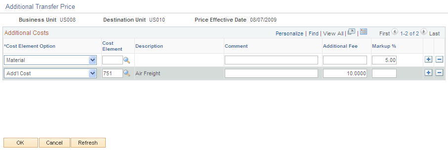

Additional Costs(Addl Costs)
Click the Additional Costs icon to access the Additional Transfer Price (Detail Level) page, where you can add or change additional costs to a item group or item ID (detail level). This link and the underlying Additional Transfer Price (Detail Level) page can only be used by the Calculate Transfer Price process to populate the Transfer Price table.

Additional Transfer Price (Header Level) Page
Use the Additional Transfer Price (Header Level) page (CM_TRAN_PRICE_CE) to add or change additional costs at the header level of the transfer pricing definition.

On the Transfer Pricing Definition page, click the Additional Costs link in the BU Level Defaults group box.
This example illustrates the fields and controls on the Additional Transfer Price page at the header level. You can find definitions for the fields and controls later on this page.
This page displays the cost element detail for the header level of the transfer pricing definition and allows you to enter additional transfer costs using cost elements with a cost category of Addl Trans. This page can only be used by the Calculate Transfer Price process to populate the Transfer Price table.
Cost Element Option
Select the cost category of the cost element for this row. The options are Material or Add'l Cost. If you select the Material option, the Cost Element field must remain blank.
Cost Element
Select a Addl Trans cost element for this row. The cost element does not have to be unique.
If the cost element field is blank, then the system retrieves the material cost element for the item from the Default Cost Element field defined on the Define Business Unit Item - General: Common page.
Description
Displays the description of the cost element.
Comment
(Optional) Enter a comment about this additional charge.
Additional Fee
Enter a amount to be applied to transfers using the cost element specified on this row.
Markup %(markup percentage)
Define the percentage increase to the initial transfer price of the item. The markup percentage is applied to all cost elements. For example if you enter a value of 25 in this field and the item includes 75 USD in the cost element 100 (material) and 25 USD in the cost element 601 (landed costs) then the markup is applied to 100 USD for a total markup of 25 USD (100 USD x 25%= 25 USD). The markup amount can be applied to the material cost element or to an additional transfer cost element depending on your entry in the Cost Element Option field of this row.
Be sure to enter a 25% markup as 25, not .25. In addition, you can enter a percentage greater than 100.

This example illustrates the fields and controls on the Additional Transfer Price page at the detail level. You can find definitions for the fields and controls later on this page.
This page displays the cost element detail for the detail level of the transfer pricing definition and allows you to enter additional transfer costs using cost elements with a cost category of Addl Trans. The top section of this page displays the item ID or item group for these additional prices. The field definitions are the same as the Additional Transfer Price (Header Level) page defined above. This page can only be used by the Calculate Transfer Price process to populate the Transfer Price table.
