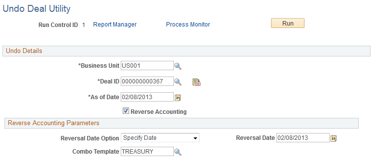

This example illustrates the fields and controls on the Undo Deal Utility page. You can find definitions for the fields and controls later on this page.

Field or Control Description
Reverse Accounting
Click this check box to enable the Reverse Accounting Entries Application Engine process (TR_RVSL_DRVR). You must enter reversal criteria in the Reverse Accounting Parameters section.
Reversal Date Option
Select the date to use as the accounting date for the reversal accounting entries.
The Reversal Date field is available for input when the reversal date option is Specify Date.
Select a reversal date from these values:
  • Current Date- Select to use the current date as the accounting date for the reversal accounting entries.
  • Specify Date - This option requires a value in the Reversal Date field, where you can enter a specific accounting date.
Combo Template
Specify a ChartField combination editing template.
See Application Fundamentals: Setting Up Combination Editing.
