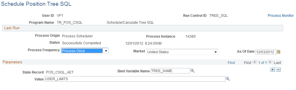

Schedule Position Tree SQL Page
TR_AE_RUNCNTL
Run the Schedule/Calculate Tree SQL process (TR_POS_CSQL) to set up the intervals in which your SQL is to run.
See Scheduling Position Tree SQL for more information.

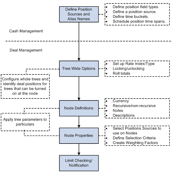

PeopleSoft Tree Definition
Two pages control the database fields that are available to deal position and cash forecast management: Position Field Types page and Position Field Source page. PeopleSoft Treasury applications deliver sample position fields and sources in the sample database for guidance. Create position field types and position sources as appropriate to your organization. Typically, you implement page-level security to limit access to these pages to appropriate roles within your organization.
You need to set up your position sources and alias names before creating a deal position tree. After you have created the tree, you generate the SQL and define time sets. This diagram illustrates the setup process:
This diagram illustrates the setup process for dealing trees and deal positions
Setting up dealing trees and deal positions
Each tree node corresponds to one or many position sources. You can define an unlimited number of deal position trees, and you can also associate limits with a node.
When analyzing deal positions, use time spans to define the periods for which to view the data. Time spans add the time dimension to your deal positions.

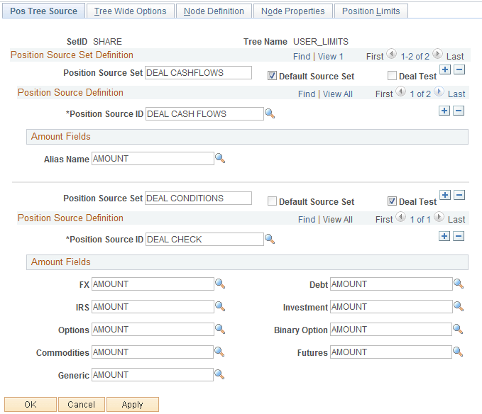

Entering Deal Position Tree Source Information
Use the Pos Tree Source page (POS_TREE_SOURCE) to enter general information about the position source and define the position source set.
Navigation:
Tree Manager, and then Tree Manager
Click the Edit Data icon on the Tree Manager page.
Select the Pos Tree Source (position tree source) tab.
This example illustrates the fields and controls on the Pos Tree Source page. You can find definitions for the fields and controls later on this page.
Field or Control Description
Position Source Set
Define the name of the source set for the tree. Select the Default Source Set check box to designate this as the default source set.
Position Source ID
The value that you select determines how the Amount Fields grid appears. Complete all of the fields.
Deal Test
Select the Deal Test check box if you intend to validate deals.

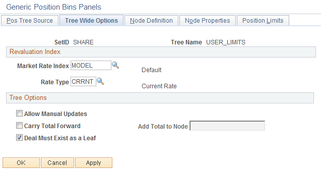

Specifying Tree-Wide Options
Use the Tree Wide Options page (POS_TREE_PNL) to specify the market rate index to use for currency revaluation and define whether a deal needs to meet the criteria for an end node on the tree during deal validation.
You can also select an option to compute running totals during deal position analysis.
Navigation:
Click the Edit Dataicon on the Tree Manager page.
Select the Tree Wide Options tab.
This example illustrates the fields and controls on the Tree Wide Options page. You can find definitions for the fields and controls later on this page.
Market Rate Index and Rate Type
When the currency of the amount that is used for determining a position is not the same currency that you define as the node currency, use these fields to revalue the amount.
You must establish market rates for each currency pair that you revalue from the currency of the source position to the currency of the node position, or the system excludes the data. For example, suppose that you have various sources of data in which the currency is USD, GBP, EUR, and JPY, and the position currency for the node is set to USD. You define the following exchange rates:
From To
USD
USD
GBP
USD
EUR
USD
JPY
USD
When an exchange rate is entered from its own currency to its own currency, you must set the rate to 1.
Tree Options
Allow Manual Updates
Select to enable manual updates to the Lock/Unlock function on the Deal Position Manager page.
Carry Total Forward
Select to compute running totals when the deal position is evaluated. The system adds ending balance amounts for one period to the beginning balance amounts for the next period. If you select this check box, also select the node, in the Add Total to NodeNode field, to which you will carry the totals forward.
Deal Must Exist as a Leaf
Select this option if you require that a deal match the criteria for an end node (leaf) of a tree to be valid. Deal validation testing occurs when you click the Deal Test button at deal entry. If this check box is not selected, then deals that do not specifically match the criteria for an end node, but that do meet the criteria for a level in the tree hierarchy, are considered valid.
For deal validation using the Deal Test button, a tree must include %THIS DEAL in its root node selection criteria.

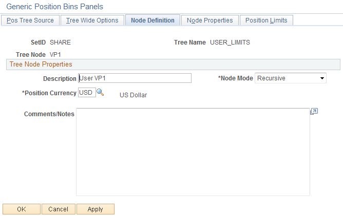

Defining Tree Nodes
Use the Node Definition page (POS_DEF_OPER_PNL) to specify the characteristics for each node of a tree.
Navigation:
Select the Node Definition tab.
This example illustrates the fields and controls on the Node Definition page. You can find definitions for the fields and controls later on this page.
Node Mode
Select a value based on the purpose of the node. For example, suppose that you are setting up a tree to track currency exposure. You may want to track exposure for only four or five main currencies. In that case, you would set the parent node to Non-recursive because you do not intend to include all possible foreign exchange (FX) deals in the child nodes and you want the parent node to provide total exposure for all currencies. On the other hand, if you want the parent node to provide total exposure for only the currencies that are selected in the child nodes, then you would set the parent node to Recursive. During position analysis, if your tree hierarchy contains parent nodes that are nonrecursive and the children beneath that node do not specifically select all the data, then the remaining amounts are incorporated into an other node so that the sum total of the child nodes equals that of the parent. Values are:
Recursive: If a node is recursive, its total is determined by summing the totals of all the child nodes beneath it.
Non-recursive: If a node is nonrecursive, its total is determined by summing the amounts for those transactions that meet the selection criteria for that node, independent of any child nodes that may exist beneath it.
Position Currency
Each node can report amounts in a different currency. Select the currency on which to base this node's amounts. Any amounts that are not in this currency are revalued to this currency, using the market rate settings that you made on the Tree Wide Options page.
End nodes, or leaves, of a tree must always be set to Non-recursive, and nonrecursive nodes must have selection criteria defined for each position source they use.

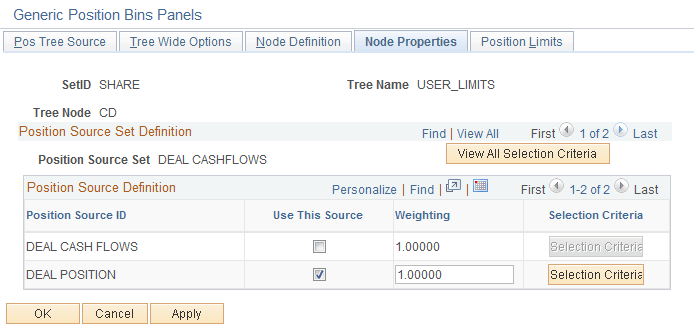

Defining Node Properties
Use the Node Properties page (POS_SOURCE_SET_PNL) to identify sources for the specified node.
Navigation:
Select the Node Properties tab.
This example illustrates the fields and controls on the Node Properties page. You can find definitions for the fields and controls later on this page.
Use This Source
Deselect this check box to prevent use of a position source ID.
Selection Criteria
Click this button to view the Selection Criteria page (POS_DEF_WHERE_SEC) for the selected position source ID, or click the View All Selection Criteria button to view all selection criteria information.

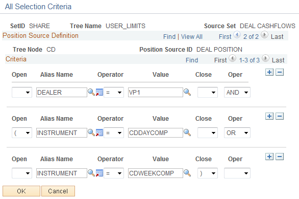

Defining Node Properties SQL Selection Criteria for Deal Position Source Sets
Use the Node Properties - All Selection Criteria page (POS_ALL_CNDTN_SEC) to create SQL statements of selection criteria for position source IDs.
After you create SQL statements with selection criteria for position source IDs, use the Create Position SQL page to process the SQL statements for the tree.
Navigation:
Click the View All Selection Criteria button on the Node Properties page.
This example illustrates the fields and controls on the Node Properties - All Selection Criteria page. You can find definitions for the fields and controls later on this page.
Open andClose
Select a character to open or close the statement.
Operator
Select a mathematical operator, and specify the value for the alias name.
Oper (operand)
Select a value when concatenating multiple SQL statements.

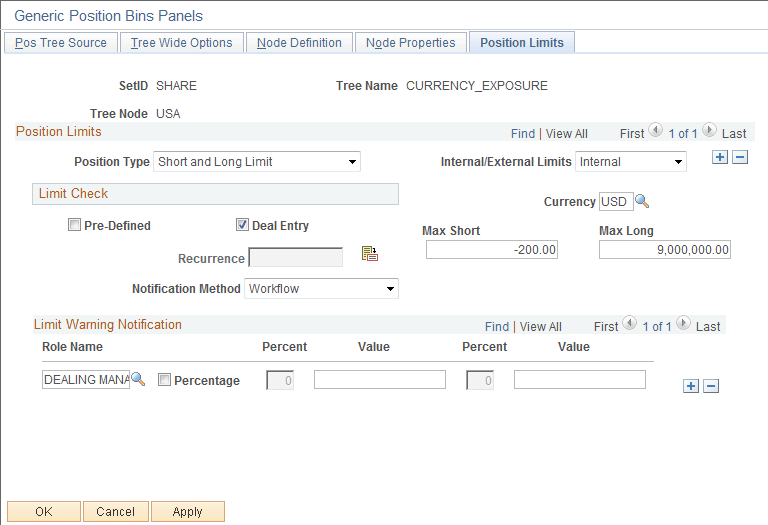

Defining Position Limits
Use the Position Limits page (POS_LIMITS) to indicate when limit checking should occur, who should be notified, and under what conditions.
If you are using the Limit Checked workflow, you must establish position limits for the system to generate notifications.
Navigation:
Select the Position Limits tab.
This example illustrates the fields and controls on the Position Limits page. You can find definitions for the fields and controls later on this page.
Position Type
Select from the following options:
Long Limit Only: Select this option if you want notification in conditions in which you have a long position. Specify values in the Min (minimum), Max (maximum), and Long fields.
Short and Long Limit: Select this option if you want notification in conditions in which you have either a short or a long position. Specify values in the Max Short and Max Long fields.
Short Limit Only: Select this option if you want notification in conditions in which you have a short position. Specify values in the Min Short and Max Short fields.
Internal/External Limits
Indicate whether the limit is determined by an Internal source or is imposed from an External source, such as counterparty.
Currency
Enter the long and short limit amounts for the defined currency.
Limit Check
Use the Limit Check grid to indicate when these position limits are checked. You can select both the Pre-Defined and Deal Entry check boxes.
Pre-Defined
Select for position limits to be automatically checked, and define a value in the Recurrence field to check position limits at regular intervals.
Deal Entry
Select to ensure that these position limits can be checked at deal entry (by clicking the Test Limits button on the Deal Detail page).
Notification Method
Choose the notification method for processing the facility review:
  • Notification Framework: Sends email and worklist notifications to the Role Names listed in the Facility Review grid, using Notification Framework.
  • Workflow: Sends notification to the Role Names that you add to the Facility Review grid, when you define and save the facility and when you run the Monitor Expiring Facilities process (TR_FCLTY_RVW).
Limit Warning Notification
Role Name
Select a role name to receive warning notification. Specify either a limit value or select the Percentage check box, and enter a limit percent that activates the warning notification.
Use the Schedule Position Tree SQL page (TR_AE_RUNCNTL) to run the Schedule/Calculate Tree SQL process (TR_POS_CSQL) to set up the intervals at which your SQL runs.
Navigation:
Set Up Financials/Supply Chain, and then Product Related, and then Treasury, and then Schedule Position Tree SQL
This example illustrates the fields and controls on the Schedule Position Tree SQL page. You can find definitions for the fields and controls later on this page.
Bind Variable Name
Select the bind variable name of TREE_NAME, and enter the specific tree name to be calculated in the Value field. You can add records and specify as many bind variable names as are pertinent to the job.
