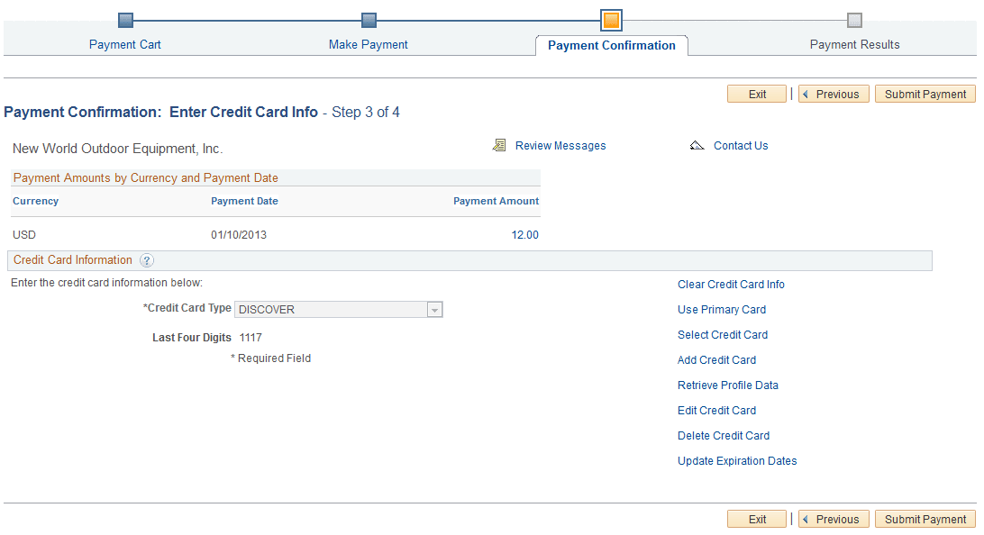

Payment Confirmation: Enter Credit Card Info - Step 3 of 4
Use the Payment Confirmation page (AR_EBP_PAY_CRCARD) to accept the default credit card, select another card, or add a new temporary profile before submitting payment.
Navigation:
Click the Next button on the Make Payment - Step 2 of 4 page.
This example illustrates the fields and controls on the Payment Confirmation: Enter Credit Card Info - Step 3 of 4 for a payment using a credit card in a hosted system.
Payment Confirmation: Enter Credit Card Info - Step 3 of 4 (hosted credit card model)
The system uses the default credit card profile. If multiple profiles exist, you can change the profile by clicking the Select Credit Card link to access the Credit Card Selection page (AR_CC_SELECT_SS).
For more information about the Credit Card Information action links, see PeopleSoft Order to Cash Common Information: Managing Credit Card Data Using Action Links.

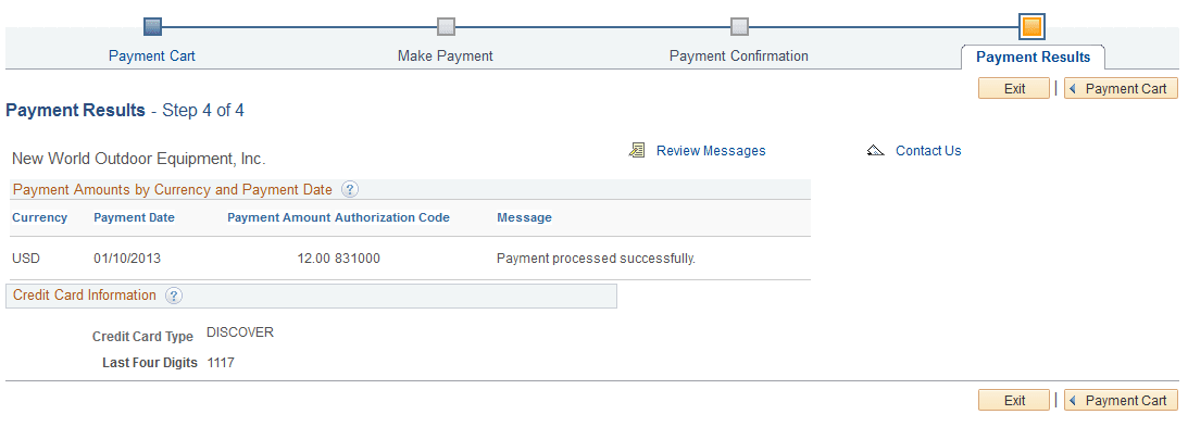

Payment Results - Step 4 of 4
Use the Payment Results page (AR_EBP_PAY_CONF) to review payment results for credit card payments.
Navigation:
Click the Submit Payment button on the Make Payment page.
This example illustrates the fields and controls on the Payment Results page - Step 4 of 4 for a payment using a credit card in a hosted system.
Payment Results - Step 4 of 4 (hosted credit card model)
Important:
Upon returning to the PeopleSoft application from the hosted credit card website, you must always click the Save button to save the payment data.

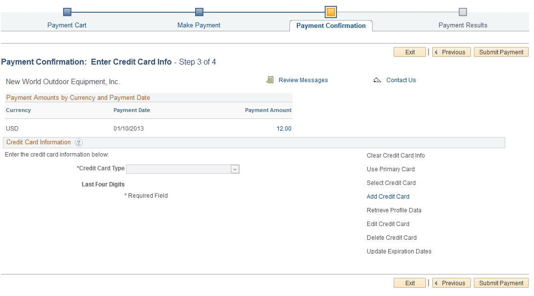

Adding a Credit Card Profile
You may need to add a credit card profile in a hosted credit card system that creates a temporary profile before submitting an online credit card transaction. In this case, you must add a credit card profile if none exists in order to complete payment. If the hosted credit card system is set up to create temporary profiles after online credit card transactions, the system creates the temporary profile after a successful credit card transaction.
For more information, see Application Fundamentals: Setting Up Credit Card Options and Groups.
This example illustrates the fields and controls on the Payment Confirmation page with no default credit card profile.
On the Payment Confirmation page, click the Add Credit Card link to transfer to the hosted credit card website to enter credit card information.
The hosted credit card website stores the complete credit card information for payments and sends profile data to the PeopleSoft system.
Important:
You must click the Save button on the Payment Confirmation page to commit the profile information to the PeopleSoft system.
