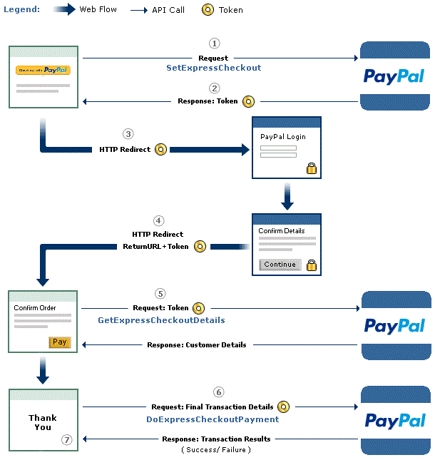

Understanding PayPal Payments
PeopleSoft eBill Payment integrates with PayPal to enable payments through PayPal Express Checkout. Merchants must create or use an established PayPal business account for receiving payments. Their customers must also set up a PayPal account appropriate for their business use.
This diagram shows how a payment is processed using PayPal Express Checkout:
Process Flow of the PayPal Integration with eBill Payment (Copyright 2016, PayPal. Used by permission.)
The Payment Cart displays the following steps for payments made through PayPal:
  1. Payment Cart
  2. Make Payment
  3. Payment Confirmation
  4. Payment Results
The PayPal payment option supports only USD and real-time payments; you cannot make future or scheduled payments.

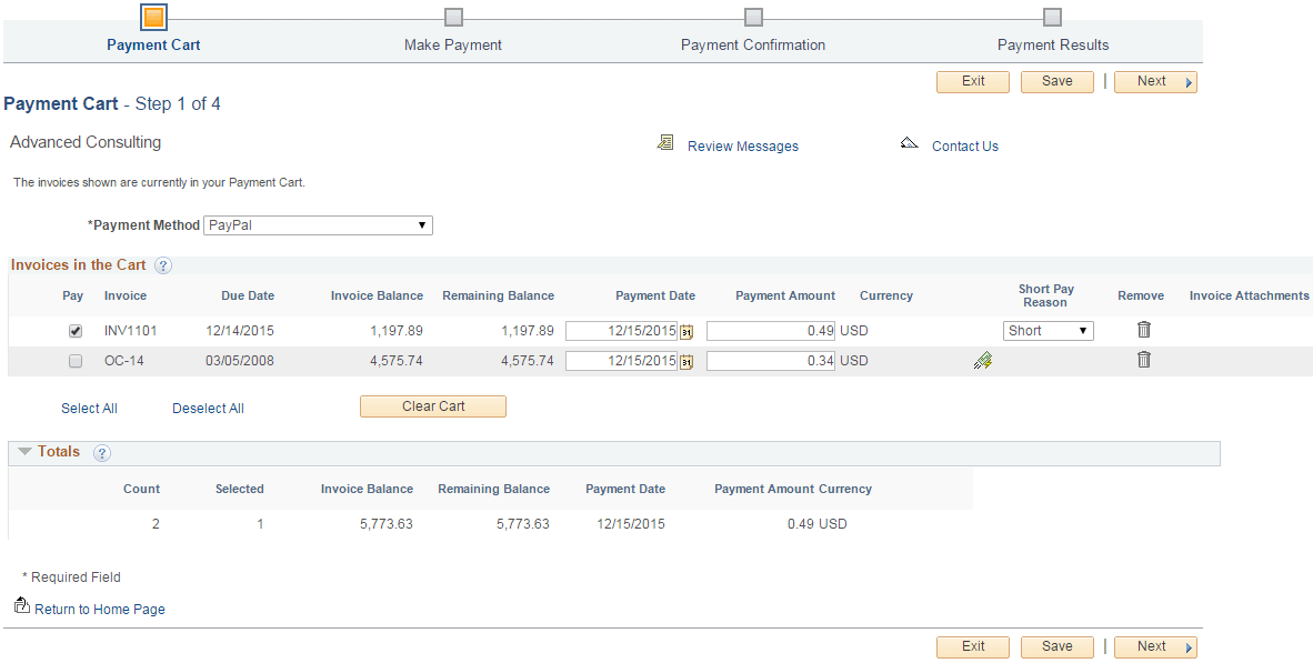

Payment Cart - Step 1 of 4
Use the Payment Cart page (AR_EBP_PAYCART_WZ1) to display and select invoices for payment to begin the payment process.
Navigation:
Click the Add to Cart button that is located on pages displaying invoices or click the Payment Cart link from the Menu.
This example illustrates the fields and controls on the Payment Cart (Step 1 of 4) for a PayPal payment.
Payment Cart - Step 1 of 4 for a PayPal payment
Field or Control Description
Payment Method
Select PayPal from the available options.
The system uses the payment method that is defined on the My Preferences for eBill Payment page as the default value.
Invoices in the Cart
Select the corresponding Pay check box for the invoices you want to pay.
Payment Date
Enter the desired payment date. The current system date is the default.
PayPal payments are real-time and do not support scheduled payments. The system displays an error message and marks the payment line in error if a customer enters a future payment date.
Payment Amount
Enter the desired payment amount. The system uses the value in the Customer Balance field as the default for this field. However, the customer can use the PeopleSoft eBill Payment Short Pay feature by overriding this value with an amount that is less than the invoice balance.
If you choose to short pay the invoice, you must select a short pay reason. Set up short pay reasons on the Short Pay Reason page (SH_PAY_RSN_TBL). The system displays an error message and marks the payment line in error if a customer does not provide a short pay reason.
Note: Invoices with negative amounts can be added to the Payment Cart, but the total payment amount must be positive. An error message appears if the total payment amount for a currency in the cart is negative.
Currency
Displays the currency. The payments are grouped by currency.
ePay Partial Payment
Click the ePay Partial Payment icon to open the ePay Partial Payments page (AR_EBP_PPEP_SEC), where you can review the partial payments for that specific invoice.
The fields Invoice Balance and Payment Amount reflect that a partial payment has been made. An invoice is removed from the Payment Cart only when the payment is fully paid.

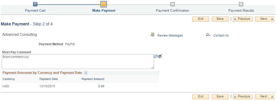

Make Payment - Step 2 of 4
Use the Make Payment page (AR_EBP_PAYCARD_WZ2) to initiate the payment process.
Upon completing this page, the system transfers you to PayPal to authorize the payment.
Navigation:
Click the Next button on the Payment Cart - Step 1 of 4 page.
This example illustrates the fields and controls on the Make Payment (Step 2 of 4) for a PayPal payment.
Make Payment - Step 2 of 4 for a PayPal payment
Payment Method
Displays the Payment Method used, in this case PayPal.
Short Pay Comment
Enter or modify the text in this field when short paying an invoice. If customers short pay an invoice and enter nothing in this field, the system generates an error message when they attempt to go to the next step.
Payment Amount
Click the amount link in this column to access the Make Payment - Payment Amount Detail page (AR_EBP_PITM_SEC), where you can review details about the invoices for the corresponding amount.
Next
Click this button to submit a payment. When you submit a PayPal payment, the PeopleSoft system transfers you to the PayPal login page for PayPal Express Checkout.
To cancel the payment while in PayPal, click the Cancel and return to PeopleSoft link to exit PayPal and return to your Payment Cart.
Click the Next button to submit the payment. When you submit a PayPal payment, the PeopleSoft system transfers you to PayPal to authorize the transaction.
Payment Amounts by Currency and Payment Date
Currency
Displays payments grouped by currency.
Payment Date
Displays the payment date or the default date entered on the Payment Cart page.
Payment Amount
Click a payment amount link to navigate to the Payment Amount Detail page (AR_EBP_PITM_SEC), where customers can review details about the invoices for the corresponding amount.

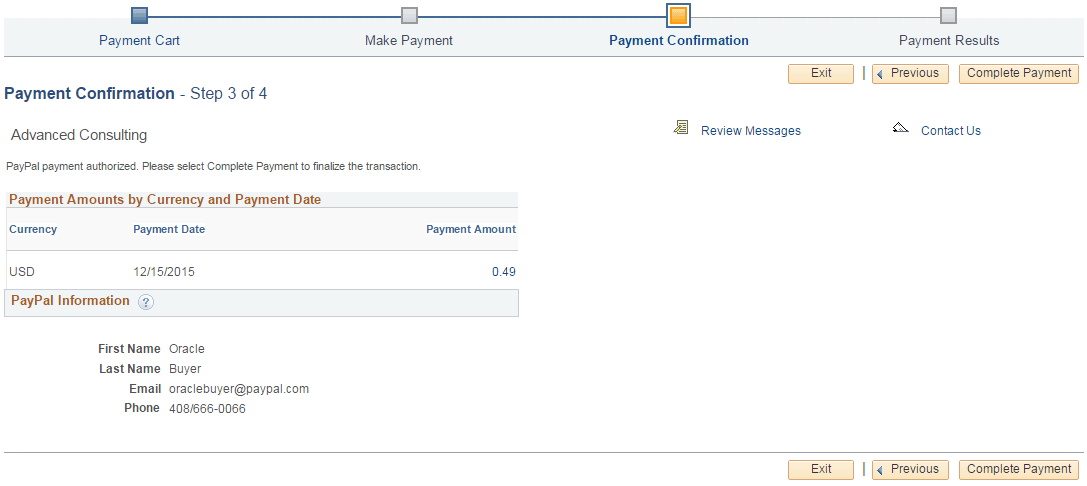

Payment Confirmation - Step 3 of 4
Use the Payment Confirmation (AR_EBP_PAY_VERF_PL) page to finalize the payment, which has been authorized in PayPal.
Navigation:
Click the Continue button in PayPal.
This example illustrates the fields and controls on the Payment Confirmation (Step 3 of 4) for a PayPal payment.
Payment Confirmation - Step 3 of 4 for a PayPal payment
PayPal returns the following information into the PeopleSoft system:
  • Currency, payment date, and payment amount.
  • Customer’s name and contact information as set up in the PayPal system.
After reviewing the amount and PayPal information, proceed by clicking one of the following buttons:
Exit
Click to exit the transaction. If you click the Exit button, or do not click Complete Payment, the transaction is considered incomplete and is not processed.
Previous
Click to return to the Make Payment step. Because the PayPal authorization has a time limit, you may need to reauthorize the payment in your PayPal account and click the Confirm Payment button on the Make Payment page.
Complete Payment
Click to finalize and settle the PayPal payment.
Important:
You must click the Complete Payment button to finalize and settle the PayPal payment, otherwise the transaction is incomplete.

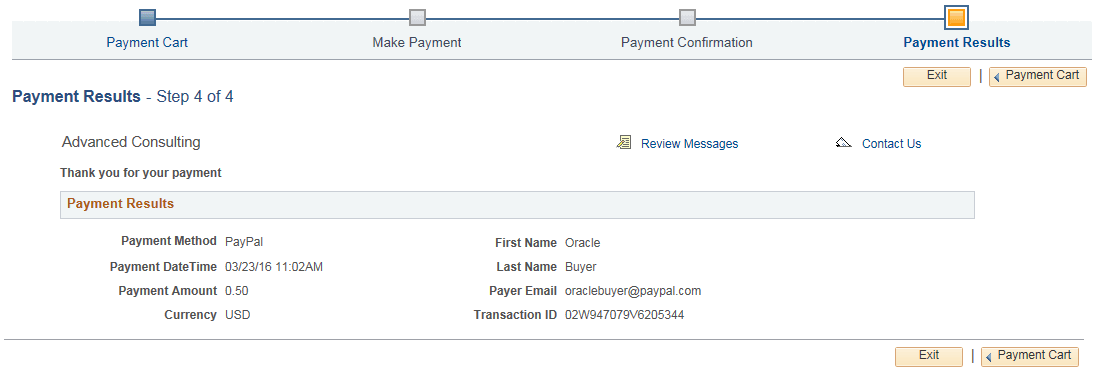

Payment Results - Step 4 of 4
Use the Payment Results (AR_EBP_PAY_RSLT_EP) page to review and save payment results in the PeopleSoft system for PayPal payments.
Navigation:
Click the Complete Payment button on the Payment Confirmation - Step 3 of 4 page.
This example illustrates the fields and controls on the Payment Results (Step 4 of 4) for a PayPal payment.
Payment Results - Step 4 of 4 for a PayPal payment
To complete the PayPal transaction, you must do one of the following on the Payment Results page in PeopleSoft:
Exit
Click the button to exit the Payment Cart. This action records the transaction in PeopleSoft Receivables.
Payment Cart
Click the button to return to the Payment Cart train stop. This action records the transaction in PeopleSoft Receivables.
WARNING:
You may lose the payment data if you do not record the PayPal payment in PeopleSoft. To record the data, you must click one of the following buttons on the Payment Results page: Payment Cart or Exit.
