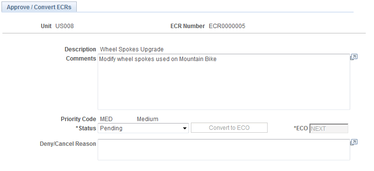

Use the Approve/Convert ECRs page (EG_ECR_APPROVAL) to change the status of ECRs, and optionally convert ECRs into ECOs.
Navigation:
Engineering, and then Engineering Changes, and then Approve ECRs/Create ECOs, and then Approve/Convert ECRs
This example illustrates the fields and controls on the Approve/Convert ECRs page. You can find definitions for the fields and controls later on this page.
Field or Control Description
Status
Select an ECR status. Values are:
  • Approved: Activates the Convert to ECO button.
  • Converted: Set automatically by the system when you convert an ECR.
  • Denied or Canceled: Activates the Deny/Cancel Reason field.
  • Pending: No action occurs.
To approve an ECR:
  1. Select Approved as the status.
  2. Click the Save button.
    Approving an ECR does not convert the ECR to an ECO.
    Upon save, if you have PeopleSoft Workflow enabled, the ECO is sent to a list of defined roles for approval.
To convert an ECR to an ECO:
  2. Click the Convert to ECO button.
  3. Enter an ECO number.
    If you have set up automatic numbering for ECOs, then the system automatically generates an ECO number when you save the information.
  4. Click the Save button.
    The ECO is not created until you click this button.
