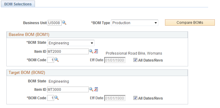

Compare EBOMs - BOM Selections Page
Use the Compare EBOMs - BOM Selections page (EG_BOM_COMPARE1E) to compare a baseline BOM to an engineering BOM within the same business unit.
You can compare any two EBOMs or compare an EBOM to an MBOM.
Navigation:
Engineering, and then BOMs and Revisions, and then Review EBOM Information, and then Compare EBOMs, and then BOM Selections
This example illustrates the fields and controls on the Compare EBOMs - BOM Selections page. You can find definitions for the fields and controls later on this page.
Baseline BOM (BOM1)
Field or Control Description
Item ID
Select an item for the baseline BOM.
BOM Code
Select a BOM code for the baseline BOM. You can select any valid BOM code, but regardless of what depth you enter, the system calculates all lower levels based on the primary BOM code.
Eff Date
Enter the effective date for the baseline BOM if you do not want to use all dates and revisions.
All Dates/Revs
Select to compare all effective dates and revisions for the baseline BOM.
Target BOM (BOM2)
Item ID
BOM Code
Eff Date
All Dates/Revs
Compare BOMs
Click this button to compare the selected BOMs.

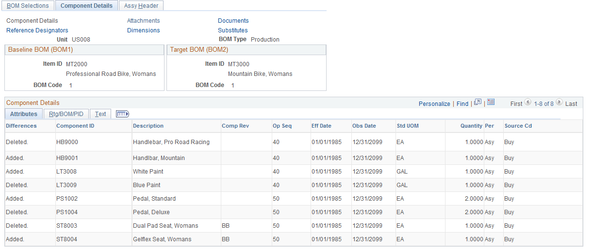

BOM Selections - Component Details Page
Use the BOM Selections - Component Details page (EG_BOM_COMPARE2) to compare component ID BOM differences, including standard unit of measure and source code.
Navigation:
Engineering, and then BOMs and Revisions, and then Review EBOM Information, and then Compare EBOMs, and then BOM Selections, and then Component Details, and then Component Details
This example illustrates the fields and controls on the BOM Selections - Component Details: Component Details page. You can find definitions for the fields and controls later on this page.
The header data consists of default values from the Compare EBOMs - BOM Selections inquiry page.
Rtg/BOM/PID tab
This page displays routing, BOM, and production ID differences between the selected BOMs.
Subs Exist
If substitutes exist for a component, this field is selected. If no substitutes exist, this field is unavailable for selection.
Sub Supply
Selected if the component is supplied by a subcontractor. If the component is not a subcontracted item, the field is unavailable for selection.
