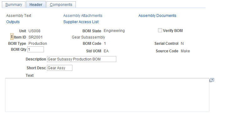

Engineering BOMs - Header: Assembly Text
EG_BOM_TEXT
Associate text with any assembly. This is useful for EBOMs without revision control because text explanations can, in part, make up for the lack of engineering change notices, attached new drawings, and design documents.

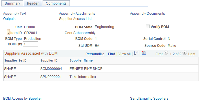

Engineering BOMs - Header: Supplier Access List Page
EG_SS_BOMVND_LST
Access the current list of suppliers who have access to a specific item.

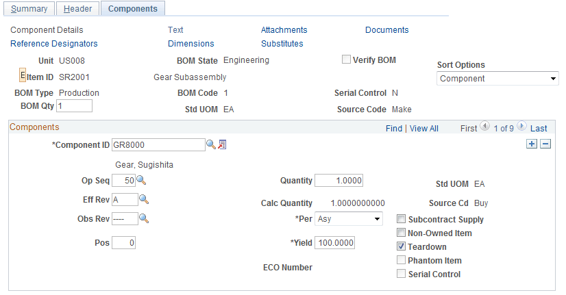

Engineering BOMs - Components: Component Details Page
EG_COMP_MAINT
Add EBOM component details, attach component text, and manage component documents. You can also add reference designators, component dimensions, and substitute components.

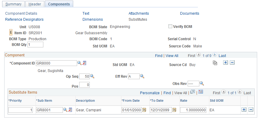

Engineering BOMs - Components: Substitutes Page
EG_COMP_SUB
Add substitute components.
Copy Business Unit Substitute Items Page
EN_BOM_SUB_ITEM_SP
View and copy valid substitutes for the component.

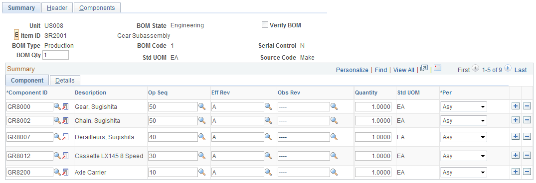

Use the Engineering BOMs - Summary page (EG_BOM_MAINT) to maintain all components that comprise a production EBOM for an assembly in a business unit.
Additionally, you can create and maintain a rework BOM to define a standard kit of components for use in repair. You can also indicate which components can be recovered if the assembly is torn down into component parts. Maintain BOMs a single level at a time.
Navigation:
Engineering, and then BOMs and Revisions, and then Maintain EBOMs and Revisions, and then Engineering BOMs, and then Summary
This example illustrates the fields and controls on the Engineering BOMs - Summary page. You can find definitions for the fields and controls later on this page.
Assembly Item Information
Field or Control Description
Item ID
Displays the item ID.
When you add an EBOM, the assembly item can be pending approval or an approved item, and must contain business unit item attributes. You can add the assembly item information by using the Item Definition and Define Business Unit Item pages in PeopleSoft Inventory. Only owned or consigned items that aren't stage-date controlled can have a bill, and must also have a source code of either Make or Buy.
Also, assembly items must use a Standard Cost profile for all their books.
Note: You can't add the end item to the rework BOM as a component. The system automatically assigns the reworked item as a component when you release a rework production ID in PeopleSoft Manufacturing.
BOM Qty (BOM quantity)
Enter the BOM quantity.
When BOMs contain a single-item output, then BOM quantity is a scaling device that enables you to enter a product structure when the end item's specifications are in a base greater than one unit. With BOM Qty, you determine the assembly quantity to which the component's QPA or per order is applied. If the BOM quantity is greater than 1, you enter the component quantity in terms of the BOM quantity. If set to 1, the component quantity is the amount of the component required to make one unit. You can use BOM Qty for batched bills or if you know you will make only a certain quantity of an item at one time.
For multiple output BOMs, the BOM quantity must match the primary item's average order quantity (AOQ) as defined on the Define Business Unit Item - Manufacturing: General page. If you change the BOM quantity, the system asks if you want to update the AOQ with the newly entered BOM quantity. Keeping the two quantities in sync ensures correct costing of the output items.
Sort Option
Select an option. Values are:
  • Component
  • Effectivity
  • Op Sequence (operation sequence)
  • Pos Number (position number)
Maintaining BOM information is less restrictive in PeopleSoft Engineering than in PeopleSoft Manufacturing because you can use pending, released, or nonexistent items. PeopleSoft Engineering ensures, however, that all items exist and are approved prior to transferring or copying the BOM back into PeopleSoft Manufacturing for use in manufacturing.
Component Information
Component ID
Enter IDs for the lower-level items that you want to be part of the end item's EBOM. Components can be owned, non-owned, or non-owned and consigned with a source code of Make, Buy, Floor Stock, or Expense.
Additionally, all output and component items must use a Standard Cost profile for all their books.
Comp Rev (component revision)
Appears if any component on the bill is under revision control.
For items under revision control, you can associate specific component revisions with the assembly item. Depending on how you set business unit level manufacturing options on the MFG Business Unit Options page, the system allows you to leave Comp Rev clear, displays a default value in the Comp Rev field, or requires that you select a component revision for each revision-controlled component.
If the system is set up to use component revision by default, the revision column initially displays the current revision. When you enter effective dates, the revision updates with the component revision effective on the date specified.
Note: If a component is a revision-controlled assembly, you can't enter a revision for the item. The column isn't accessible, and the current revision is always used. This ensures consistency with PeopleSoft Cost Management and PeopleSoft Supply Planning, which use the current assembly revision when exploding assemblies.
Op Seq (operation sequence)
Enter where you need the component in the manufacturing or rework process. The operation sequence refers to an operation on the assembly item's routing. For production EBOMs, this is the item's production routing; for rework EBOMs, it's the item's rework routing.
The default operation sequence is 0 (the first operation), which means that you need the component at the beginning of the manufacturing process. If you set the operation sequence for all items to 0, the system assumes that all items are needed at the beginning of production and therefore need to be issued at the start of the first operation. If the component's issue method is Issue or Replenish, the system issues the items to the default WIP location for the production area in which the production or rework takes place.
When replacing a discontinued (use up) item on the BOM, the obsolete date of the discontinued item may be the projected use up date as calculated by the planning engine.
Eff Rev (effective revision) and Obs Rev (obsolete revision)
If you are using revisions, enter valid revisions.
Eff Date (effective date) and Obs Date (obsolete date)
If you are using effectivity dates, enter these dates for the components of the assembly item. You can view dates by revision, if any exist, but you aren't required to use one.
The obsolete date or revision must be later than the effective date. The component is effective from the start date, or the beginning of time, of the effective revision through the end date, or the end of time, of the obsolete revision.
Note: These fields refer to the effective and obsolete revisions of the assembly, not the component on the assembly.
Quantity
Enter the number of each component that you need in the parent assembly to manufacture or rework the specified batch quantity. If the component is serial-controlled, you must enter a whole number.
If the quantity is per assembly, the quantity represents the number of that component required to manufacture one end item.
If the quantity is per order, then the component quantity is a fixed amount, regardless of the production quantity.

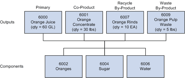

The detail portion of the page minimally contains the end item as the primary item, and you can't delete this. As a result, if you aren't maintaining multiple outputs, you can bypass this page, and the primary item is defined as the only output.
When there is only a primary output for an EBOM, all fields in the row are unavailable for entry or selection. The default settings are:
  • Effectivity dates: Beginning to the end of time
  • Percentage fields: 100 percent
  • Output Qty: 1
If you insert another co-product (not by-product), then the primary's output quantity, allocation percentage, and cost percentage become available. Conversely, if you delete all the co-products from the EBOM, then all the fields on the primary item become unavailable and are set to the defaults.
If you are maintaining a rework BOM, the Output Summary page lists only the reworked item as the end item. You can't define co-products or by-products with rework.
Displays the default value from the BOM Summary page. You can change the quantity in the header portion of this page.
Output Type
Displays an output type for the output item. Output items can't be Floor Stock or Expense items. Waste and Recycle items must be Buy items.
Values are:
  • Co-Product: An item that is produced as part of the manufacturing process, along with the Primary output.
    It shares the cost of the process, and there may be independent demand in PeopleSoft Supply Planning for this item. The system checks whether this item's associated primary is set to itself, the default. It then asks if you want to update the co-product's associated primary to this primary assembly item. For example, when item B is created, its associated primary BOM is set to B. If B is added as a co-product to A, the system asks if it should change B's associated primary to A.
    Examples of co-products are:
    • Orange juice and orange concentrate in drink processing.
    • Chicken drumsticks, chicken breasts, and thighs in meat processing.
  • Primary: The EBOM has only one output.
  • Recycle (by-product): A product that you use as an input to other processes.
    The by-product is incidental to the process and has a relief (negative) cost. Examples of Recycle by-products are orange pulp and rinds.
  • Waste (by-product): A product that needs disposal. The by-product is incidental to the process and has a disposal (positive) cost. Waste by-products could also have no cost associated with them. There is often no independent demand for by-products.

Determines how much of the BOM batch quantity each co-product and primary represents. The system uses this percentage at completion time to determine what percentage of the components should be consumed for each co-product.
Cost %
Determines how to distribute the cost across the co-products. The cost percentage indicates the percentage of the total batch costs to be applied to the primary or co-products.
The Res % and Cost % fields enable you to distribute resource allocation and cost differently for each co-product. For each percentage, the total of all co-product percentages must add up to 100 percent. For the primary item, a value of 100 appears by default as both of these percentages. You can't set the resource and cost percentages to 0.
The following diagram illustrates the impact of the resource allocation percentages within a BOM structure. In this BOM structure, the primary output (6000) equals 60 gallons and co-product (6001) equals 30 pounds. The resource allocation percentages for the primary and co-products don't need to be proportional to the output quantity; you can set them to any percentage as long as the percentages total 100. For this structure, the percentages are set to 60 percent for item 6000 and 40 percent for Item 6001:
Viewing resource allocation percentage on a BOM structure
When completing against the co-products, the system can use the resource allocation percentage to determine what proportion of the batch quantity is consumed. In this case, if you did a partial completion of 15 pounds of 6001, then the proportion of the batch quantity completed is:
(15/30) x (40%) = 20% of the batch
This translates into a consumption of 25 percent of the components, earned labor hours, and so on. The system also uses the resource percentage to show, on BOM inquiries, how much material each output uses when exploding down the levels.
The resource allocation percentage enables the outputs to be in different UOMs, because the percentage specifies the relationship between the co-products, the primary, and the batch quantity.
Use the Engineering BOMs - Header: Supplier Access List page (EG_SS_BOMVND_LST) to access the current list of suppliers who have access to a specific item.
Navigation:
Engineering, and then BOMs and Revisions, and then Maintain EBOMs and Revisions, and then Engineering BOMs, and then Header, and then Supplier Access List
This example illustrates the fields and controls on the Engineering BOMs - Header: Supplier Access List page. You can find definitions for the fields and controls later on this page.
BOM Access by Supplier
Click to access the BOM Access by Supplier page.
Send Email to Suppliers
Click to send email. The email contains two URLs:
  • A URL that sends the recipient to the Engineering BOM Maintenance - Summary page.
  • A URL that sends the recipient to the Bill of Material inquiry page in PeopleSoft Engineering.
Use the Engineering BOMs - Components: Component Details page (EG_COMP_MAINT) to add EBOM component details, attach component text, and manage component documents.
Navigation:
Engineering, and then BOMs and Revisions, and then Maintain EBOMs and Revisions, and then Engineering BOMs, and then Components, and then Component Details
This example illustrates the fields and controls on the Engineering BOMs - Components: Component Details page. You can find definitions for the fields and controls later on this page.
Component
If a component is a revision-controlled assembly, you can't enter a revision for the item. The field isn't accessible, and the system always uses the current revision. This ensures consistency with PeopleSoft Cost Management and PeopleSoft Supply Planning, which use the current assembly revision when exploding assemblies.
When adding a component with item status of Hold or Discontinue, you receive a warning message. Similarly, when updating components with an item status of Hold or Discontinue, you receive a warning message at save time. In both cases, the warning message doesn't prevent you from performing the action.
Pos (position number)
Enter an optional numeric value. This can be, for example, a number that you want to associate with a component on an EBOM drawing or on a list of all components on an EBOM.
If the quantity is per assembly, then when the system determines component requirements in PeopleSoft Supply Planning, it divides the quantity per by the BOM quantity, and then multiplies that result by the demand or order quantity.
If the quantity is per order, the system uses the quantity per regardless of the demand quantity or order size. In other words, a quantity per order (QPO) is a fixed amount, regardless of the order size. For example, if your QPO is 100, then whether your order size is 1 or 10000, the quantity issued to production is 100.
Note: The quantity per assembly may be different for original items and their substitutes. To provide greater flexibility when defining EBOMs, the Quantity field need not follow the quantity precision rules defined for the item. The system issues a warning when you define a decimal quantity value for an item whose quantity precision value is a whole number.
Phantom Item and Serial Control
Display-only check boxes. The values for the component item appear by default from the PeopleSoft Inventory definition. These fields don't pertain to placeholder items.
Yield %
Displays the expected percentage of usable components within a group of components issued to production. If you know that components can be damaged during the issuing or assembly process, account for that loss here. A component yield of 100 percent assumes that the entire quantity of the component is usable and that none of it will be scrapped. A yield of 90 percent assumes that 10 percent of the component issued is unusable or scrapped.
The default value is 100.
The system considers yield in the planning and cost management processes. For planning, it inflates component requirements to account for expected loss during the assembly process. When scheduling the number of components to use in production, the system divides the required quantity by the yield value to derive the scheduled quantity.
For example, suppose that an assembly has a demand of 100 units and the quantity per assembly is 1, with a yield of 90 percent. Then, planning requires 111 components (100/. 90). If the expected 10 percent yield loss occurs, 11 components (111 x .10) are unusable, leaving you the original required 100 components. When calculating the cost of the assembly, the system includes the component yield loss, thereby increasing the cost contribution of the component.
ECO Number
Indicates whether the EBOM was updated by using the Engineering BOM Mass Maintenance by ECO process. The number represents the last ECO number that updated the component on the assembly. If no ECO has run against this component on this assembly, the field is blank.
Subcontract Supply (subcontractor supply)
Select if you are subcontracting all or part of your manufacturing process and the outside supplier supplies the component.
Non-Owned Item
Select if you don't own the component, and the customer supplies the component.
Teardown
Select to designate the component as output from a teardown order. Then, when you create a teardown order based on a BOM (as opposed to the original production ID) for this item, the system copies the BOM components to the teardown output list when it releases production. This enables the system to keep teardown outputs in sync with component changes on the MBOM.
The Teardown check box applies only to teardown orders and has no effect on production or rework orders. However, the teardown check box on the BOM is also copied to the component list for regular production IDs (original production ID). Therefore, if you teardown based on an original production ID, the check box on the original production ID's component list determines the structure of the teardown output list for the teardown production ID.
If you selected Default Teardown BOM Component on the Manufacturing Business Unit Options page, the system designates all components as teardown outputs on all BOMs for all items in this business unit. For all items where this default is in place, the system selects the Teardown check box when adding a component to a BOM. Teardown components can't be subcontractor-supplied, because those components aren't tracked within PeopleSoft Manufacturing.
Note: Only items with a source code of Make or Buy can be teardown components. Planning, expensed, service, and floor stock items can't be teardown components.
Display fields for the component item; values appear by default from the PeopleSoft Inventory definition. These fields don't pertain to placeholder items.
Use the Engineering BOMs - Components: Substitutes page (EG_COMP_SUB) to add substitute components.
Navigation:
Engineering, and then BOMs and Revisions, and then Maintain EBOMs and Revisions, and then Engineering BOMs, and then Components, and then Substitutes
This example illustrates the fields and controls on the Engineering BOMs - Components: Substitutes page. You can find definitions for the fields and controls later on this page.
Component
Copy BU Substitute Items button
Click the Copy BU Substitute Items button to copy business unit level substitutes to the BOM level.
Substitute Items
Sub Item (substitute item)
Select the item that you want to add.
Substitute items must be unique for the item. You can't enter the same item twice as a substitute with different dates. For example, Substitute 1000 with effective dates from 01/01/99 to 02/01/99 and Substitute 1000 with effective dates from 02/01/00 to 08/30/00 couldn't be substitutes for the same item. You need to define a different substitute for the second set of effective dates.
Note: A substitute item cannot be a phantom item. Also, where substitutes exist, you cannot change the item to a phantom.
Note: If no substitute items are defined for an item designated as Discontinued, there may be a shortage of that item if demand exceeds existing quantity on hand. If a substitute is defined for that item, PeopleSoft Supply Planning suggests the substitute when the quantity on hand for the discontinued item runs out.
Std UOM (standard unit of measure)
Displays the standard UOM, which can be different for the substitute and the original component.
