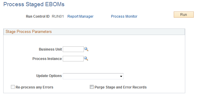

Process Staged EBOMs Page
Use the Process Staged EBOMs page (EN_RUN_BOMSTAGE) to reprocess corrected staged BOMs using the MMC Stage process.
Navigation:
Engineering, and then BOMs and Revisions, and then EBOM Mass Changes, and then Process Staged EBOMs, and then Process Staged EBOMs
This example illustrates the fields and controls on the Process Staged EBOMs page. You can find definitions for the fields and controls later on this page.
Field or Control Description
Update Options
Select from:
  • Validate Only: Validates the data but doesn't load or change BOM tables.
  • Validate and Transfer: Validates the data and loads and changes BOM tables.
Re-process any Errors
If you are processing a large number of BOMs, you can correct the errors in the BOM pages but leave the status as Error. You can then select this check box while running the MMC Stage process, and the system reprocesses transactions with the statuses of New, Reprocess, and Error.
If this check box is deselected, then only transactions with statuses of New and Reprocess are processed. This option is only applicable when Validate Only or Validate and Transfer is selected.
Purge Stage and Error Records
Select this check box to delete the error transactions from the staging table once you have run this process.
If you select Validate and Transfer and you select the Purge Stage and Error Records check box here, then the BOMs are first validated and then transferred to the BOM tables. If any BOMs are invalid, the BOM tables won't be updated, but the BOMs are still deleted from the Stage and Error records.
If you select None and you select the Purge Stage and Error Records check box here, then the BOMs won't be validated or changed. The Stage and Error records are purged. This combination can be used to clean up after you have completed processing BOMs.
Run
Click to run this request. PeopleSoft Process Scheduler runs the MMC Stage process at user-defined intervals.
