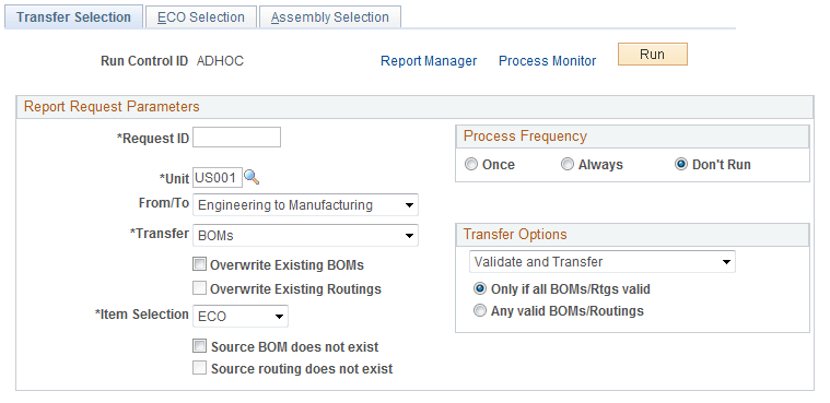

Transfer Selection Page
Use the Transfer Selection page (EG_ENGTRNS_REQ) to define BOM and routing transfer criteria for the Engineering Transfer COBOL SQL process (ENPBTRNS).
Navigation:
Engineering, and then Engineering Changes, and then Engineering Transfers, and then Transfer Selection
This example illustrates the fields and controls on the Transfer Selection page. You can find definitions for the fields and controls later on this page.
Field or Control Description
From/To
Select the direction of the transfer: Engineering to Manufacturing or Manufacturing to Engineering.
Transfer
Select what you want to transfer: BOMs, Routings, or BOMs and Routings.
If you are transferring BOMs and routings by ECOs, then this transfer option is used in conjunction with the BOM and Rtg check boxes on the ECO to determine whether the BOM, routing, or both are transferred.
Transfer Options
Select the transfer option. Values are:
  • Validate and Transfer: This option validates the BOMs and routings and transfers them, depending on whether you select the Only if all BOMs/Rtgs valid (only if all BOMs and routings are valid) and Any valid BOMs/Routings options.
  • Validate Only: This option validates the BOMs and routings, but does not transfer them.
    When you select this option, the Only if all BOMs/Rtgs valid and Any valid BOMs/Routings options are not available for selection.
    You can use Validate Only in conjunction with the Transfer Exceptions pages to see if any problems occurred with the BOMs or routings. You can then make any necessary corrections before you transfer the BOMs and routings.
Note: Validate, in this context, means that all BOMs and routings are valid for transfer (no placeholders, all items are approved in PeopleSoft Inventory, items are not staged date-controlled); it does not mean that the system checks for loops. You should run the BOM Verification process after you have transferred an EBOM to manufacturing.
Select to enable the system to transfer all BOMs and routings, but only if they are all valid; that is, they have no exceptions. When transferring BOMs, if even one BOM has an error, the system will not transfer any BOMs. When transferring routings, if even one routing has an error, the system will not transfer any routings. Finally, if you are transferring both BOMs and routings, if either one BOM or routing has an error, the system will not transfer any BOMs or routings.
Select to enable the system to transfer any valid BOMs and routings; that is, those with errors will not be transferred. In either case, you can view the invalid BOMs and routings by using the Transfer Exceptions pages.
Overwrite Existing BOMs
Select to enable the system to completely replace the existing BOMs.
If you do not select this option and the system finds an existing BOM for an item, then the system will not transfer the BOM, and it will display a message in the Transfer Exceptions pages and treat it as an error.
Overwrite Existing Routings
Select to enable the system to completely replace the existing routings.
If you do not select this option and the system finds an existing routing for an item, then the system will not transfer the routing, and it will display a message in the Transfer Exceptions pages and treat it as an error.
Item Selection
Select one of these options:
  • ECO: Make the transfer by ECO.
    This option activates the fields on the ECO Selection page.
  • Item: Make the transfer by item.
    This option activates the fields on the Assembly Selection page.
Source BOM does not exist
If you are transferring BOMs by ECOs, select if you want an exception to appear on the BOM Exceptions pages. If you do not select this option, the system displays a warning if the source BOM does not exist. By selecting this option, you can prevent the transfer of all BOMs on an ECO if, for example, an item on the ECO is flagged as requiring a BOM change when no BOM exists for the item.
Source routing does not exist
If you are transferring routings by ECOs, select if you want an exception to appear on the Routing Exceptions pages. If you do not select this option, the system displays a warning if the source routing does not exist.
The Source BOM does not exist and Source routing does not exist check boxes apply only to transfers by ECO. If you choose assembly Item as your item selection, then these check boxes are unavailable for selection.

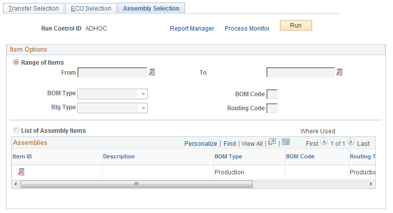

Assembly Selection Page
Use the Assembly Selection page (EG_ENGTRNS_REQ3) to make engineering transfers by assembly item.
Navigation:
Engineering, and then Engineering Changes, and then Engineering Transfers, and then Assembly Selection
This example illustrates the fields and controls on the Assembly Selection page. You can find definitions for the fields and controls later on this page.
Item Options
You can select a range of items, and then select the from and to range of items, as well as the BOM type, BOM code, routing type, and routing code. If you enter a specific value in the BOM Code or Routing Code fields, then you are indicating that those specific codes associated with the range of items are to be transferred. If either of these fields is left blank, then you are indicating that all BOM and routing codes are to be transferred. In either case, all BOM outputs are transferred.
You can also select a list of assembly items, which enables you to select individual items.
Search button
If you select List of Assembly Items and click the Search button, the system displays the Select Assemblies by Items Where Used page.
If you are transferring by list of assembly items, the items should have BOMs or routings associated with them.
For both item options:
  • If you are transferring from PeopleSoft Engineering to PeopleSoft Manufacturing, the system displays EBOMs if you are transferring BOMs and engineering routings (ERTGs), if you are transferring routings.
  • If you are transferring from PeopleSoft Manufacturing to PeopleSoft Engineering, the system displays MBOMs if you are transferring BOMs and manufacturing routings if you are transferring routings.
  • If, however, you are transferring both BOMs and routings, the system displays all approved or pending inventory items that are not staged-dated.
