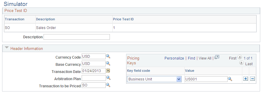

This example illustrates the fields and controls on the Simulator page (1 of 2). You can find definitions for the fields and controls later on this page.

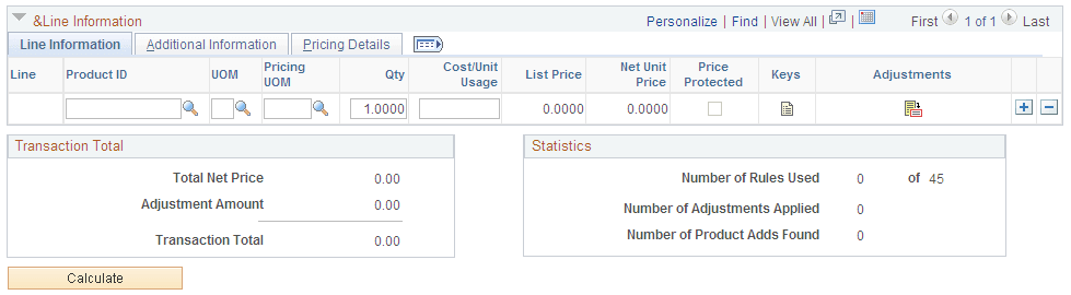

This example illustrates the fields and controls on the Simulator page (2 of 2). You can find definitions for the fields and controls later on this page.
When you use the simulator page, enter the arbitration plan, pricing key values, and product information. You must enter all applicable values for the transaction that you are trying to simulate, otherwise the system does not create the adjustments.
If you do not receive the desired results using the simulator, check that:
  • The price rule assigned to the arbitration plan has a status of Deployed or Ready to Test.
  • The quantity or amount reflect what was specified on the Formulas page of the price rule.
  • The date matches the date break of the formula.
Review the text in the Rule Definition group box on the Conditions page to ensure that it accurately reflects how the conditions for the rule are applied.
Field or Control Description
Description
Enter descriptive text for each of the simulations that you are testing. For example, you might create one for giveaways, price overrides, and so on. You can save a simulation for later use and modify it as you make changes to the price lists, rules, and arbitration plan.
Header Information
Select information to simulate the transaction header and lines.
Currency Code
Enter the currency code of the simulated transaction.
Base Currency
Enter the base currency of the business unit for the simulated transaction.
Transaction Date
Used to determine applicable price formulas. The current date appears by default.
Arbitration Plan
The list of available options is based on the transaction that you select. If you do not select an arbitration plan, the default is used.
Transaction to be Priced
Allows the user to test pricing for those child transactions whose Pricing Data Used is Parent Application on the Price Transaction Code page.
Line Information
Select the Line Info tab.
Select product, ordering unit of measure, pricing unit of measure (if applicable) and quantity to simulate the transaction line detail.
Unit Cost
Enables you to specify the unit cost for the item directly in the simulator.
List Price
View the list or base price for the product.
Net Unit Price
View the price after the adjustments are applied.
Recurring Price and Frequency
Retrieves from the list price that is applied to the line. These fields appear only if you use PeopleSoft Order Capture.
Protected
Select if the product is price protected on the applied price list.
Pricing Keys User Variables
Click the Pricing Keys, User Variables button to edit or view the pricing keys, user dates, and user variables for additional line level transaction information (in addition to the pricing keys on the Simulator page). You can use the page if you want to price the line by different values that the header or entire order. The available values are based on the pricing keys that are established for the transaction.
Adjustments
Click the Adjustments button to view the line-level price adjustments for the simulation. The button is visible only if there are header or line adjustments that match the criteria of the price simulation.
Additional Information Tab
Use to enter the schedule ship and arrival dates for the order as well as to simulate different pricing for KVI, NDP, and regular products.
Pricing Details Tab
Use to view a summary result of the pricing process for the line.
Pricing Quantity
View the quantity in the pricing unit of measure that is used in the pricing calculation.
List Price Origin
View the origin of the list price.
Price List: The price is retrieved from a price list. The price list ID appears next to Price List Origin field.
Price List (base): The price is retrieved in the base currency from a price list. The price list ID appears next to Price List Origin field.
Note: This value is used in PeopleSoft CRM only.
Product Price: The price is retrieved from the Product Price definition.
Product Price (base): The list price is retrieved in the base currency from the Product Price definition.
Price List ID
View the ID for the price list from which the list price is retrieved.
Pricing Base Price
View the base price for the item in the pricing UOM.
Pricing List Price
View the list price for the item in the pricing UOM.
Pricing Net Unit Price
View the net unit price for the item in the pricing UOM.
Payment Terms
View the terms that are retrieved from the price rule that matches the simulation.
Note: This option is used in PeopleSoft SCM installations only.
Margin Violated
This box is checked if the line violates any minimum or maximum margin rules.
Product Adds
Additional lines for the Product Adds sorted and matched by the arbitration plan appear here.
Transaction Total
View the total net price for the simulated transaction including adjustments that apply to the entire order (total order discounts and total order surcharges).
Statistics
View statistical results of the simulation.
Calculate
Calculate
Click to calculate or recalculate the price simulation and view the price adjustments.
