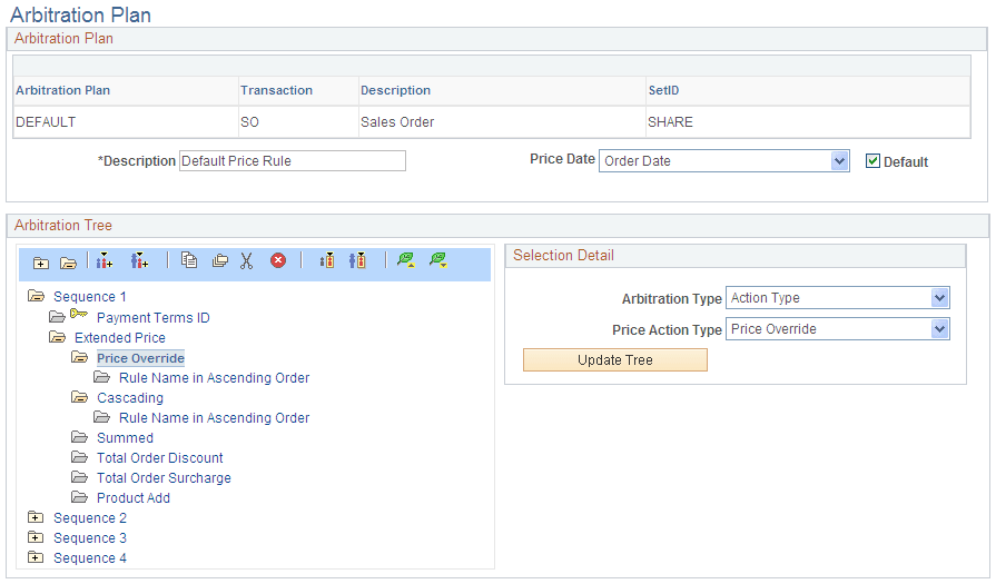

Use the Arbitration Plan page (EOEP_ARB_PLAN) to define how price rules apply to the base or list price when pricing a transaction.
Navigation:
Pricing Configuration, and then Create Pricing Information, and then Create Arbitration Plan
This example illustrates the fields and controls on the Arbitration Plan page. You can find definitions for the fields and controls later on this page.
Field or Control Description
Transaction
Arbitration plans are defined by pricing transaction. The system uses this field to verify and limit the price by keys. In Add mode, select a transaction code. The transaction also determines other valid options, such as the price rules that you can specify in the plan.

Default
Select to establish the default arbitration plan for the transaction. The system uses the default arbitration plan when a customer does not have another associated arbitration plan or does not belong to a customer group that has an associated arbitration plan. You must have one and only one default arbitration plan for each transaction.
Arbitration Tree
Click the toolbar buttons to edit and navigate the arbitration tree.
You can copy, cut, and paste between different arbitration plans or from an existing arbitration plan to a new one by using the toolbar.

Selection Detail
Arbitration Type
Select from these options to add nodes to the arbitration tree to determine how the system applies the price rules. This list of values is determined during implementation on the Price Transaction Code page.
You can set up the arbitration plan to sort matching price rules or to filter out other price rule definitions depending on the arbitration types that you choose at the top level of the tree. Values are:
Action Type: Select corresponding values from the Price Action Type field:

Update Tree
Click this button to refresh the selections to the arbitration tree. Changes are not saved to the arbitration plan.
