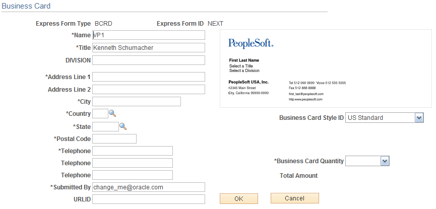

This example illustrates the two sample express forms for requesting business cards in a requisition.
This example illustrates the fields and controls on the Business Card form created in Application Designer.
Adding Express Form to Requisition

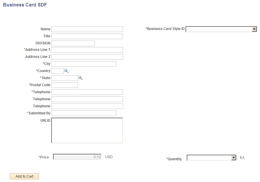

This example illustrates the fields and controls on the Business Card form created using the Supplement Data Framework.
Business Card SDF

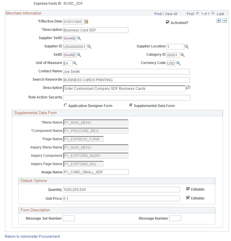

This example illustrates the fields and controls on the Supplemental Data Form. You can find definitions for the fields and controls later on this page.
Use this page to link record definitions for express forms to the PeopleSoft eProcurement system. Define the page, menu, and component for the express form for both editable and inquiry-only versions. You can create different express forms for different uses and effective dates.
Field or Control Description
Menu Name
Pre-populated display-only field.
Component Name
Page Name
Inquiry Menu Name
Inquiry Component
Inquiry Page Name
Image Name
Enter the file name of the image that you want to display on the requisition Search Catalog page for this express form.
More than one express form can use the same page definition but not the same express form type.
Use the inquiry or display-only version of the express forms to enable users and suppliers to view orders without editing them.
You can also enter search terms and a description that helps users find the express form during catalog search.

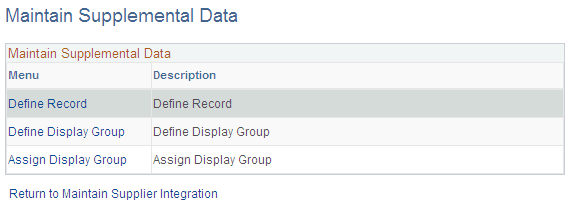

Maintain Supplemental Data
Use the Maintain Supplemental Data page (PV_SDF_OPTIONS) to provide access to the supplemental data framework (SDF) for the user to define supplemental data forms.
Navigation:
eProcurement, and then Administer Procurement, and then Maintain Supplier Integration, and then Maintain Supplemental Data
This example illustrates the fields and controls on the Maintain Supplemental Data.
There are different levels in creating a supplemental data form. You can click the menu given and individually add values to the records and save it.

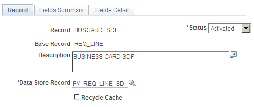

Define Record
Access the Define Record page by clicking on the Define Record menu on the Maintain Supplemental Data page. Define record values, field summary, and field detail for the form.
This example illustrates the fields and controls on the Define Record.
Define Record-Record
When you define a record the Status will be Activated. However you can change it to In Design if the record design is not complete.

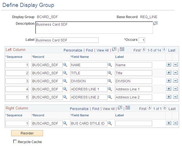

Define Display Group
Access the Define Display Group page by clicking on the Define Display Group menu on the Maintain Supplemental Data page.
This example illustrates the fields and controls on the Define Display Group. You can find definitions for the fields and controls later on this page.
Base Record
User defined while searching for the display group. Select from the given list of base records.
Depending on the Base Record Name selected, the Left column and Right Column data is populated.

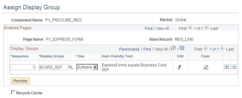

Assign Display Group
Access the Assign Display Group page by clicking on the Assign Display Group menu on Maintain Supplemental Data page.
This example illustrates the fields and controls on the Assign Display Group.
You can edit the sequence numbers for the display groups and reorder it. You can also define conditions for individual fields in the display group based on which the supplemental data will be displayed.
