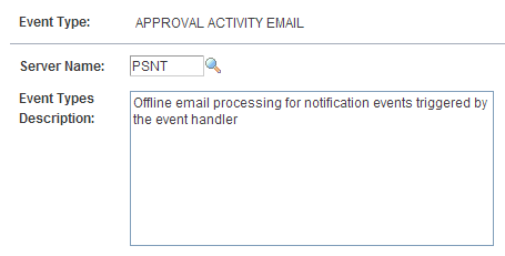

Use the Event Type page (PTAF_NEM_EVENTS) to use this page to create a notification event, specify the conditions for which it should check, and specify the actions that the system should take when the notification conditions are met.
Navigation:
eProcurement, and then Administer Procurement, and then Maintain Workflow, and then Event Types
This example illustrates the fields and controls on the Event Type page. You can find definitions for the fields and controls later on this page.
Event Type page
Field or Control Description
Event Type
Enter an identifier for the event type. The system uses this value as a prompt value when you set up notification events for applications such as PeopleSoft eProcurement.
Server Name
Select a server on which the notification event should run. You can use an existing PeopleSoft Process Scheduler server or an existing application server. By defining an event to run on a specific sever, you can manage the server's workload. You can also set up an event type to run the same notification event on different servers.

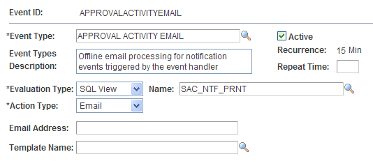

Use the Setup Event page (PTAF_NEM_SETUP) to set up events.
Navigation:
eProcurement, and then Administer Procurement, and then Maintain Workflow, and then Event Definitions
This example illustrates the fields and controls on the Setup Event page. You can find definitions for the fields and controls later on this page.
Setup Event page
Event ID
Displays the unique name that the system uses to identify the current notification event. You enter this value if you are adding an ID.
Event Type
Select the event type. Event types determine which server is going to process the event.
Active
Select to indicate that the current notification is active. If the notification is not active, the system does not run the evaluation condition.
Event Types Description
Displays the user-defined description for this event type.
Recurrence
Displays the interval or frequency that the system uses to poll a notification condition. When a condition is met, the system triggers the action that is defined for the notification.
The system polls for active notifications to be triggered based on the query object, SQL view, or PeopleCode application class that is defined in the notification condition. The polling interval is part of scheduling and works with the repeat interval that is defined for a specific event type.
Repeat Time
Enter a value for the amount of time that lapses between an evaluation time to the next time that the system polls or evaluates the notification condition. For each configured notification, you can enter a repeat interval. This interval must be a multiple of the scheduled polling frequency.
Evaluation Type
Select how you want the system to evaluate the condition for a notification event. Values are:
PeopleCode: With this evaluation type, you write code to return the row set that you want. If PeopleCode is chosen as the action step, then the evaluation rowset is passed into the action step for custom processing.
Query Obj (query object): This a predefined query that you set up using the Query Manager that returns a rowset.
SQL View: You create SQL views using PeopleSoft Application Designer.
Name
Displays the name of the query object or SQL view, depending on which is selected as the evaluation type.
Action Type
Select the type of action that you want the system to take when a notification condition has been met. Values are:
PeopleCode: Select an application package and class to perform a custom notification or action.
Note: If you select PeopleCode, the Package and Class fields appear.
Email: Select to use an email for the notification. When you select this action type, the Email Address and Template Name fields appear.
Package
Select the application package that contains the application class for performing a custom PeopleCode evaluation.
Class
Select an application class that is associated with the application package.
Email Address
Enter an email address for the user that you want to receive this notification. To add multiple email addresses, use commas as delimiters. This field is available only when you select Email in the Action Type field.
Template Name
Select an email template that you want to use with this notification event. The template contains instructional text, message, sender, and message priority.
You define email templates for use with notification by using the Generic Template Definition page. To access the page, select Set Up Financials/Supply Chain, and then Approvals, and then Generic Templates, and then Generic Template Definition.

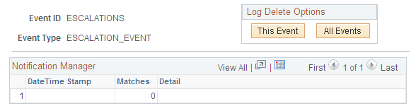

Use the Status page (PTAF_NEM_STATUS) to use this page to determine whether the system successfully ran the notification event and to delete event logs.
Navigation:
eProcurement, and then Administer Procurement, and then Maintain Workflow, and then Event Status
This example illustrates the fields and controls on the Status page. You can find definitions for the fields and controls later on this page.
Status page
This Event
Click to delete all notification event logs for the event ID that you selected.
All Events
Click to delete all notification event logs for all events.
Date Time Stamp
Used in the Status record to track the results of each instance run.
Matches
Displays the number of rows that are returned from a row set.
Detail
Displays detailed status messages for each notification event.
