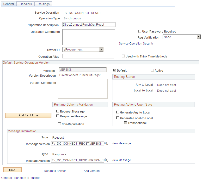

Service Operations - General Page
Use the Service Operations - General page (IB_SERVICE) to define a new service operation or activate an existing service operation.
Navigation:
PeopleTools, and then Integration Broker, and then Integration Setup, and then Service Operations, and then General
This example illustrates the fields and controls on the Service Operations - General page.
A service operation in the PeopleSoft system contains the processing logic for an integration and determines if the integration is to be processed synchronously or asynchronously. A service operation definition contains the following definitions:
  • Message: A message contains the payload of the integration.
  • XML message schema: Message schemas provide the physical description of the data that is being sent, including descriptions of fields, field types, field lengths, and so on.
  • Routing: A routing definition specifies the direction of the integration (inbound or outbound), routing alias names, transformations, and more.
PeopleSoft delivers service operations in PeopleSoft Integration Broker with a default status of Inactive. You must activate each service operation before attempting to send or receive data. To activate a service operation, go to the General tab of the Service Operations component and select the Active check box for the service operation version.
To setup the service operations used for direct connect suppliers, use the information in this table and refer to the setup instructions in PeopleSoft Supply Chain Management Integration: Setting Up Service Operations.
Service Operation Direction and Type Messages Integrates With
PV_DC_CONNECT_REQST
Outbound
Synchronous
PV_DC_CONNECT_REQST and PV_DC_CONNECT_RESP
Punchout to third-party supplier websites
To setup the service operations used for DirectConnect PunchOut via OBN, use the information in this table.
PV_DC_OBN_REQST
Outbound
Synchronous
PV_DC_OBN_REQST.VERSION_1 and PV_DC_OBN_RESP.VERSION_1
Punchout to third-party supplier websites via OBN

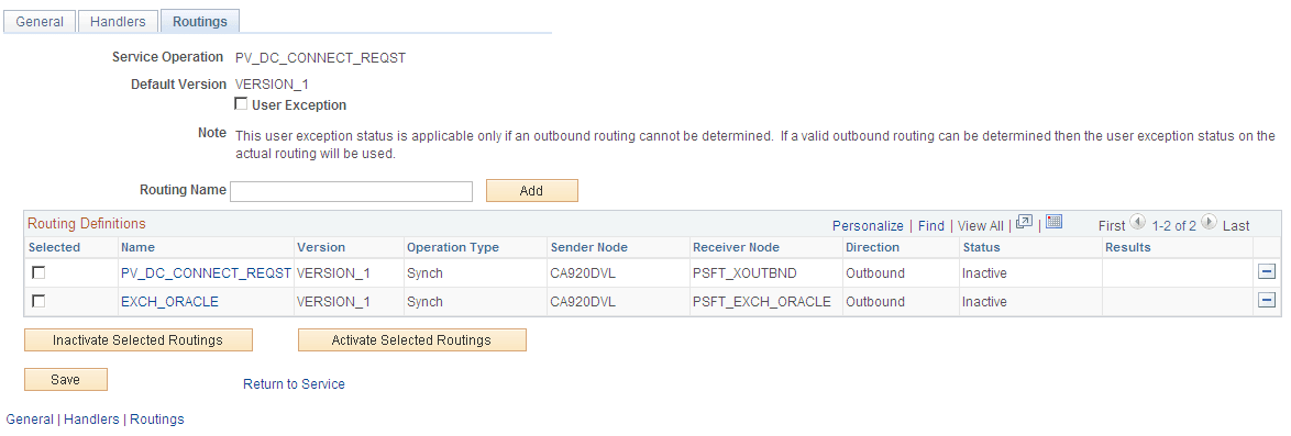

Service Operations - Routings Page
Use the Service Operations - Routings page (IB_SERVICERTNGS) to activate routing definitions used on the service operation.
Navigation:
PeopleTools, and then Integration Broker, and then Integration Setup, and then Service Operations, and then Routings
This example illustrates the fields and controls on the Service Operations - Routings page.
On the Routings tab of the Service Operations component, activate a routing definition for each node that will send or receive data. To activate a routing, select the check box next to the routing definition and click the Activate Selected Routings button.
For DirectConnect PunchOut via OBN, activate the PV_DC_OBN_REQST Routings.

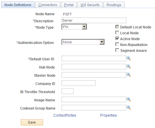

Node Definitions Page
Use the Node Definitions page (IB_NODE) to create a new node or activate an existing node for each linked supplier that you utilize with direct connect.
If a node is configured for direct connect purpose, the node name length must be less than or equal to 18 characters.
Navigation:
  • eProcurement, and then Administer Procurement, and then Maintain Supplier Integration, and then Integration Broker Node Definitions
  • PeopleTools, Integration Broker, Integration Setup, Nodes
This example illustrates the fields and controls on the Node Definitions page. You can find definitions for the fields and controls later on this page.
For the direct connect feature, a node represents the direct connect supplier. Nodes are locations from which the system sends or receives service operations. Nodes can also be an application, a database, or a server. Multiple nodes can share the same local gateway, which might be the only gateway you will need for all integrations. When a node is linked to a particular service operation, the relationship is called a routing.
Set up a node for each direct connect supplier. For those suppliers who support both Punchout and Transparent Punchout, it is required to set up two nodes, one for each, as the supplier URLs are typically different.
The sample data delivered with the system includes:
  • The PSFT_EXCH_ORACLE node. This node is designed for access to the Exchange.oracle.com website using Punchout.
  • The PSFT_TPO_EXCH_ORACLE node. This node is designed for access to the Exchange.oracle.com website using Transparent Punchout.
  • The PSFT_ORACLE_SUPPLIER_NETWORK node. This node is designed for Punchout using OBN.
For the above nodes, you will need to provide the desired exchange environment URL address and then activate the node.
Field or Control Description
Node Type
For direct connect suppliers, select External.
Active Node
Select to activate the node.
Verify the Active Node check box has been selected for the node used in the routings that you activated on your Service Operations-Routings page.
WSIL URL
Enter the desired exchange environment URL address.
See PeopleTools: Integration Broker

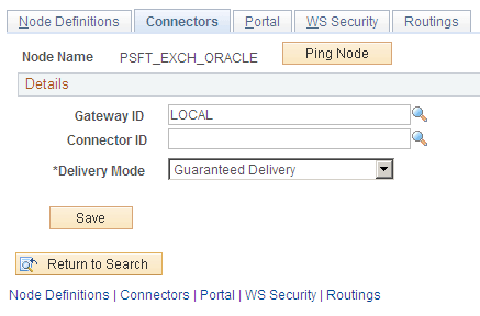

Connectors Page
Use the Connectors page (IB_NODECONN) to set up node connectors that represent the direct connect node.
This page enables you to associate gateways and connectors to a node.
Navigation:
    Click the Connectors tab.
This example illustrates the fields and controls on the Node Connectors page. You can find definitions for the fields and controls later on this page.
Enter these field values that are specific to eProcurement:
Gateway ID
Select the gateway ID that represents your local gateway. PeopleSoft eProcurement requires at least one local gateway through which it can send and receive service operations.
Connector ID
Select HTTPTARGET

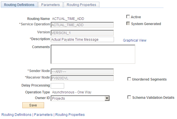

Routing Definitions Page
Use the Routing Definitions page (IB_ROUTINGDEFN) to set up a routing that is associated with the direct connect node.
Navigation:
  • eProcurement, and then Administer Procurement, and then Maintain Supplier Integration, and then Integration Broker Routing Definitions
  • PeopleTools, Integration Broker, Integration Setup, Routings
This example illustrates the fields and controls on the Routing Definitions page. You can find definitions for the fields and controls later on this page.
When a node is linked to a particular service operation, the relationship is called a routing. Each integration requires at least one routing at each PeopleSoft Integration Broker node. One node uses a routing to send a message, and one or more nodes use routings to receive the message. The sending node might apply a routing with different parameters than those applied by the nodes that receive the message, with respect to routing, transmission type, message structure, or message content.
There are four routings that are delivered in the sample data for direct connect:
  • The PV_DC_CONNECT_REQST routing can be altered to connect to a supplier's website.
  • The EXCH_ORACLE routing is designed to connect to the Exchange.oracle.com website using Punchout.
  • The PV_TPO_CONNECT routing is designed to connect to the Exchange.oracle.com website using Transparent Punchout. Use this routing as a model when creating routings for other Transparent Punchout suppliers.
  • PV_DC_OBN_REQST routing is designed to connect to OBN for Punchout.
To connect to another third-party supplier, create and activate a new routing. Create one routing for each node/supplier.
Routing Name
Add a routing name that represents the direct connect supplier. It is suggested that you keep this value the same as the Node Name for the direct connect supplier.
Service Operation
Enter PV_DC_CONNECT_REQST for Punchout suppliers.
Enter PV_TPO_REQST for Transparent Punchout suppliers.
Enter PV_DC_OBN_REQST for Punchout via OBN.
Sender Node
Enter the default local node. The default local node represents who is sending the request.
Receiver Node
Enter the direct connect supplier node.
Object Owner ID field
Select eProcurement.
See PeopleTools: Integration Broker, “Managing Routing Definitions”.

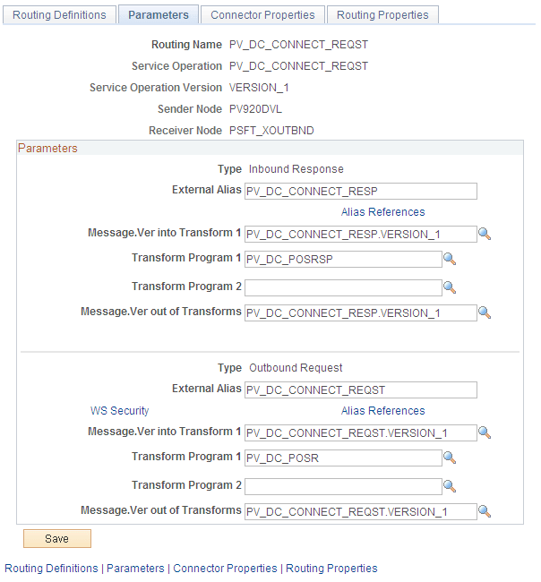

Routings - Parameters Page
Use the Routings - Parameters page (IB_ROUTINGDEFNDOC) to set up routing parameters.
Navigation:
    Click the Parameters tab.
This example illustrates the fields and controls on the Routing Parameters page.
Confirm that the external alias names in the External Alias fields for the routing are correct. When sending or receiving data, the Integration Broker determines which routing to use by referring to the external alias name, not the routing name. For routings already defined in the sample data, the External Alias fields and the transformations have already been defined.
