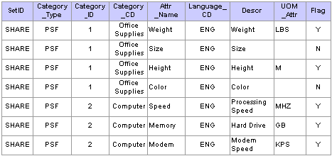

Attribute and Category Tables
The category attributes for item attribute searches are stored in table PV_CAT_ATTR_TBL, which includes these fields:
Field Field Type
SETID
(key field)
CATEGORY_TYPE
(key field)
CATEGORY_CD
(key field)
CATEGORY_ID
(key field)
ATTRNAME
(key field)
LANGUAGE_CD
(key field)
DESCR
(character)
UOM_ATTR
(Assuming that ISO standard UOM is used.)
Note: You might need to add units of measure to the system or convert units of measure.
FLAG
(numeric flag)
This table represents an example of category attributes using the fields defined above for the table PV_CAT_ATTR_TBL:
The image displays example of category attributes.
Example of category attributes in the PV_CAT_ATTR_TBL record.

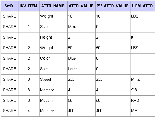

Item attributes for the item attribute search are stored in the PV_ITM_ATTR_TBL table, which includes:
Field Field Type
SETID
(key field
INV_ITEM_ID
(key field
ATTRNAME
(key field
ATTVALUE
(character field)
UOM_ATTR
UOM attributes
PV_ATTRVALUE
numeric field
This table represents an example of item attributes using the fields defined above for the table PV_ITM_ATTR_TBL:
This image displays example of item attributes.
Example of item attributes in the PV_ITM_ATTR_TBL record.

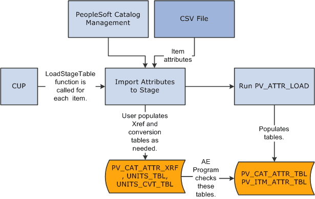

Import, Stage, and Load Attribute Process Flow
This diagram demonstrates the flow for setting up for item attribute searches from loading item attributes from PeopleSoft Catalog Management, a CSV file, or a CUP file into the eProcurement item attributes and catalog attributes tables:
Image displays item attribute search process flow.
Item attribute search process flow from upload source to populating eProcurement tables

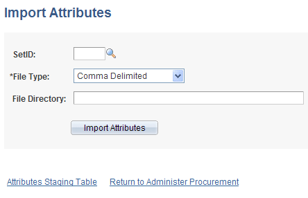

Import Attributes Page
Use the Import Attributes page (PV_ATTR_IMPORT) to import attributes from a flat file.
Access is limited to users with the eProcurement action role SYSTEM_ADMIN.
Navigation:
eProcurement, and then Administer Procurement, and then Maintain Supplier Integration, and then Import Attributes
This example illustrates the fields and controls on the Import Attributes page. You can find definitions for the fields and controls later on this page.
Use this page to stage attributes to eProcurement from a flat file as the first step in integrating the attributes into searches. The most typical data load consists of marketplace items, but you can import attributes from any properly formatted text file.
Field or Control Description
SetID
Select a SetID from the available options. If the flat file has no SetID, select SHARE.
File Type
Select Comma Delimited for text files.
File Directory
Enter the directory where the flat file is located.
Note: The fields included in this directory are listed following these field descriptions.
Import Attributes
Click to import the flat file to PeopleSoft eProcurement.
Attributes Staging Table
Click to access the Attributes Staging Table page, where you can verify the attributes that you have imported.

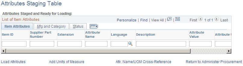

Attributes Staging Table Page
Use the Attributes Staging Table page (PV_ATTR_LOAD_STG) to verify imported attributes.
Navigation:
eProcurement, and then Administer Procurement, and then Maintain Supplier Integration, and then Attributes Staging Table
This example illustrates the fields and controls on the Attributes Staging Table page: Item Attributes tab. You can find definitions for the fields and controls later on this page.
Use the page to view or edit item attributes loaded into the PV_CAT_ATTR_TBL and PV_CAT_ATTR_XRF tables. The system populates the fields on this page with the imported values loaded from the Import Attributes page.
There is no need to edit the imported values on this page unless you are required to cross-reference attributes or UOM names. For large amounts of data, use the Attribute Name Cross Reference page or manually convert the UOMs.
When cross-referencing names or converting units of measure, you may receive a warning message advising that multiple UOMs have been imported for one category. Resolve the conflict by designating a base UOM on the Attribute Name Cross Reference page.
If you are importing UOMs that do not already exist in the system, you receive a warning message. To add new units of measure, use the Units of Measure page.

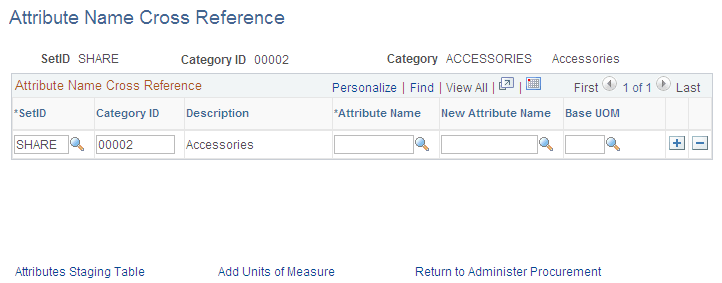

Attribute Name Cross Reference Page
Use the Attribute Name Cross Reference page (PV_CAT_ATTR_XRF) to assign cross-references to attribute names and assign base UOMs for attributes.
Navigation:
eProcurement, and then Administer Procurement, and then Maintain Supplier Integration, and then Attribute Name Cross Reference
This example illustrates the fields and controls on the Attribute Name Cross Reference page. You can find definitions for the fields and controls later on this page.
If you have redundant attribute or UOMs, establish cross-references so that the system can refer to one standard name. Cross-references enable you to establish one name for each attribute and one name for each UOM within a category.
Attribute
Select an attribute for which you want to create a cross reference.
New Attribute Name
Select an attribute name for cross-referencing the selection in the Attribute Name field. If you are creating a UOM cross-reference, leave this field blank.
Base UOM
Select a base UOM for the new attribute name. The name must exist in the UOM table and there must be a conversion for the UOM. You can create a conversion on the Units of Measure page.
For each category that you use, only one UOM is allowed for each attribute. For example, for the attribute Length, you cannot use both inches and feet as the unit; however, you can use inches in one category and feet in another.

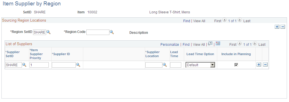

Item Supplier by Region Page
Use the Item Supplier by Region page (ITM_REGION_VNDR) to define regional-based sourcing for items.
Navigation:
eProcurement, and then Administer Procurement, and then Maintain Catalogs, and then Item Supplier by Region
This example illustrates the fields and controls on the Item Supplier by Region page.
Use this page to set up regional sourcing for an item and define priority suppliers by item regions. This enables regional item and supplier security for item browsing and searching. When an item has a supplier-region relationship, the system applies security to filter out suppliers and supplier locations that do not belong to the same region as the ship to region.

  7. Use the Item Supplier by Region page to establish the relationship between the item, region, and supplier.
