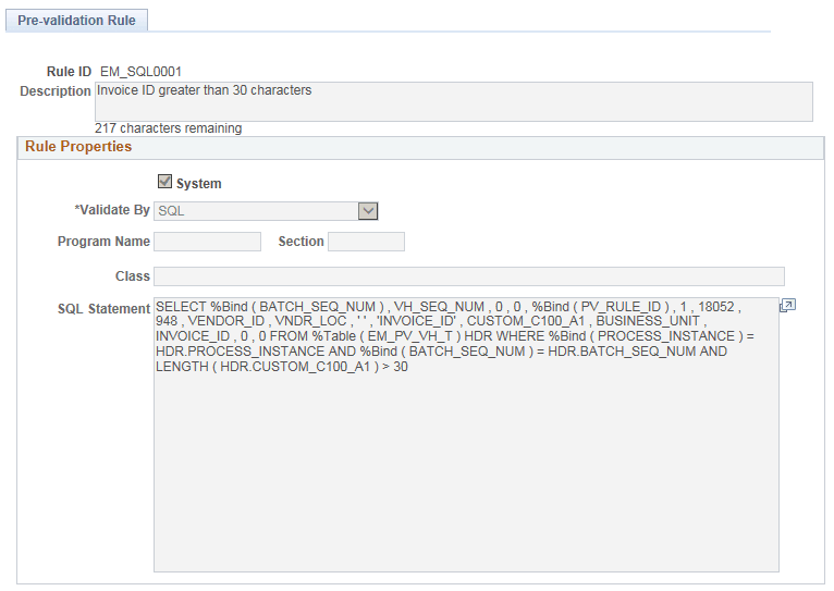

Pre-validation Rule Page
Use the Pre-validation Rule page (EM_PV_RULE) to review the system-delivered pre-validation rules and to create a new pre-validation rule.
Navigation:
eSettlements, and then Administration, and then Pre-validation Rule
This example illustrates the fields and controls on the Pre-validation Rule page. You can find definitions for the fields and controls later on this page.
Field or Control Description
Rule ID
Displays the rule ID.
Description
Displays a description of what the rule does.
Rule Properties
System
If checked, indicates that the rule is system-defined and you cannot edit any field for the rule. If unchecked, the rule is user-defined and you can make changes to specific fields based on the Valid By field option selected.
Validate By
Displays the way in which the invoices are validated:
  • By AE Section: Only the Program name and Section fields are available for edit.
  • By Class: Only the Class field is available for edit.
  • By SQL: Only the SQL Statement field is available for edit.

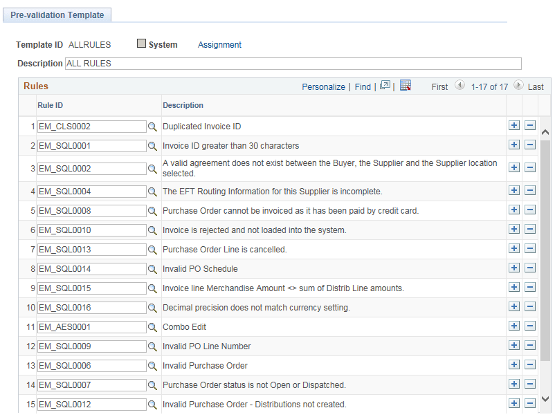

Pre-validation Template Page
Use the Pre-validation Template page (EM_PV_TMPL) to view and update the pre-validation template with rules for Supplier assignment.
Navigation:
eSettlements, and then Administration, and then Pre-validation Template
This example illustrates the fields and controls on the Pre-validation Template page. You can find definitions for the fields and controls later on this page.
When you are creating a pre-validation template, the system populates all the system-defined rules. You can choose to select and remove the rules not required and include new ones.
The system automatically includes the system-defined rule EM_CLS0001 (ExecuteEdits) whenever a Pre-validation template is executed. This rule acts as a prerequisite to the rest of the rules being executed.
Rule ID
Displays the rule ID associated with this template. You can select from a list of rules which include system-defined as well as user-defined ones.
Template ID
Displays the template ID.
System
If checked, means that all rules listed in the template are system-defined and you can only view and not edit them. If unchecked, you can edit the rule rows by selecting desired rule IDs.

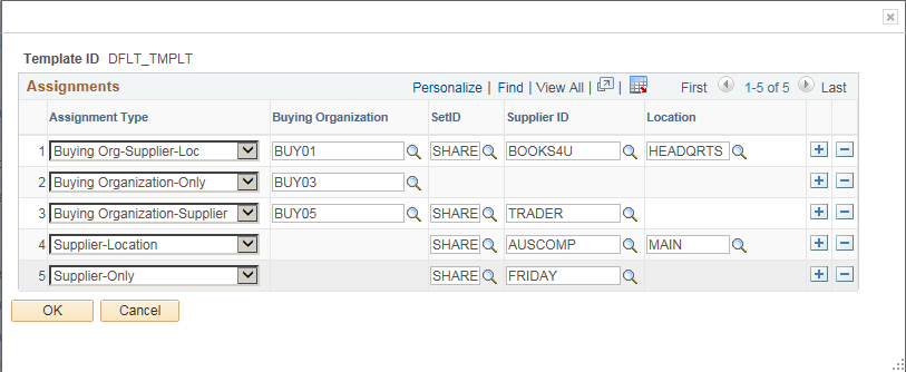

Assignment Page
Use the Assignment page (EM_PV_TMPL_ASSIGN) to assign the pre-validation template and its associated rules to one or more Suppliers or Buying Organizations.
Navigation:
Click the Assignment link on the Pre-validation Template page.
This example illustrates the fields and controls on the Assignment page. You can find definitions for the fields and controls later on this page.
Assignment page
Pre-validation process applies the rules associated with the template that is assigned to a Buying Organization, a Supplier, or a combination of both. The fields on the Assignment page are available to enter values based on the Assignment Type you select while making assignments with the pre-validation template.
For the example shown in the above page, in the first row the Pre-validation template is assigned to the Buying Organization BUY01 for Supplier BOOKS4U at the Location HEADQRTS, and in the next row the template is assigned to only the Buying Organization BUY03 .
Assignment Type
Select the type of assignment for the pre-validation template:
  • Buying Org-Supplier-Loc: Assigns the template to the buying organization and the supplier from a particular location, for the SetID you select.
  • Buying Organization-Only: Assigns the template to the buying organization you select.
  • Buying Organization-Supplier: Assigns the template to the buying organization and the supplier for the SetID you select.
  • Supplier-Location: Assigns the template to the supplier from a particular location, for the SetID you select.
  • Supplier-Only: Assigns the template to the supplier, for the SetID you select.
Note: Only one template can be assigned to a Buying Organization or a Supplier for a given combination of fields associated to the Assignment Type selected.
Example 11-1 Example
The following two tables illustrate how Pre-validation framework applies rules to Suppliers and Buying Organizations through template assignments.
Scenario 1
Introduce Template Assignment Type Assign to Buying Organization Assign to Supplier Location How rules apply
T1
Buying Organization only
Buying Organization: BUY01
Rules defined in T1 apply to all the cxml files uploaded by any Supplier for the Buying Organization BUY01.
T2
Supplier Only
Supplier: BOOKS4U
Rules defined in T2 apply to cxml files uploaded by the Supplier BOOKS4U for the Buying Organization BUY01. All other Suppliers use T1.
T3
Supplier-Location
Supplier: BOOKS4U
Location: L1
Rules defined in T3 apply to cxml files uploaded by the supplier BOOKS4U from the location L1 for buying organization BUY01. All other suppliers use T1.
Scenario 2:
T4
Supplier Only
Supplier: FRIDAY
Rules defined in T4 apply to cxml files uploaded by the Supplier FRIDAY for all Buying Organizations.
T5
Supplier-Location
Supplier: FRIDAY
Location: L1
Rules defined in T5 apply to cxml files uploaded by the Supplier FRIDAY from the Location L1 for all Buying Organizations.
T6
BUY02
Supplier: FRIDAY
Rules defined in T6 apply to cxml files uploaded by the supplier FRIDAY for the Buying Organization BUY02 alone. All other Buying Organizations use T5.
T7
BUY02
Supplier: FRIDAY
Location: L1
Rules defined in T7 apply to cxml files uploaded by the supplier FRIDAY from Location L1 for the Buying Organization BUY02 alone. All other Buying Organizations use T5.
Suppose that the Supplier FROMAGE uploads a cxml file for the Buying Organization BUY03. Since neither of them have associations with any pre-validation template, the Pre-validation feature is not applied; the system uses EM_VOUCHER_IN to validate invoice data.

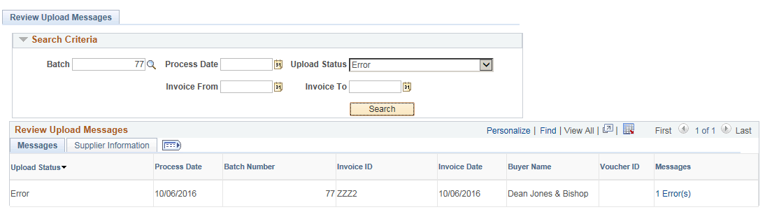

Review Upload Messages Page
Use the Review Upload Message page (EM_PV_QUERY) to review the upload messages resulting from the Pre-validation process.
Navigation:
eSettlements, and then Invoices, and then Review Upload Messages
eSettlements, and then Supplier Information, and then Load and Review Invoices. Click the Message link for a Supplier.
This example illustrates the fields and controls on the Review Upload Message page. You can find definitions for the fields and controls later on this page.
Search the upload messages by batch, process date, upload status, or by invoice dates. To view all messages leave all fields blank and click Search.
Upload Status
Displays whether the status of the invoice upload is success or in error.
Messages
Displays the number of error messages with a link. Click the link to open the error message in a new page and review the details of the error – rule ID, line, distribution, field, value, and an error message about resolving the error.
