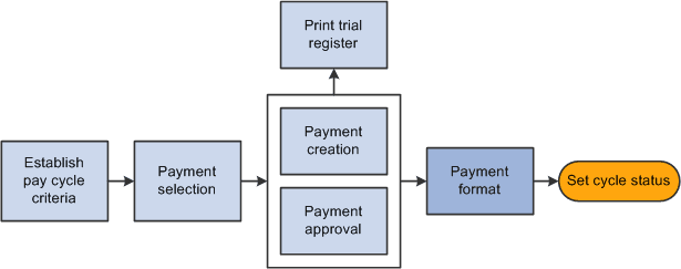

The following diagram illustrates fully automated payment processing.
Fully automated payment processingpaymentsprocessing alternatives payment processing fully automated
Subscription during buyer registration indicates payments are preapproved. No further approvals are required as part of the pay cycle. Pay cycles are created and run by the host administrator. Buyers receive email notification when the payment file is generated. The host administrator uses the Create Pay Cycle component (PYCYCL_DEFN) and the Pay Cycle Manager page in PeopleSoft eSettlements to process the pay cycle.

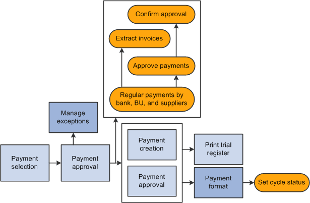

The following diagram illustrates semi-controlled payment processing.
Semi-controlled payment processing
The payments can be approved and created using either the PeopleSoft eSettlements Approve Payments component (EM_PYCYCL_APPROVE) or the PeopleSoft Payables Pay Cycle Approval page—both are on the portal navigation for PeopleSoft eSettlements. The buyer should use the PeopleSoft eSettlements pages to approve the payments.
