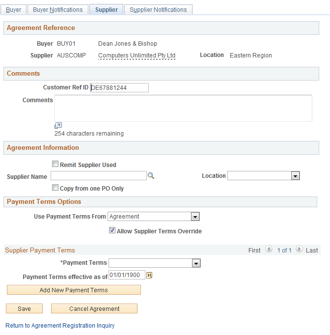

Review Agreement Details - Supplier Page
Use the Review Agreement Details - Supplier page (EM_AGREEMENT_SELLE) to review buyer terms and accept agreement.
Navigation:
Click a Buyer link on the Review Agreement Details - Inquiry page.
Select the Supplier tab from the Review Agreement Details - Buyer page.
This example illustrates the fields and controls on the Review Agreement Details - Supplier page. You can find definitions for the fields and controls later on this page.
Comments
Field or Control Description
Customer Ref ID (customer reference ID) and Comments
Enter a reference ID and any comments that are relevant to this buyer or agreement.
Agreement Information
Remit Supplier Used
Select this check box to use an alternate remit to supplier, to which the system transmits invoices for this supplier.
Supplier Name and Location
Enter the remit to supplier name and location.
Copy from one PO Only
If the check box is selected, the system will check if the supplier has selected more than one PO to be copied. If there are more than one POs selected, an error message is displayed to indicate that the user is allowed to copy from one PO only.
Payment Terms Options
Use Payment Terms From
Select the option to define which payment terms are used as the default on the invoice.
The available options are:
  • Agreement: Select this option to use the payment term that is on the Buyer/Supplier agreement.
  • Default from higher level: Select this option to use the payment term from the higher level.
  • Purchase Order: Select this option to use the payment terms value from the copied PO.
Allow Supplier Terms Override
The check box will be selected as default. If selected, the Supplier can modify the payment terms on the Agreement sent from the Buyer.  If the option is not selected (Supplier cannot override the payment terms on the Buyer/Supplier agreement), then the Payment Terms is displayed to the supplier with no drop down.
Supplier Payment Terms
If multiple terms exist, you cannot view them all at once. Use the controls in the Supplier Payment Terms group box header to scroll through them.
In the Business Service Provider model, because the system generates email when a user inserts a new effective-dated row or deletes the current row, if you need to change the payment terms on an agreement, you must add a new row with the date that the new terms are to become effective.
Payment Terms
Select terms, such as Due Now, Net 30, or EOM.
Payment Terms effective as of
Enter a date on which the terms become effective.
Add New Payment Terms
Click this button to specify new payment terms and a new date.
Note: Payment terms can only be changed by the supplier in the Business Service Provider model, which initiates another agreement cycle requiring the agreement to be reaccepted by both the buyer and supplier. However, in the Buyer Direct model, another agreement cycle is not initiated with a change in payment terms.
Accept Agreement
Click this button to accept the buyer's terms and trigger email notification to the buyer administrator, enabling the buyer to finalize the agreement.
This button appears here only after the buyer clicks the Accept Agreement button on the Review Agreement Details - Buyer page.
Note: When the supplier clicks this button, the system sends email notification only to the buyer users who initiated the agreement.
Cancel Agreement
Click this button to cancel the agreement and prevent further invoice creation or processing to occur once an agreement is finalized. Clicking this button does not effect invoices that are already in the system, but prevents the creation of new invoices.

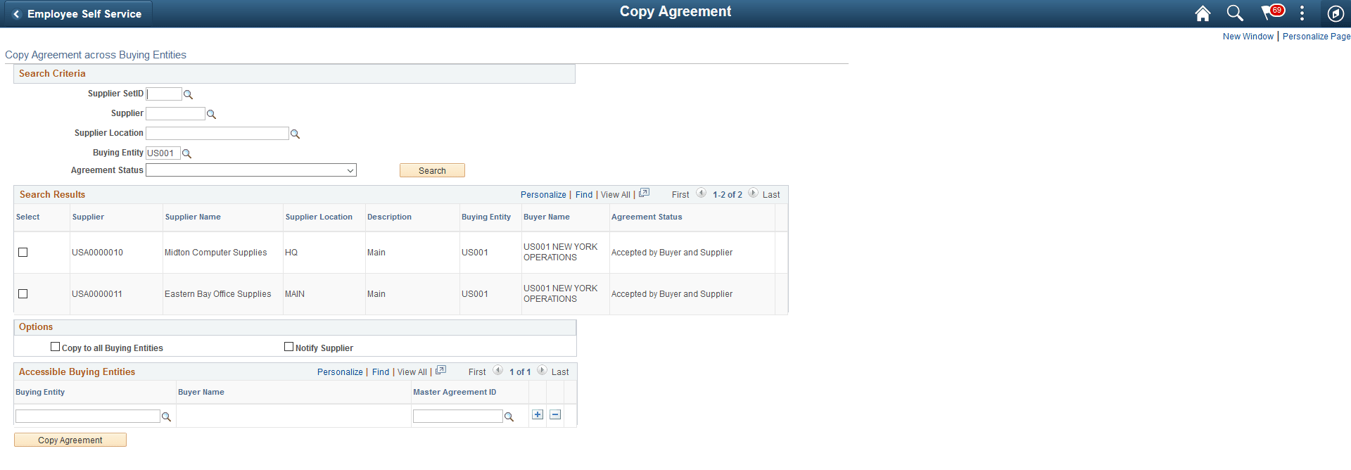

Copy Agreements Page
Use the Copy agreements page (EM_AGREE_CP_PG) to copy existing agreements across different set of Buyers.
Navigation:
eSettlements, and then Buyer Information, and then Copy Agreement
This example illustrates the fields and controls on the Copy agreements page. You can find definitions for the fields and controls later on this page.
Copy Agreements page
Search Criteria
Search
Select from the options supplier SetID, supplier, supplier location, buying entity, and from the following agreement statuses:
  • Accepted by Buyer and Supplier
  • Accepted by Supplier
  • Created by Buyer
  • Ready for Review by Supplier
Click the Search button to return results of agreements based on the selected search criteria. You can leave all the fields blank to list all agreements.
Options
Copy to All Buying Entities
Select to copy the selected agreement to all buying entities.
Notify Supplier
Select to send an email notification to the selected supplier for every agreement created.
Accessible Buying Entities
Buying Entity
Select a buyer.
Master Agreement ID
Select a Master Agreement from a list of Master Agreements for a Buying Entity.
Note: This field is available only if a user has implemented Master Agreements.
Copy Agreement
Click to copy the agreement to all buying entities.
