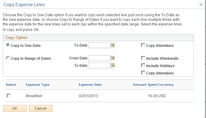

Copy Expense Lines Page
Use the Copy Expense Lines page (TE_COPY_LINE_SEC) to copy selected expense lines on the same expense report.
Navigation:
  • Employee Self-Service, and then Travel and Expense Center, and then Expense Report, and then Create/Modify
  • Travel and Expenses, and then Travel and Expense Center, and then Expense Report, and then Create/Modify
  • From the Create Expense Report page, you must enter at least one line. From the Actions drop down list box, select Copy Expense Lines.
This example illustrates the fields and controls on the Copy Expense Lines page. You can find definitions for the fields and controls later on this page.
Field or Control Description
Copy to One Date
Select to copy each selected line only once using the To Date as the new expense date.
Copy Attendees
Select to copy the attendee information to the new expense lines. If not selected, PeopleSoft Expenses populates each line that it creates with only the employee's name in the attendees list. PeopleSoft Expenses displays the Copy Attendees check box only if any of the selected expense types requires attendees.
Copy to Range of Dates
Select to copy each line multiple times with the expense date for the new lines set to each day within the specified date range.
From Date and To Date
Enter a date or a date range for PeopleSoft Expenses to calculate the number of rows to create. If you are copying a per diem expense type, you cannot enter a date prior to the copied per diem line.
Note: You cannot enter future dates.
End Time
Enter the ending time that PeopleSoft Expenses uses to calculate the per diem on the last line that it copies. For all other lines that the system creates within your date range, it enters a start time of 12:00 a.m. and end time of 11:59 p.m.
Note: PeopleSoft Expenses displays this field only for per diem expense types that are set for hours.
Include Weekends and Include Holidays
Select to copy the expense type for the entire date range.
If you do not select to include weekends, PeopleSoft Expenses checks the day of the week and does not copy expense lines for Saturdays or Sundays.
If you do not select to include holidays, PeopleSoft Expenses checks the holiday calendar for the employee's business unit. PeopleSoft Expenses does not copy expense lines for days that the calendar designates as holidays.

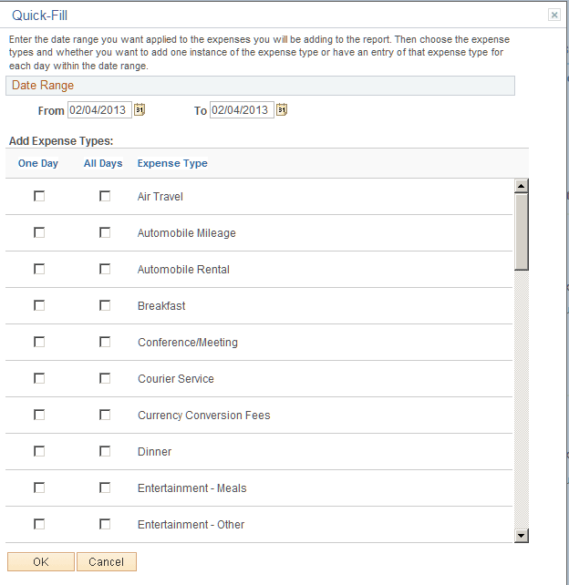

Quick Fill Page
Use the Quick - Fill page (TE_ADD_MULT_EXP) to select expense types that you want to add to expense reports. You can also determine whether you want to add one instance of the expense type or have an entry of that expense type for each day within a date range.
Navigation:
Select the Quick - Fill link on the Create Expense Report page.
This example illustrates the fields and controls on the Quick - Fill page. You can find definitions for the fields and controls later on this page.
Quick Fill window
From and To
Select a date range for PeopleSoft Expenses to use to add expense lines to the expense report. This range is used to generate a line for the expense type for each day if the All Days check box is selected.
One Day and All Days
Select to specify whether to add one instance of the expense type to the expense report or whether to add one for each day in the date range for that particular expense type.
OK
Click to return to the expense report, where the selected expense items appear.
Cancel
Click to return to the Create Expense Report page without adding expense lines. If you selected any expense items, PeopleSoft Expenses does not add them to the expense report.
