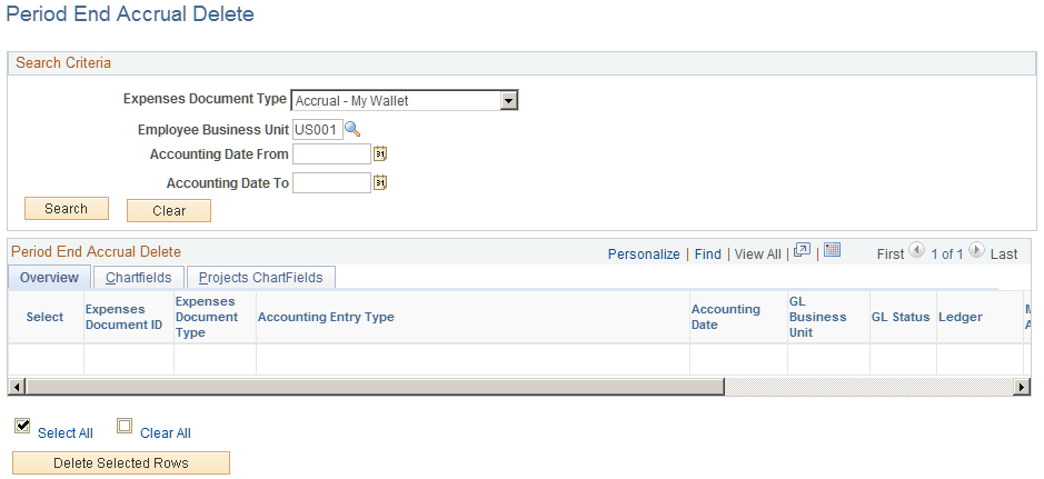

Use the Period End Accrual Delete page (PE_ACCRL_DELETE) to delete accruals for PeopleSoft Expenses.

This example illustrates the fields and controls on the Period End Accrual Delete page.

Field or Control Description
Expense Document Type
Select the type of document that you want to delete. Options include Accrual - Expense Report and Accrual - My Wallet.
Search
Click to perform a search of all expense document types in the Expenses accounting line table that have been created by the Period End Accrual process and that have been budget checked.
The transactions that are selected are only the accrual side of the transaction. The associated reversal transactions are listed in the grid. Any action taken on the accrual entry is also taken on the accrual reversal entry and the expense entries.
Select
Select to indicate that you want to delete the transaction. The associated reversal transaction is deleted when you click the Delete Selected Rows button.
The check box is disabled if the accounting transaction has been journal generated. The check box is not displayed for reversal transactions.
If the transaction has been budget checked, the transaction is updated to zero out the amount and set the budget checking status to not budget checked.
Budget Header Status
Displays the header status of expense sheet lines that have been processed through the Period End Accrual process and have been budget checked. These values can appear in this column:
  • N: Indicates that the transaction is not budget checked.
  • V: Indicates that the transaction is successfully budget checked.
  • E: Indicates that the transaction is budget checked but it has an error.
This column is not displayed for My Wallet transactions because commitment control is not related to this transaction.
This column is not displayed if commitment control is not enabled.
Click to delete the transactions that are selected in the grid. The associated reversal row is deleted as well.
If budget checking has been run on any transaction selected for deletion, you receive a message that the budget checked transactions must be budget checked again to reverse any activity. If the rows have been budget checked, they are updated so that they are selected by the budget processor the next time it is run.
The distribution status is updated to Ignore for all selected lines so that they are not selected by the Journal Generator process.
