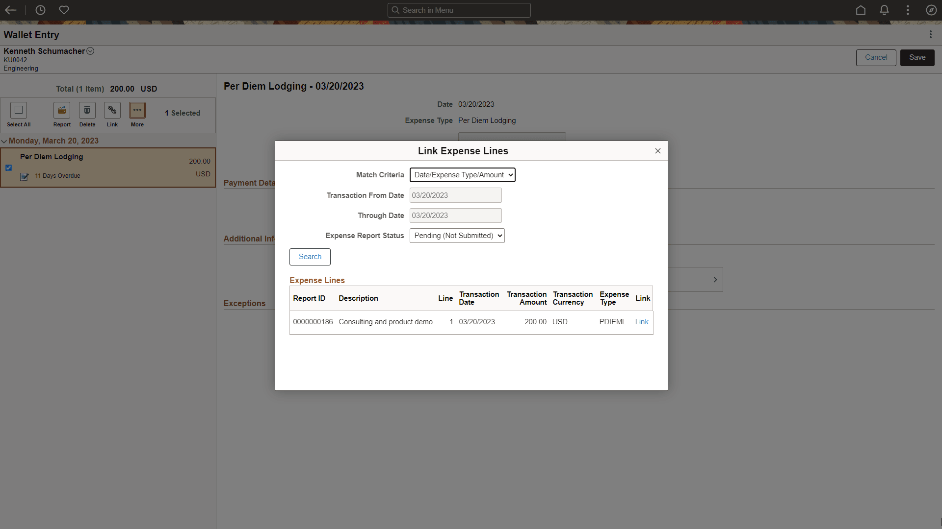

Use the Link Expense Lines page (EX_TRANS_LINK_SCF) to associate or link a wallet entry with an existing expense report line.
Navigation:
From the Wallet Entry Page, select the More button. Select a wallet entry. Select the Link (Link) icon.
This example illustrates the fields and controls on the Link Expense Lines page.
Link Expense Lines
Field or Control Description
Match Criteria
Select the criteria fields you want to use for your search. Options are:
  • Date/Amount
  • Date/Expense Type
  • Date/Expense Type/Amount
  • Expense Type/Amount
Transaction From Date and Through Date
Enter the wallet transaction from and through dates to refine your search results.
Note: The Transaction From Date and Through Date fields are only available when the Expense Type/Amount is selected in the Match Criteria field. The other three Match Criteria options contain date as part of the match criteria, so the transaction date, from the selected wallet transaction, is automatically populated into these fields, and cannot be changed. When this occurs, the date is pulled from the Wallet entry (TRANS_DT) that the user is trying to link.
Expense Report Status
Select a status to refine your search results. Options are:
  • Pending (Not Submitted)
  • Submitted
Expense Lines Section
This section of the page displays the results of your search.
Select Link to associate the wallet entry to the selected expense report line. After you associate a wallet entry with an expense report line, the wallet entry is removed from the Wallet Entry page.
