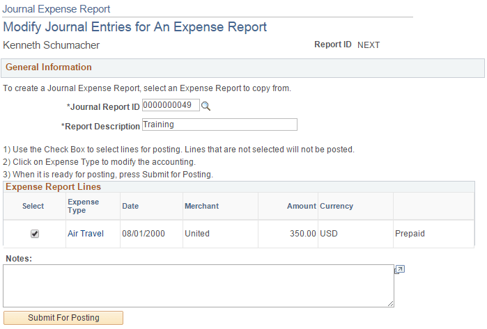

Modify Journal Entries for An Expense Report Page
Use the Modify Journal Entries for An Expense Report page (EX_SHEET_HDR_JRNL) to create journal expense reports to correct errors and make adjustments to expense report payments to synchronize the expense system and general ledger.
Navigation:
Travel and Expenses, and then Manage Accounting, and then View/Adjust Accounting Entries, and then Adjust Paid Expenses
This example illustrates the fields and controls on the Modify Journal Entries for An Expense Report page.
Processing Journal Expense Reports
When you save a journal expense report, it is ready to post to the general ledger. The system saves only modified expense lines. It does not pass journal expense reports to the accounts payable system because they do not have monetary amounts. Instead, you can select the Post Liabilities function on the Expense Processes page to process the journal expense reports.
When you process the journal expense reports, the system rolls back the original accounting entries and posts the new entries. This corrects the general ledger to reflect the same entries that exist in the expense system. If you use PeopleSoft Commitment Control, you must run budget checking to reverse out the entries in the Commitment Control ledgers.
General Information
Field or Control Description
Journal Report ID
Enter the original expense report ID that requires an adjustment. Available report IDs are those that are associated with employee IDs for whom the auditor has entry authority.
Report Description
Enter a description for the journal expense report.
Expense Report Lines
Select
Select lines to post. Lines not selected will not post.
Expense Type
When you select an expense report ID, the system displays all line items in that report. To view or correct accounting information for a line item, click the link to access the Journal Expense Report - Accounting Detail page and modify the accounting for the expense.
Date
Displays the date of the original transaction.
Comments
Enter comments about this journal expense report.
Budget Status
If you use PeopleSoft Commitment Control and budget checking for expense reports is active, PeopleSoft Expenses displays the budget status for the expense report.
Budget Options
Click the Budget Check Options link to access the Commitment Control page to budget check the travel expense or view comments about the budget check. This link is available only if you use PeopleSoft Commitment Control and budget checking for expense reports is active.
Note: If you make any changes to distributions or amounts, you must budget check the expense report again to reflect the changes in the commitment control ledgers.
Submit For Posting
Submit the journal expense report for processing.
